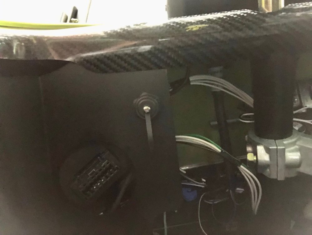

JohnCh Posted July 31, 2023 Author Posted July 31, 2023 In preparation for the dyno, I took care of some things I previously punted for various reasons. The big one was soldering in the pull-up resistor for the oil temperature sensor so the AiM could read it correctly. That necessitated removing the scuttle, which is very easy to do after the conversion from rivets to rivnuts with M4 fasteners -- highly recommended mod. The AiM now reads about 9 degrees cool at room temperature. Once I run the car again, I'll check accuracy at running temps and adjust the calibration accordingly. I had also planned to install the remote button interface for the AiM which provides a dedicated button to reset the trip odometer. However, when attempting to install it, I discovered my mount for the AiM makes that a difficult process. When doing the original design, I had incorrectly assumed this was a push in fitting. It turns out it's screw in. With insufficient finger space, I was faced with removing the rear mount, or punting again and doing this as a winter project which includes printing a slightly redesigned rear mount. I've gone with option two. That means rather than resetting the trip odometer with a single push of the button on the steering wheel, I need to go through a couple of menus on the display. Not a huge inconvenience. I also ran power to the 12V outlet attached to the glove box and confirmed the on/off switch is doing its job to stop parasitic drain from the USB adapter. The knee trim panels finally went in, with the driver's side first drilled to mount the data port for the AiM. The Element fire extinguisher was installed above the passenger footwell. Easy to reach, but not in a location that screams "steal me!" Next was adjusting the throttle pedal stop and putting silicone on the throttle cable ferule where it mounts in the top of the accelerator pedal. A close look revealed that at full throttle, the rough, sharp edge of the cable cutout pushes into the cable. That seems like an eventual break point. A few minutes with a small file rounded over the edge. I also attached the cover I printed to plug the hole for the cylinder head temperature sensor Ford uses in most applications of the Duratec. Without this plug, water can fill the void that leads to the top of the spark plug ports for #2 and #3. The 420 uses a valve cover that doesn't have this opening. I've never seen it on a US car so perhaps it's a European fitment. Does anyone know the source, or if Caterham has these modified? Finally, I did some general clean up: removed last vestiges of blue tape, cut off the ends of any zip ties I missed earlier and sealed a couple of unneeded holes in the firewall with rubber grommets. Next step is the dyno on the 14th-16th, followed by an alignment, and (hopefully) registration. If things go well, my 420R garage sale is just around the corner. -John
