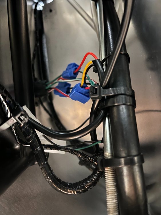

For enhanced safety I decided to add a high mount center brake light and a whip with an amber LED light on top.  The latter so I am not forgotten and driven over by some jacked up RAM 150000 stopped behind me at a traffic light.
The center mount LED light I found on Amazon has both brake and running lights LEDs so it uses two positive feeds and a ground.
I used an 18 gauge 3-wire sleeved cord for the splicing and ran it up the RH roll bar brace.
I found the easiest place to splice into the rear lights loom is in the right rear corner inboard of the wheel well.  This loom also carries a ground wire.
Identifying the wires is quite easy when disassembling the connector inboard and outboard of the wheel well wall (which you need to do anyway to access the wires for splicing) and checking voltage across the pins.
My wife agreed to climb in and press on the brake pedal for the brake wire...
Below: spliced wiring tucked in place (view up from underneath).  The new 3-wire sleeved cord is in view right below the splices.
