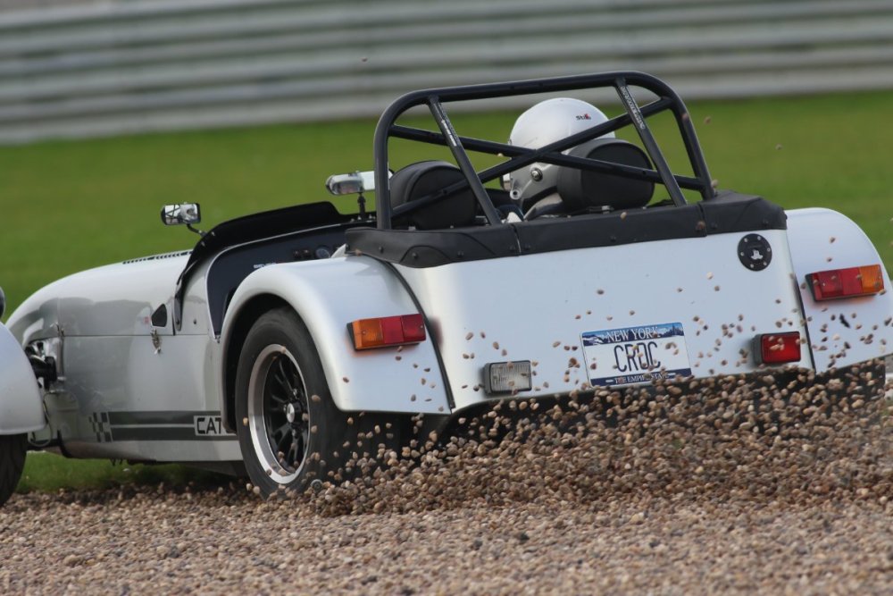

Croc Posted January 15, 2023 Share Posted January 15, 2023 23 hours ago, Saudio said: Can anyone here speak to how loud this car is inside the cockpit, and would hearing protection normally be needed? I'm curious if I should spec my car with the rear exhaust option. I like a present engine sound but my friend has a Cobra and I can't stand to be in it without ear plugs. Hearing protection is always recommended - road or track. You have 3 sources of noise - intake, exhaust and wind. You are thinking of an 420 SV so that would not require the cut out for roller barrels or sausage filter if you included that now or in the future. The standard intake is a plenum with a mesh hole. Helps to muffle the intake a little. Exhaust noise can be moderated. Side or rear exhaust options exist with single muffler. The cat converter does help quieten exhaust noise. But you also have the track day muffler options which is two mufflers. Gets you down to 90db. I have it on my 420R. There is the usual side exhaust silencer but then a second silencer is added at the back as shown in the photo below. This two silencer configuration is available for order in the USA but not well known. Worst noise is clearly wind. Not much you can do about that other than ear plugs or some form of ear protection. Road or track, I recommend you use it. 23 hours ago, Saudio said: I expect my car to be mostly road use with occasional track days. Is the electrical cut off switch really important? How about the ventilated front brakes? Excellent - someone who wants to use the car as it was designed to be - on the track! A cut off switch is nice if you crash but lets think positive. Most of my cut off switches end up protecting the battery from parasitic drain. All of my Caterhams have had some form of parasitic electrical drain that eventually flattens the battery. I suspect it is the ECU. The cut off switch is useful for stopping that. Its also an extra form of theft deterrent. Don't try to eliminate the ignition key without taking out the full immobilizer system. Ventilated front brakes are nice but not essential. Lots of people run on track with the standard brakes. Most people never learn how late and how little you need to brake a Caterham. If you think you might add some power a few years from now then specify the upgrade now - it will be much cheaper than adding them later. 23 hours ago, Saudio said: How about the shift indicator? I'm inclined to think that might be handy. Yes - if you are on a track and firing out of a corner in second going to 7000rpm, you are NOT looking at a gauge but you will see red flashing lights in your peripheral vision from the shift lights. 23 hours ago, Saudio said: 13" or 15" wheels? I've read the 13s are lighter and better for the track but the 15s might be a more compliant ride for road use. I think the 15s look better in pics. Always 13 inch wheels. Lower unsprung weight. Less rotational mass. Better ride. Better telegraphing of breakaway. You have to drive 15s and 13s back to back to believe the difference in feel but it is substantial. 23 hours ago, Saudio said: Anything you really regret not having on you Caterham? Or anything that you think is useless? I think 420R is standard dry sump but if not, then specify it since you want to track your car. Also gives you more ground clearance under the sump. Always wire your indicators up to a beeper. You will forget to turn them off....its a rite of passage thing. High level brake light for visibility is essential. If you are going to track your car then install the captive nut brackets for the windscreen to make the changeover from windscreen to aeroscreen a quick easy exercise for one person. Definitely you want a windscreen for road protection but an aeroscreen for track. If you are going to track then specify the racing shell/Tillet style seats with the 6 point Schroth harnesses. Hold you in place so you can concentrate on driving. Useless? Always the driver.... 2 Link to comment Share on other sites More sharing options...
