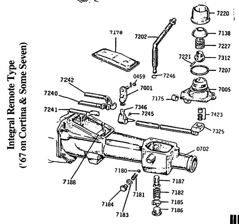

joe7 Posted October 2, 2023 Share Posted October 2, 2023 What you have is known as an Integral remote. These were available 1967 on and used mainly in Cortina and some 7s. The Triumph is a bolt on extension with a Lotus designed aluminum wedge shaped adapter. The Cortina extension is a direct bolt on which this one is not. If you look into the shifter through the opening you should see a single shift rail. Maybe all you need is the shift lever and related components, retaining cap, spring, shift ball, etc. Some of these parts are the same as the Cortina remote but not the shift lever. Maybe someone can post a picture of these components from the Dave Bean Catalogue. Link to comment Share on other sites More sharing options...
IamScotticus Posted October 3, 2023 Share Posted October 3, 2023 (edited) I hope this helps. Its a really old version of the catalog. They're probably still using it. The PDF attachment is all six pages of the catalog section. DaveBeanRev0297.pdf Edited October 3, 2023 by IamScotticus 1 Link to comment Share on other sites More sharing options...

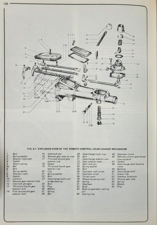

IamScotticus Posted October 3, 2023 Share Posted October 3, 2023 (edited) From Haynes # 139 That doesn't look too good. I will work on it Edited October 3, 2023 by IamScotticus Link to comment Share on other sites More sharing options...
Joe Petty Posted October 4, 2023 Share Posted October 4, 2023 Yes, it is referred to as the "Internal Remote" and is very hard to find. When I got my 7 in 2016, mine had been replaced by a modified Cortina (?) shift rod with the flat sided ball. When I got it all installed I discovered that I could only select 3rd and 4th so I set about looking at some of the parts drawings to figure out what was wrong. You may notice that the correct shifter has a round ball and that fits a "plastic" sleeve and spring that are in the remote shaft (7325). As mentioned, all this stuff is very rare! My solution was to measure very carefully, then grind and bend a piece of 1/2" round steel stock and build my own shifter. I did not attempt to fabricate the plastic sleeve or spring, so my ball is probably bigger than the correct size, but I am able to select all gears and no problems so far (5K miles). It is nice and tight, allows "wrist" shifting and is low enough to clear the dash so no knuckle interference. The attached picture is the shifter with flat sided ball that would only select 3rd and 4th. The shifter I fabricated was the same except for a rounded ball. I think all the other pieces (swivel saddle, spring, collar...) are available. Good Luck - Joe 1 Link to comment Share on other sites More sharing options...
