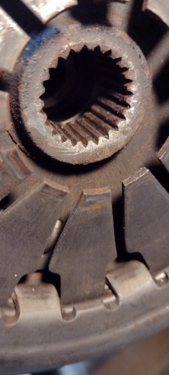

Christopher smith Posted August 2, 2024 Author Posted August 2, 2024 Looks like I found where the noise is coming from. The nasty looking scrapes on the clutch disc splines are all I see so far that might make the noise. The input shaft for the pinto trans looks and feels fine. Still hoping to understand why it worked fine for years of mild use but now gets nasty after maybe 8 to 10 starts since I put in a new replacement slave cylinder and release bearing. I did not change the clutch or pressure plate when I put in the new slave and release bearing since it probably only had maybe 500 miles of mild use. Almost seems like the splines on the trans input shaft do not go far enough into the clutch splines and when it gets used (or gets warm?) it is not far enough in maybe . I will take it further apart and take a lot of measurements. Any ideas?
wdb Posted August 2, 2024 Posted August 2, 2024 https://www.fcpeuro.com/products/clutch-disc-spline-grease-80-gram-tube-sachs-4200080050?ads_cmpid=20892570397
MV8 Posted August 2, 2024 Posted August 2, 2024 I think most of us are expecting the "grinding" noise to be gears not meshing. How about a video?Is the new slave and bearing different in any way to the old ones? I don't see anything seriously wrong with the clutch splines. You can put the clutch on the input shaft and slide it back and forth to feel if it binds and rock it on the splines to check the engagement. Use gloves or a clean rag to handle the friction face. Any metal dust? Shiny spots on anything like the crank bolt heads? Is the main case as warm as the bell? Did you check the trans fluid like I suggested? The clutch has a flywheel side and a trans side.
Christopher smith Posted August 3, 2024 Author Posted August 3, 2024 Many thanks for the input.The clutch slides on the input shaft splines fine- slides easy and no wobble but was not lubricated. I did notice the friction material may have worn and the surface is just 1.5-2 mm from the recessed brass rivets. No signs of abuse. No metal powder and very little black dust. The trans side of the disc is the protruding side. No signs of heat or wear on the pressure plate or flywheel surfaces either. Pilot bearing has about 1-1.5 mm clearance on the trans input shaft diameter and still has grease. So not sure why, but seems it is not disengaging when used a bit or hot maybe. And not sure why it worked fine for years and only developed these symptoms when I replaced the master, slave and release bearing. Unfortunately I discarded the old release bearing so can not measure but the originals and replacements were Bean Engineering so I presumed the same. The slave measures the same. did not check the trans oil yet. I am pushing 80 and my very hot garage has slowed me down.
