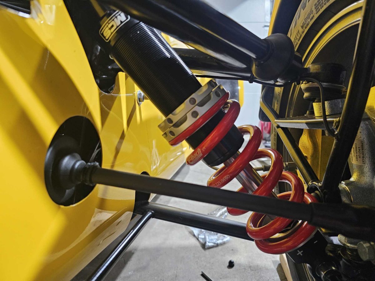

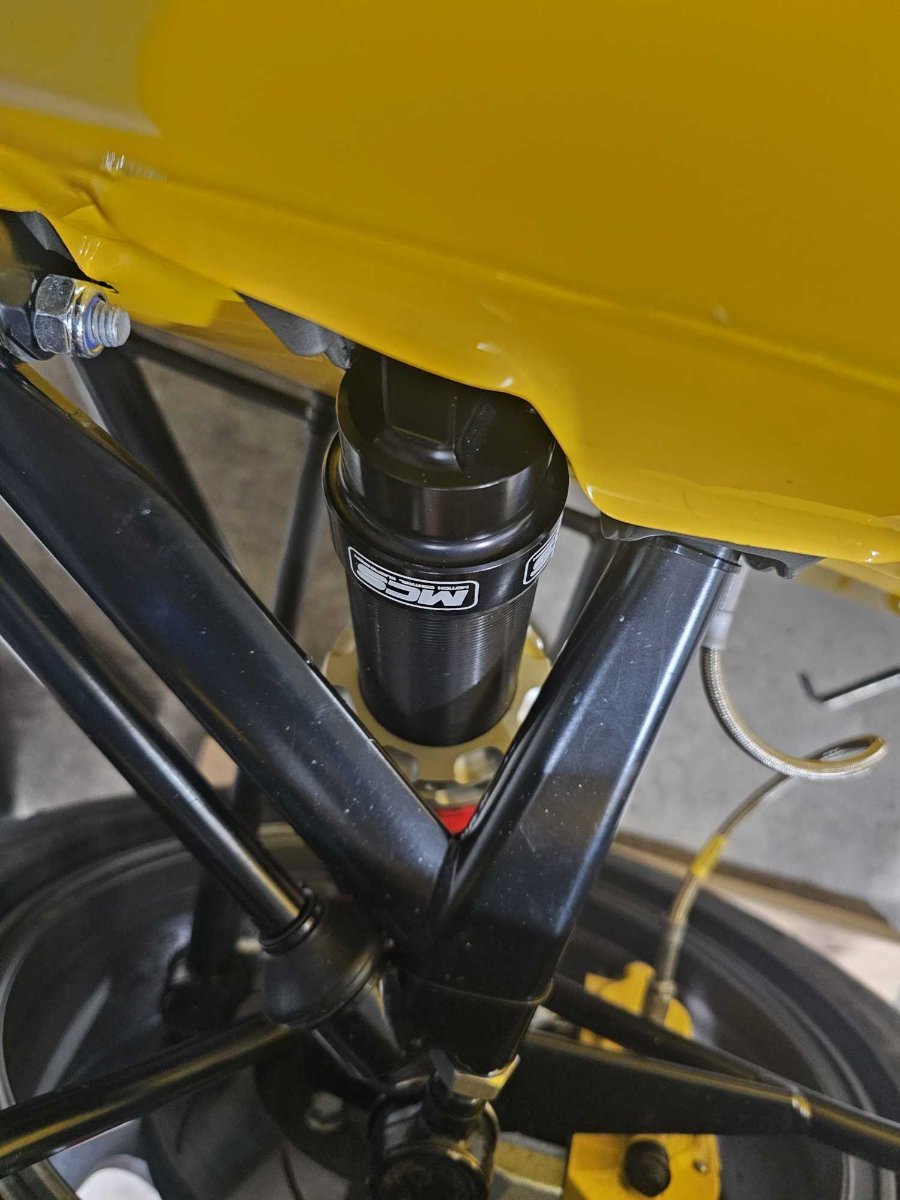

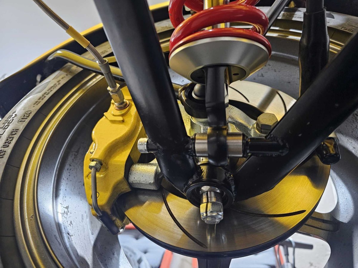

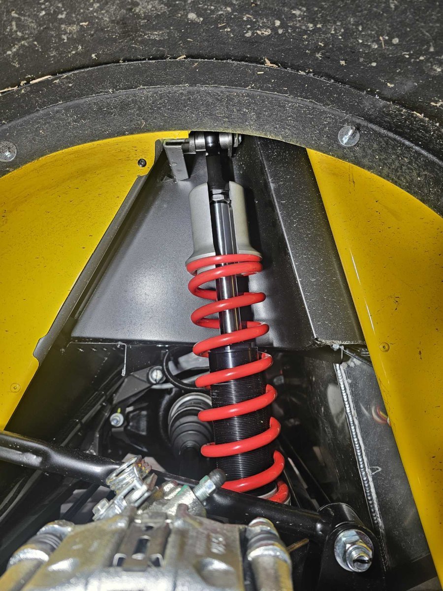

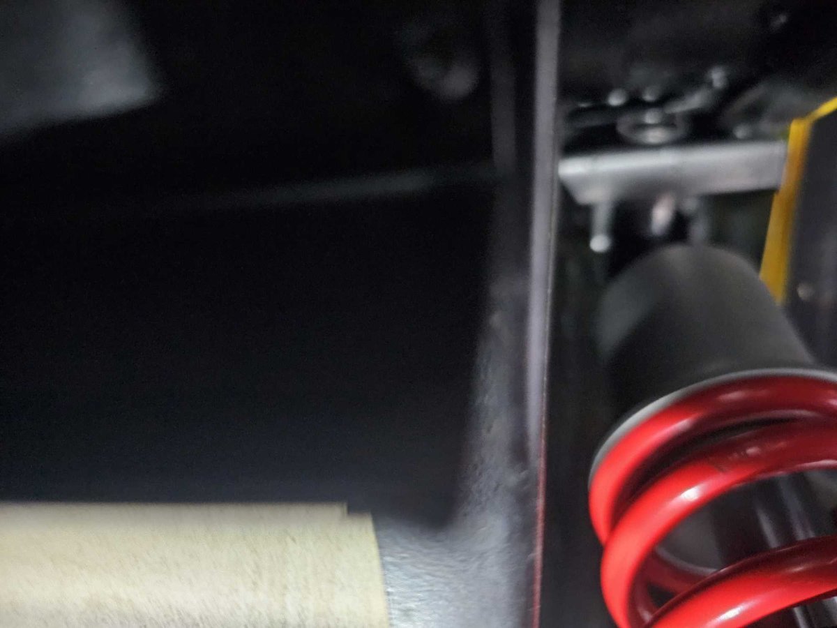

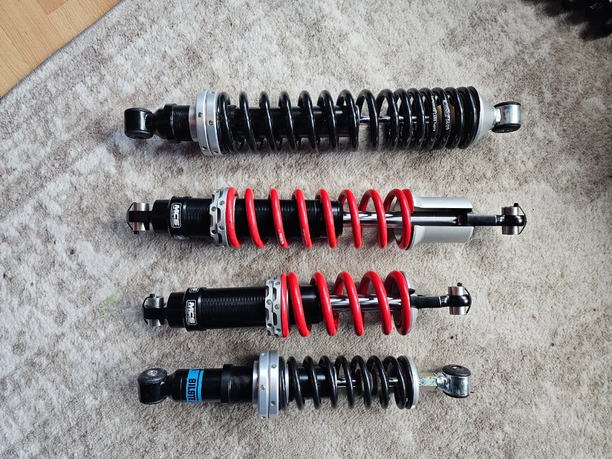

First test fit with some mockup MCS components, just to see if it fits, these are random spring rates, no adjustment knobs, no helper springs, no remote canisters etc. They feel like they weight about 50% less.
Front spring is quite large at 2.25" ID and set to fit inverted. Rear also at 2.25" ID.
They were able to perfectly match the shock lengths eye to eye and made two piece bushings which are the exact width of the insert points for perfect fit.

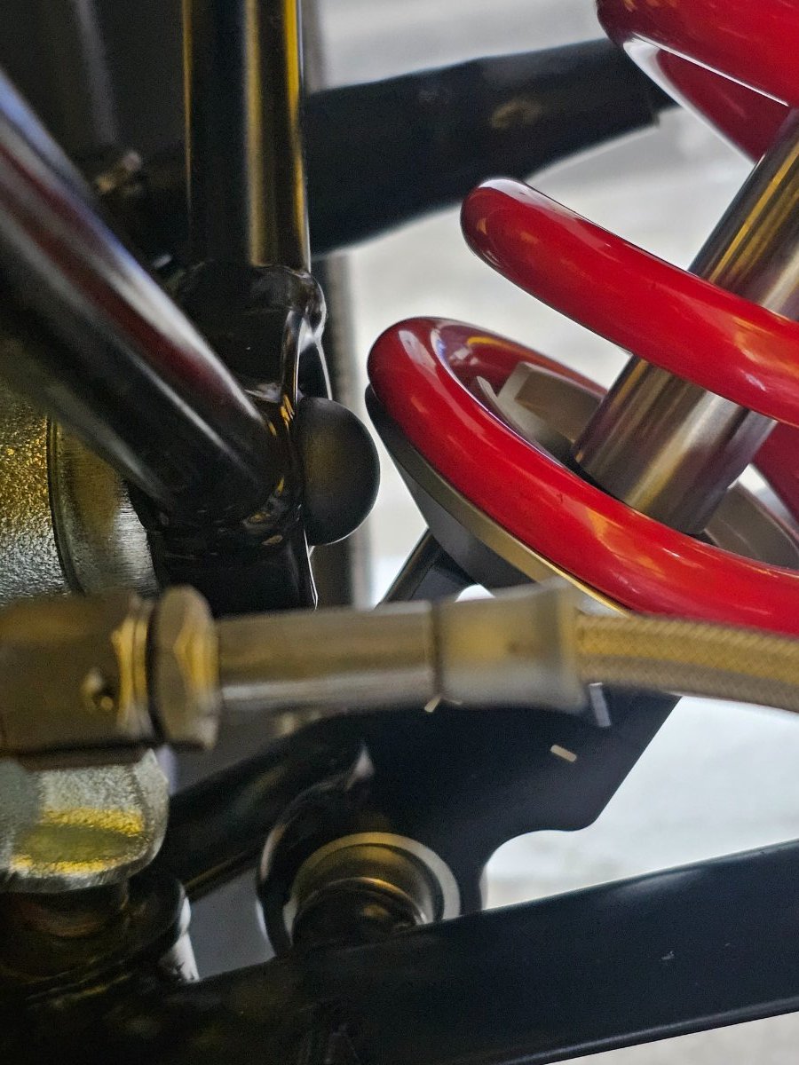

There is very limited clearance at the de dion tube to shock body with the single stock washer on either side of the bushing. Will see what they think about that.

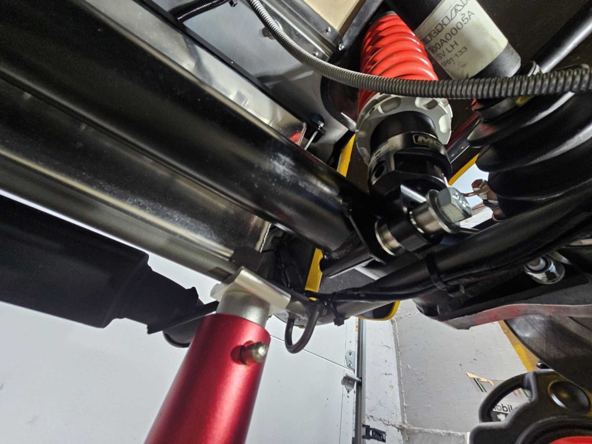

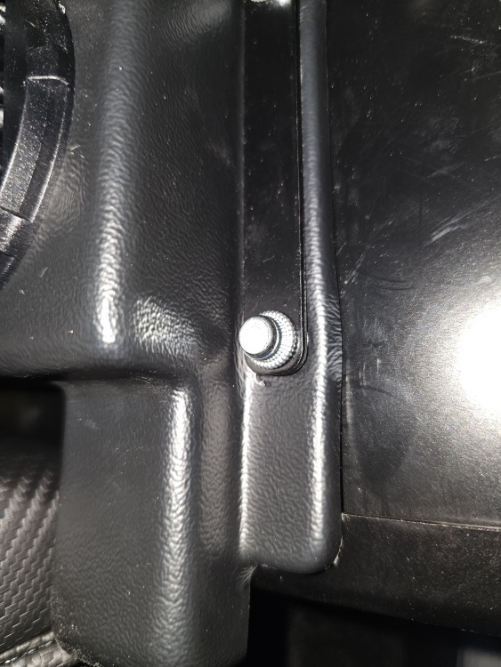

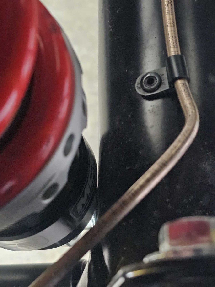

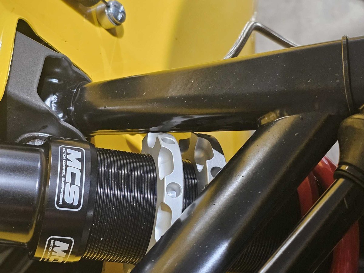

For the front, the spring perch lock rings would interfere with the upper wishbone if something like -2" ride height. Will see what they say if this will interfere for helper springs though.
ResizedImage_2026-02-25_20-51-52_10886.thumb.jpg.92d3ad06efc86096dcd00b80728b9e0d.jpg

MCS engineering order is confirmed!
The front coilovers will be upright, the rear will be inverted. This allows for the greatest amount of height adjustment without running into the upper A-arm. They say helper and tender springs not necessary unless I decide to slam it one day, in which case helpers can be added then. Currently not planning to stance it haha.
Front springs 250 lb/in, rear 150 lb/in.
It's a rather neat upper spring perch design where one can slide the perch off the side after removing preload, and if the top shock bolt is disconnected from the car, you can slide off and on a new spring rapidly without any other bolts or fiddly bits, so that can make spring rate changes really fast.
I ordered the longest dry-break reservoir lines they sell, 900 mm + 900 mm for the fronts to try and get the canisters inside the cabin footwells. The rear ordered 350 mm + 250 mm each. I'll probably mount on the rear roll cage. Ideally I'll be able to adjust all 4 corners without hopping out of the car, we'll see about that :p
