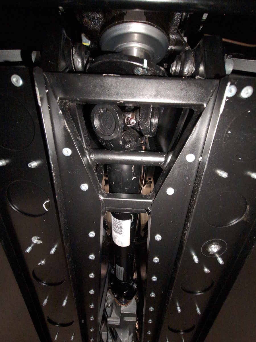

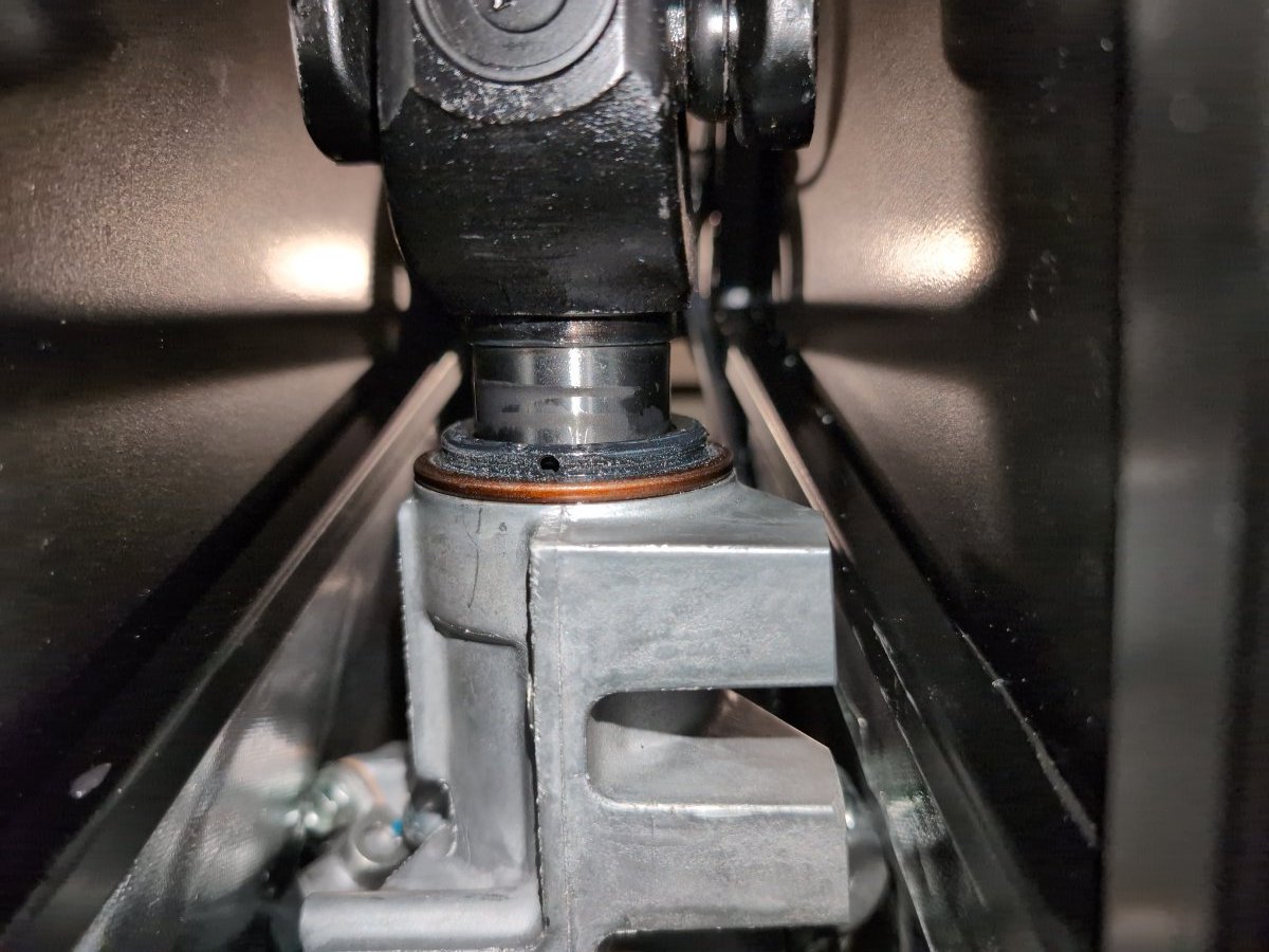

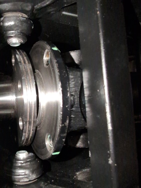

I've got some questions,and I'm not sure how much of it applies since I have a Duratec...
But here goes
1) is it possible to remove the propshaft from the transmission without removing the diff? I can't seem to find the clearance. see pics
2) are you able to pull the engine and replace it without undoing those insane spring clamps for the exhaust collectors?

1 minute ago, toldfield said:
I remove the 4 bolts from the driveshaft/differential connection and then slide the driveshaft out of the back of the transmission.
This is what I attempted today. I removed the 4 bolts, but when I slide back, it stops at the diff, and the propshaft is probably still. 3 inches into the transmission still.
I wrote a long reply and then realized that it most likely didn't apply to your car.  But in my car I can put a jack under the differential and lift it a bit to clear the prop shaft.  My car is a live axle with an Ital differential and that may make a big difference.

Can you go over the top of the diff instead of trying to come down with the driveshaft?

You did not need to disconnect the drive shaft from the differential. When you put it back, use blue thread locker and clean the bolts and what the bolt screw into. The drive shaft will come out of the transmission tail shaft. There isn't anything holding it in. To get the engine out you have to have it on an angle and all the transmission oil will spill out where the drive shaft goes. My car has a ford transmission and they do not have drain plugs. Your car might have a drain. They make plugs to put in the hole when the drive shaft is removed, but make sure you have a pan under the back of the transmission to keep from getting oil everywhere. When you put the engine back it, you have to get under the car and start the driveshaft back in the back of the transmission before the engine is completely down in the engine compartment.
@CarlB thanks for the info. I re-attached the propshaft to the diff last night. I did remember to loctite the bolts.
I also drained the transmission. I figure it's easier to just re-fill it since I'm pulling it anyways,rather than deal with a bigger mess when pulling it out.
