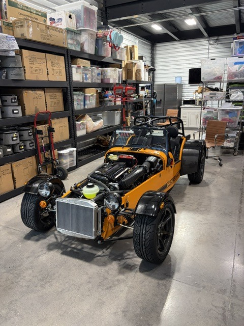

Gene_W Posted 4 hours ago Author Posted 4 hours ago Big week for us last week. Car is basically finished. Brakes and clutch bled. Followed the advice of disabling immobilizer to crank for oil pressure then once that was done and reset car started after about 4-5 attempts. Good oil pressure but haven’t run it enough to check temp gauge. Need to do a rough alignment before a test drive. We didn’t pay enough attention to alignment in the front suspension build phase and we are clearly way off on toe in and camber. As it seems everyone does we are chasing a couple of electrical gremlins. One of the LED headlights is an issue. Other is fine and signal and hazards work fine. Once we chase it down a bit more will likely come back to the group for some advice. Missing a couple small parts related to wing mirrors and waiting on roll cage additional brake light. Decided to go with classic Caterham race light style. Will likely get nose and bonnet on next week and will post completed picture. 3
Pokey Posted 3 hours ago Posted 3 hours ago Lookin' good! Just curious, does the windshield touch to cage tubing across the top?
Gene_W Posted 3 hours ago Author Posted 3 hours ago No windshield sits 3-4 mm away from front bar of cage.
