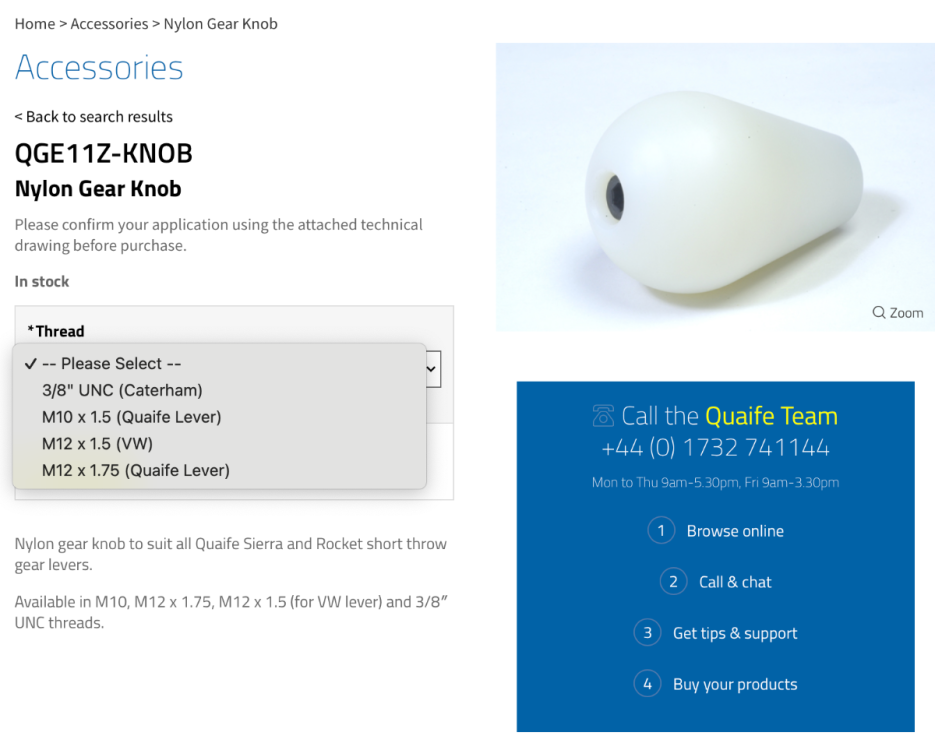

I've been considering buying the Quaife knob and they show 3/8 UNC as the Caterham-specific thread. Although I also see that
1) Some Caterham shifters have adaptors on them
2) M10 x 1.5 is very close to 3/8 UNC so maybe they still thread on.
More pertinently, Quaife UK seems to be about the only place to get the 3/8 UNC version of this knob, and their shipping cost from the UK is astronomical. Maybe they're not used to shipping anything smaller than a differential or gearset. If folks were interested in a stateside group shipping buy... (or if we could find a Quaife distributor to bring some in)
