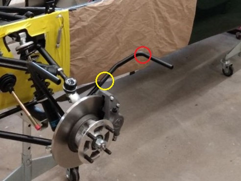

Looks good Charlie, but I think your concern of rubbing on track will come true. When I went to 13" wing stays I had very little clearance between the tire and the stay and knew that on track they would rub. I had the fenders off and was able to make two bends to get enough clearance where it doesn't rub. The first bend was in the area circled in yellow to get enough clearance on the angled section of the stay to the tire. I think I ended up with about a 1/4" of clearance. I was able to bend that relatively easy by hand using an aluminum drift stuck in the end of the wing stay. The second bend was made in the area circled in red to get the top surface of the stay parallel to the tire tread. I had to put a block of wood between the tire and the angled portion of the wing stay to maintain the clearance. I used the same aluminum drift stuck in the end of the wing stay and bent the top section back down to get that surface parallel to the tire tread. At first I thought I was going to have to heat up the stay to make the bends, but it ended being not too bad of a job just doing it by hand. It did take a fair amount of time to bend all (4) wing stay sections though. My wings are held on with cable ties and those bighead fasteners so that made it a lot easier to remove the wings and bend the stays. You could probably do it with the fenders still attached but I'm sure it would be a lot more difficult. Hope all this makes sense. Hoosiers will definitely be a little wider than the R888R's and will reduce the clearance even more so keep that in mind.

So baby got some new shoes. I couldn’t wait for nova to get their act together so went with the Toyo r888r. It’s tight on the fronts. Went for a quick test drive and didn’t see any contact. I think the real test will be on track. Deflection might cause contact. I did feebly try and bend them in situ with a block of wood and a hammer. Not sure they moved at all. Might try ratchet straps when I take the nose cone off to give me a little more room. I have a set of Hoosier r8 sitting in my shopping cart. They are very close to the diameter of the Toyos but I think the fronts are wider and will likely foul. Any insights on creating some space would be welcome, ideally without removing the fenders from the stays. I have little to no room on the outside so I don’t think spacers will work. but the new tires are on and work, at least ripping around town. ps to give you an idea of how close it is. The tire pubes contact the stays
