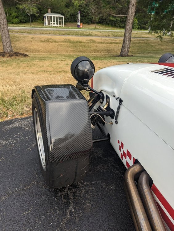

Vovchandr Posted June 11, 2023 Author Posted June 11, 2023 Loving the lower headlight mount Something is making a noise going over bumps though. I think it might be CSR wings flexing and impacting tire. Left in particular.

MV8 Posted June 12, 2023 Posted June 12, 2023 11 hours ago, Vovchandr said: Something is making a noise going over bumps though. I think it might be CSR wings flexing and impacting tire. Left in particular. Can't see mounting detail from your pics. It looks like the mounting bracket stops at the wing outside edge versus extending into the wing above the tire. If that is the case, the wing should have vertical ribs or gussets above the tire at the mounting bracket attachment but I expect they do not. Looks like they just mount to the outside, relying entirely on the flange of the carbon layup. What does it look like inside the wing? I expect a reinforcing strip inside sandwiching the carbon at the mounting point would cure this.

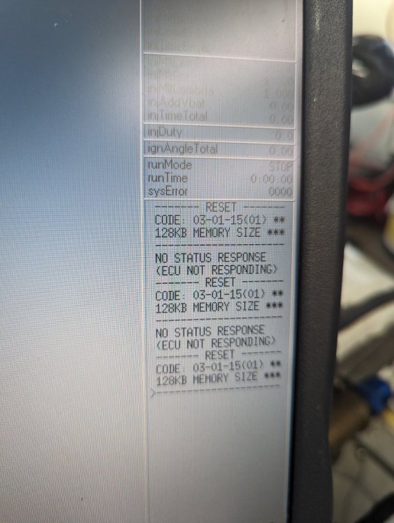

Vovchandr Posted July 22, 2023 Author Posted July 22, 2023 (edited) @ all Another year, another track day coming up, another emergency on the radar As some of you know I've got careless and was distracted and hooked up the Lithium battery backwards and my car. This was discovered when I went to turn it on and there was no sign of life and then I discovered that the Lithium battery started to go into the run away heating cycle where it was heating up faster than it could cool off.. With that danger avoided I didn't have an opportunity to test it with any other battery at the time so I ordered another one. Today a new battery came in so I went to try to start it to see what damage I did, and *drum roll* cranks but no start. I can hear the fuel pump turn on, I plugged into the ECU and the Pectel is at least alive but I've got no spark. Checked the obvious array of fuses under the dash and didn't see anything that could be related to spark other than the ECU fuse which is good. Any ideas what it could be? I have a feeling ECU works but isn't entirely functional? I'm now in a slight panic trying to get the car ready for this years track day but this seems status quo for every year. *I should note a disclaimer for the experts as I like to make things difficult. I've also messed with the ECU pigtail and unfound the 20? year old electrical tape that was covering it and unuplugged it to see if I had a spare pin available to wire in the wideband. I found out that I do not, but it's worth mentioning that the wiring loom has been disturbed. Edited July 22, 2023 by Vovchandr

Vovchandr Posted July 22, 2023 Author Posted July 22, 2023 I believe the flicker/dimming is from the load My battery voltage is showing 13v on tester but ECU is showing around 10v in the software which is strange I'm also getting errors in the ECU log when I try to start it with a communication failure. Not a good sign. Posted about it on the Pectel forums. As I see it now I have about 7 different paths and outcomes 1) New Lithium battery is not giving proper voltage to ECU causing problems. Test with regular. 2) I messed up the wiring by disturbing it when unplugging the ECU, fix wiring as solution 3) I blew some sort of basic fuse or else, find and replace 4) I fried the ECU by hooking up terminals backwards. Find another Pectel T2 (impossible) or get it fixed/serviced? 5) I fried the ECU, redo wiring harness and put stock Ford ECU and figure out how to make it work with ITBs 6) I fried stock ECU, commit to a better ECU and do a harness swap quick 7) I friend stock ECU, commit to swapping the Duratec that I have sitting Ill have time to do some of testing above later today or tomorrow

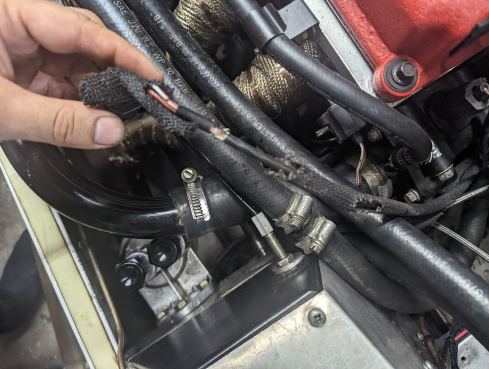

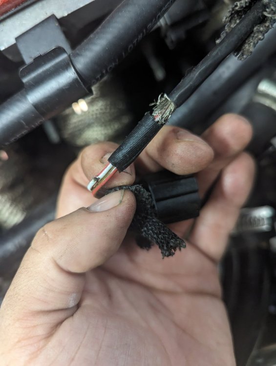

Vovchandr Posted July 24, 2023 Author Posted July 24, 2023 (edited) 5 hours ago, MV8 said: What are the results of the checks I posted yesterday morning? My cluster works but it's aftermarket and it doesn't really respond instantly to cranking. I checked old videos too, it blanks for a few seconds and then works. Current Old start example in the beginning of video. Known good It doesn't appear I have EDIS, all my coil wires either go to under dash to I believe tech or ECU My crank wire however might have taken the blunt of the short. Voltage going to it is 0.48 on one and 0 on other and the wires look for the worse with the shielding. Crack in one too. Not sure if this is new but i don't believe it's always been like this Haven't tested resistance yet of the crank sensor Edited July 24, 2023 by Vovchandr
MV8 Posted July 24, 2023 Posted July 24, 2023 Looks like the ecu has failed based on dead ignition channels and no EDIS module to check (integral to the ecu). The shielding on the ckp isn't critical and would not be connected / grounded on one end anyway. It is unlikely the ckp has failed. You probably will need an alternator once it runs again with a new ecu or efi system. Since you are in a hurry, pic an off-the-shelf system with an a conservative tune available for your config. Before replacing anything, look for overheated wires throughout the car even if a fuse did not blow. These are wires where the insulation is not smooth and uniform should be replaced as they could short or have hidden damage. Lot of cars end up in the junkyard due only to intermittent problems. The cost is not fixing, but finding. 1
