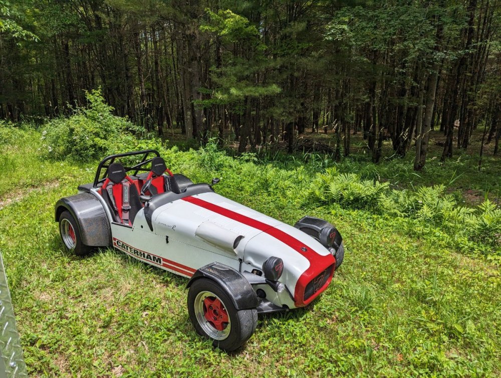

18 minutes ago, Vovchandr said:
Another shakedown run today with no issues
It's about time!  :D Hopefully this is part of a long-term trend.
Looks like it was photoshopped?  Where's the coolant or oil leak?
:troll:
I hear weeds are a great absorbent.

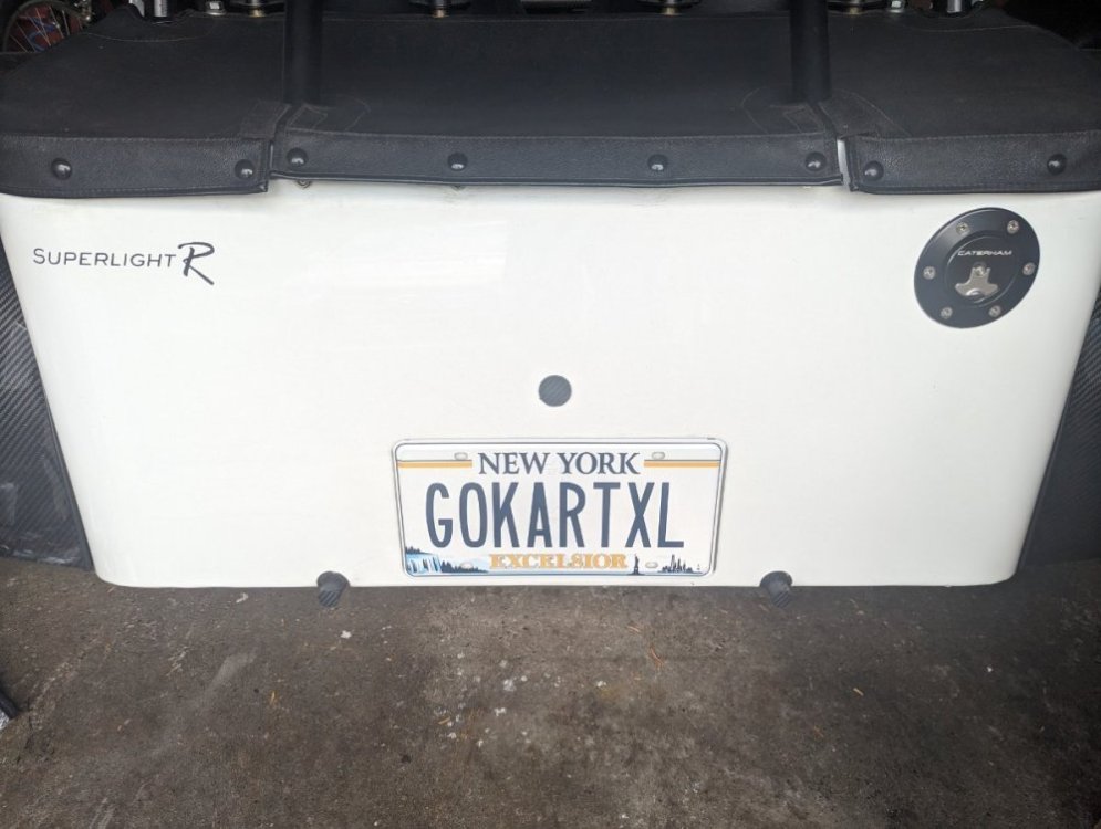

Don't think I ever posted my plate in the thread.
Seems appropriate to add to the story

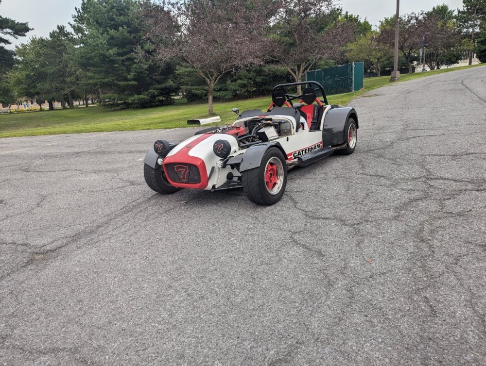

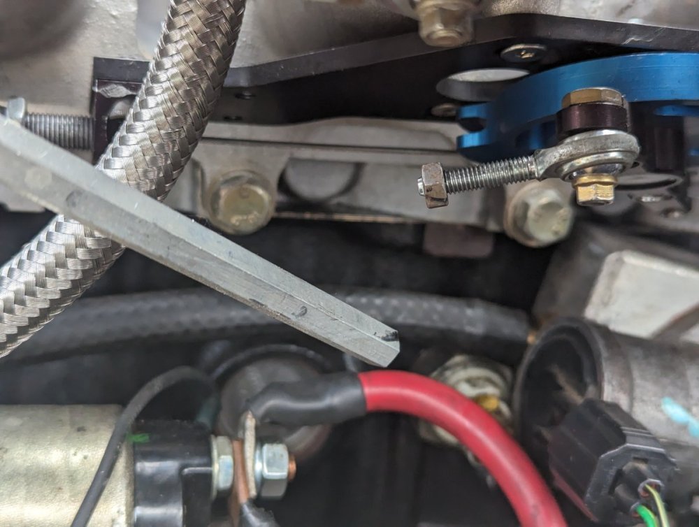

I have found myself in familiar shoes today. Doing a workout of pushing 1300 rolling lbs.
Lucky for me it was a quick fix. I thought I lost throttle cable but it was even drastic than that. Having tools on hand proved itself once again
Edited by Vovchandr
I've been fiddling with my throttle body linkages lately and I was surprised that many of the lock nuts were loose, so I tightened them. Is that what happened to you here? (note that this did not fix my own rev hang, but from your example, it was definitely was worth doing!)
It's hard to tell if it was lose or just gotten lose. None of those are lock tite'ed. I believe this is how it came once it came back after being rebuilt from the manufacturer (BORLA) after I send it out to them. I haven't messed with that linkage in particular. I've probably put on about 1200 miles since the the ITB's came back.
I also can't tell if the nut has migrated down from vibration or the linkage was really on there with just a few threads.
Either was was pleased it was nothing serious or didn't happen on the highway (I was just about to get on)
I have noticed that throttle was feeling a little strange over the last few ourtings (harder to press) likely was/is related.
