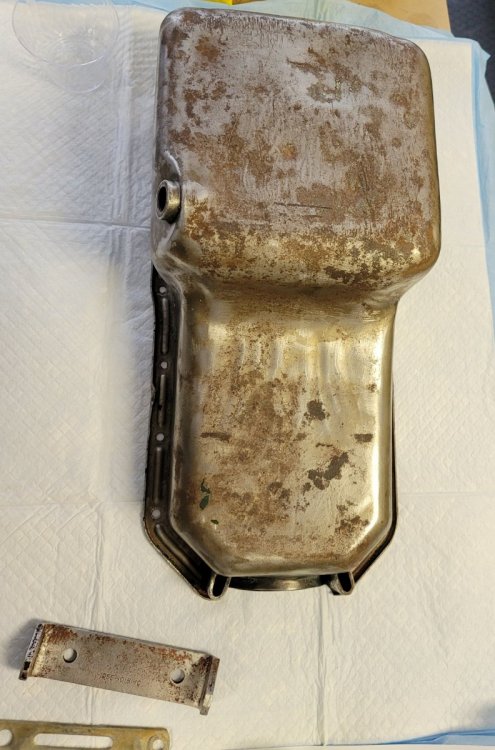

Spent some time this weekend prepping my sump for painting...

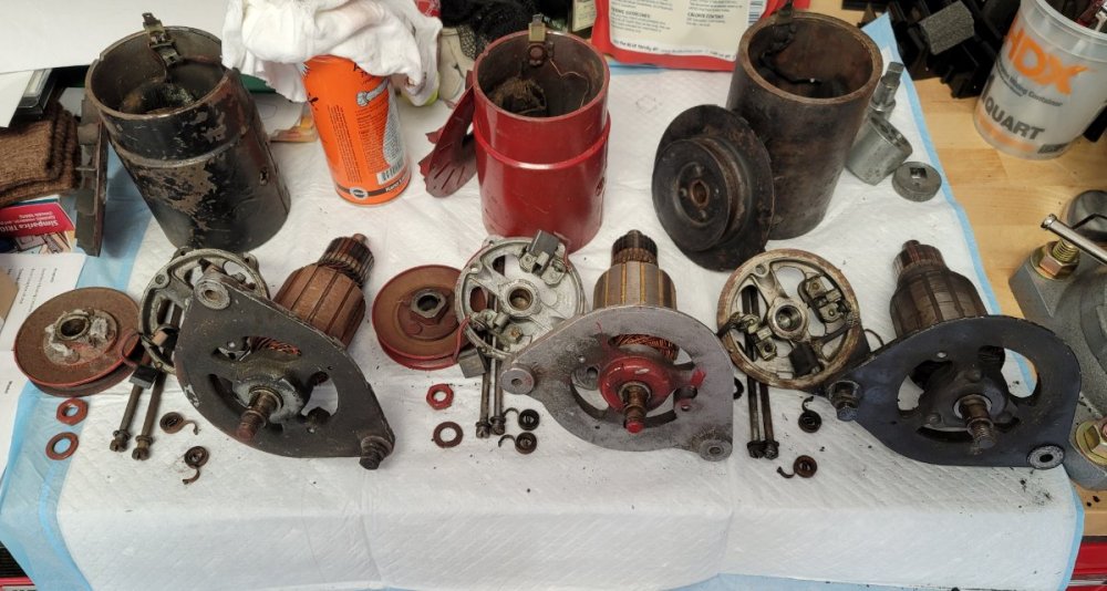

... and beginning a refresh of the generator.  The one on the far right came with the car, a replacement, an Australian made Lucas C40 from 1966 that I'll redo as a spare.  I had 2 spares - one from 1964 that I'll likely use and one from 1960 for parts.
Finally coaxed out the woodruff keys with a bit of Kroll, heat, and a mole wrench.  The armature all look lightly used and in good shape, and the brushes on the 64 and Aussie generator barely worn.  After cleanup, paint, and replacing the bearings and bushes should be good as new.  The red 64 unit is so clean, it was either lightly used or rebuilt and set aside to gather dust.

2 rebuilt and running smooth (bench tested as a motor, to bed in the brushes), and plenty of bits left over for the parts bin - though it is hard to imagine enough miles to burn through 2 generators.
