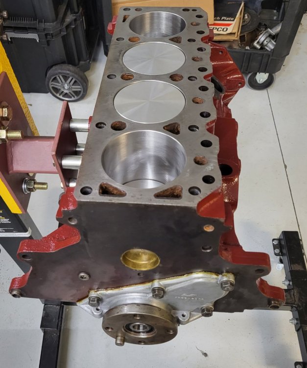

SENC Posted September 17, 2021 Author Posted September 17, 2021 Finally a little progress... put in a new camshaft (fast road, slightly more lift than the A2) that fit and spins as expected, and then got the pistons in.

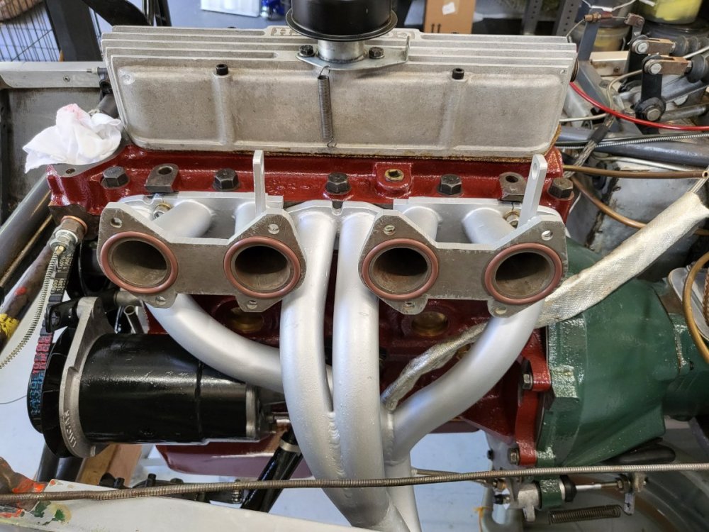

SENC Posted September 26, 2021 Author Posted September 26, 2021 Test- fit the gearbox and final checks... hopefully back in the car in a couple weeks.

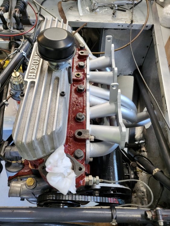

SENC Posted October 23, 2021 Author Posted October 23, 2021 She's back on her feet and full of fluids. Turned over without plugs to get fuel in the carbs and saw the oil pressure gauge start to move, so the battery is charging overnight and will see if she starts tomorrow. Well wishes and final words of warning or advice are welcomed!
panamericano Posted October 23, 2021 Posted October 23, 2021 Best of luck for a great Sunday morning drive. I just love some of the details, from the little fan blades to the sparking plug boots, and that nice battery cage. Sweet job.

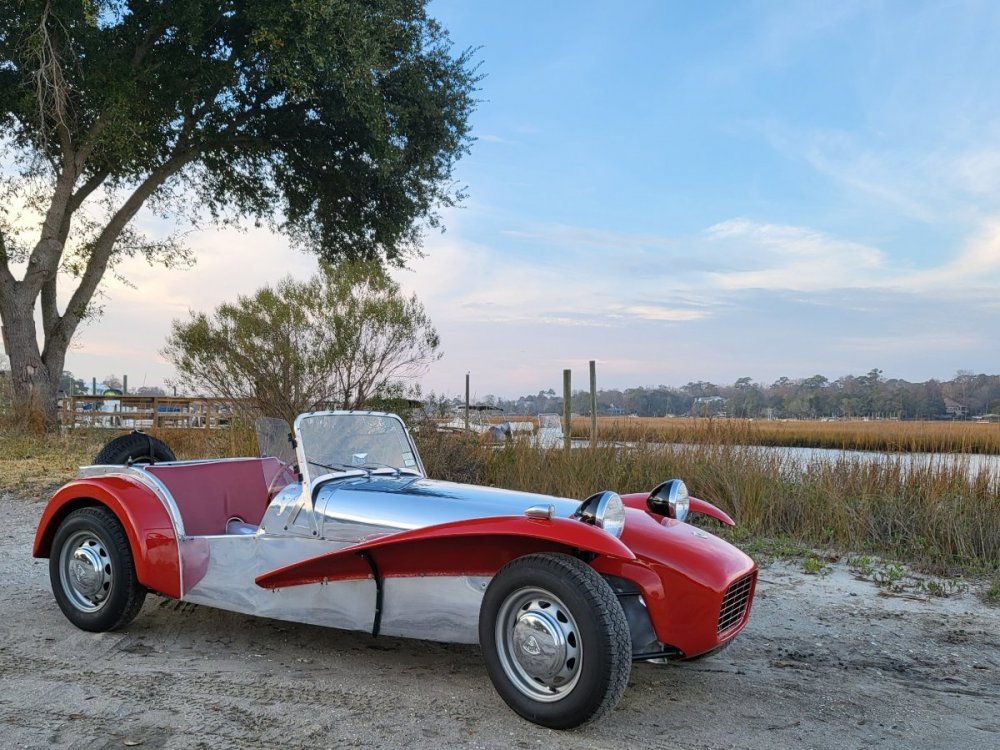

SENC Posted December 11, 2021 Author Posted December 11, 2021 Had a beautiful day to take a drive and tune some more.

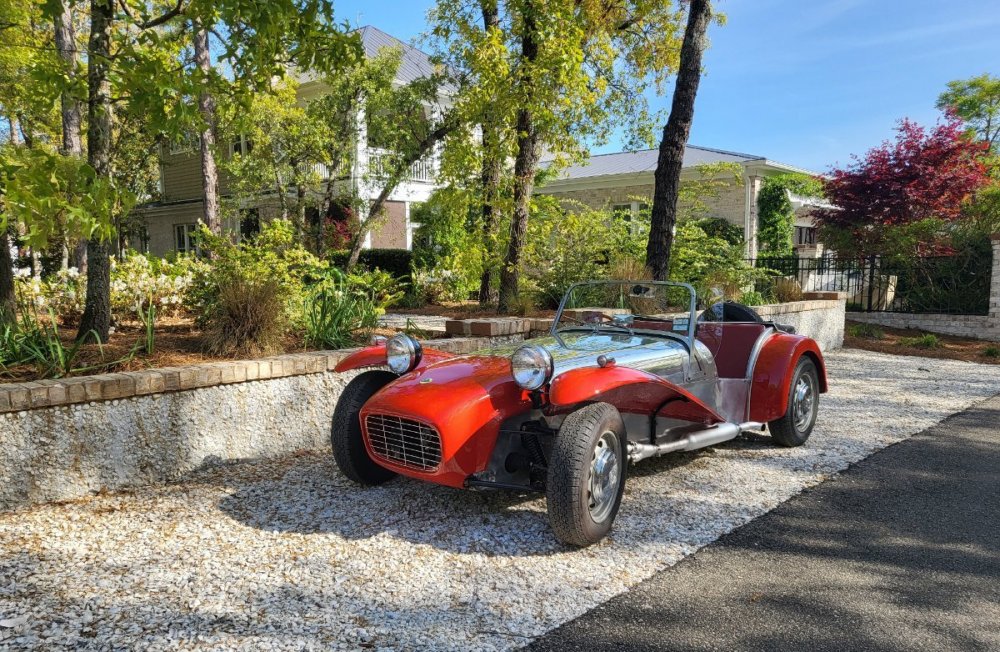

SENC Posted December 26, 2021 Author Posted December 26, 2021 Blessed with spectacular 70° weather allowed a couple drives this weekend, after changing the 79°-30' butterflies for 78° butterflies, on Keith Franck's advice. This effectively moved the 1st progression holes downstream by .5mm, which made all the difference in the world in the transition, eliminating the popping on decel while maintaining a nice idle. I have a little more tweaking to do, but think I'm getting very close to finding the right balance now. My 20 y-o daughter, home from college, got her first ride in it - all smiles and giggles as we accelerated through curves! I'm not embarrassed to admit to giggling every time I drive it, too!

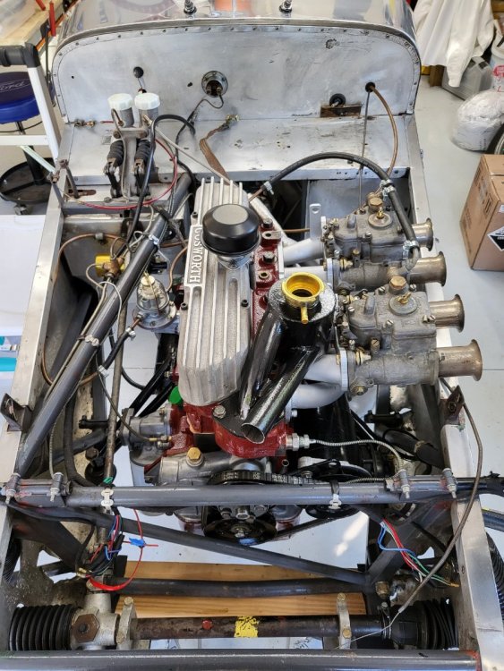

SENC Posted June 10, 2022 Author Posted June 10, 2022 Finally got tools and cars relocated in a new storage and "toy shop" space a friend and I have taken, so can get back to tuning and tweaking on the Seven (and back to valve and shim dx on the Elan) - but one step forward and another back... Took the Seven for a bit of a drive yesterday to reset my thoughts on how it is running, and though the engine is running pretty well I had a clutch slip when shifting to 4th at high revs from 3rd. Was able to replicate and identify the slip is only at higher revs, >4k or so. As it is a new (old stock) clutch disk and pressure plate, I'm thinking I either have some oil/grease contaminating it or that the release bearing is bad. You may recall that, upon getting it back on the road, I had some bearing noise upon full clutch depression that stopped after a hundred miles or so. As it was a NOS bearing, I had hopes that old, dried bearing grease had just needed to warm and soften, but I'm questioning that now. Either way, I suspect I'll need to oull the engine again to fully diagnose, though I may try to look around with a boroscope to see if anything obvious sticks out. I'd welcome any other thoughts.
MV8 Posted June 10, 2022 Posted June 10, 2022 About the crankcase pressure, is it broken in yet? Is the road draft tube installed and taper to the rear or is the end square cut? Was there a pan baffle/windage tray? Standard volume pump? Thicker oil doesn't drain back to the pan as quickly so you probably have more in the valve cover than if you ran something thinner. Too late now, but a common mod during building is to smooth internal surfaces and radius oil returns to aid flow back to the pan. Glypt was often used to coat internal surfaces for a slick, oil resistant surface. I see you have a borg and beck pressure plate. These have higher ratio levers (5-6:1) than modern diaphragm spring pressure plates (effectively 3.5:1) and are slower to fully clamp the clutch after a shift. I'd try a little more time between foot off the clutch and applying throttle before another tear down. If only we could pump fresh synthetic grease in NOS release bearings. 1
SENC Posted June 10, 2022 Author Posted June 10, 2022 Thanks MV8! I'm definitely going to drive it a bit more before pulling it, so will see if I can duplicate the symptom well after a shift, good recommendation. Re oil on the cam cover, I'm pretty certain now it was splash rather than pressure/spray. The piece of tin I fit into the filler neck to block a direct line from the filler hole to the underside of the cap has prevented any further leaking through the cap. I have not yet refitted a road draft tube to the breather tube in the block (the breather tube I have is not a great fit for the road draft tube connector), but it seems to be breathing OK even without that bit of venturi pull.
