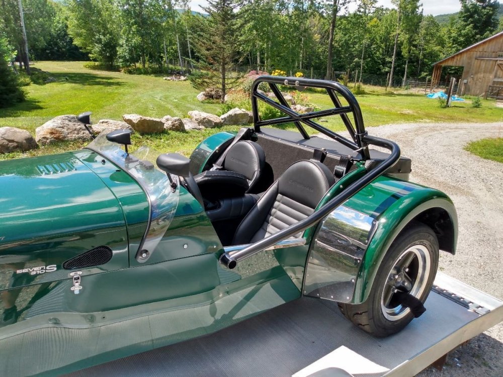

My 2019 310 has an inertia switch and I'm pretty sure they've been standard for a while.  Probably on all the fuel injected motors.
