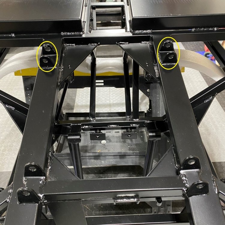

@lg2k Thanks for the photos.  This gives me a better idea of where things go and what the clearances are. :cheers2:

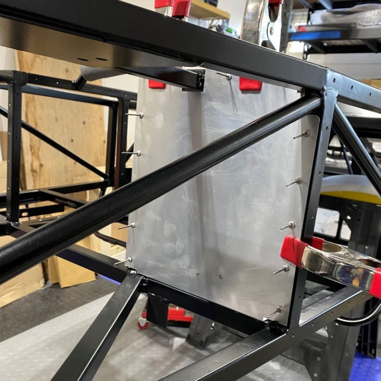

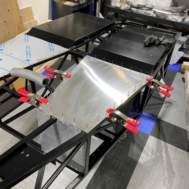

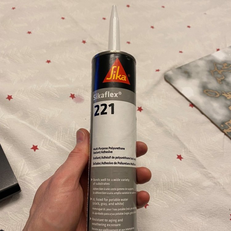

This afternoon I made a brief start on the footwell panels.  I started by removing the protective film, "de-gooing" and then rechecked each one for fit.  Some of them still had a bit of de-burring to do, so I took care of that before opening my amazon package of Sikaflex 221.  I'll use this instead of the multipurpose silicone sealant provided in the kit.

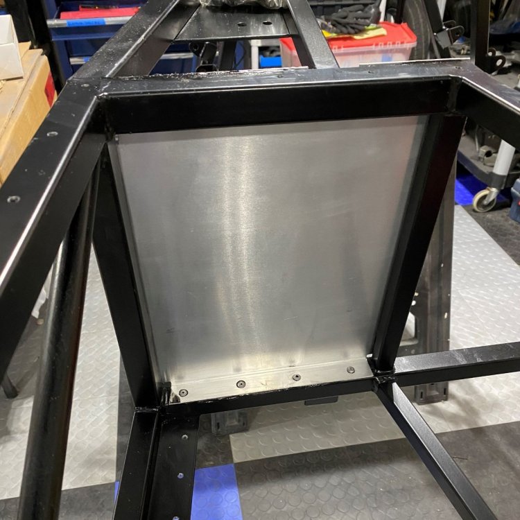

First panels on were the footwell firewalls.
IMG_4336a.thumb.jpg.63391e3c9027bd49b4a4aa9ad0519a52.jpgIMG_4338a.thumb.jpg.baf89bed15018cb8eafeaa42cf906d21.jpg

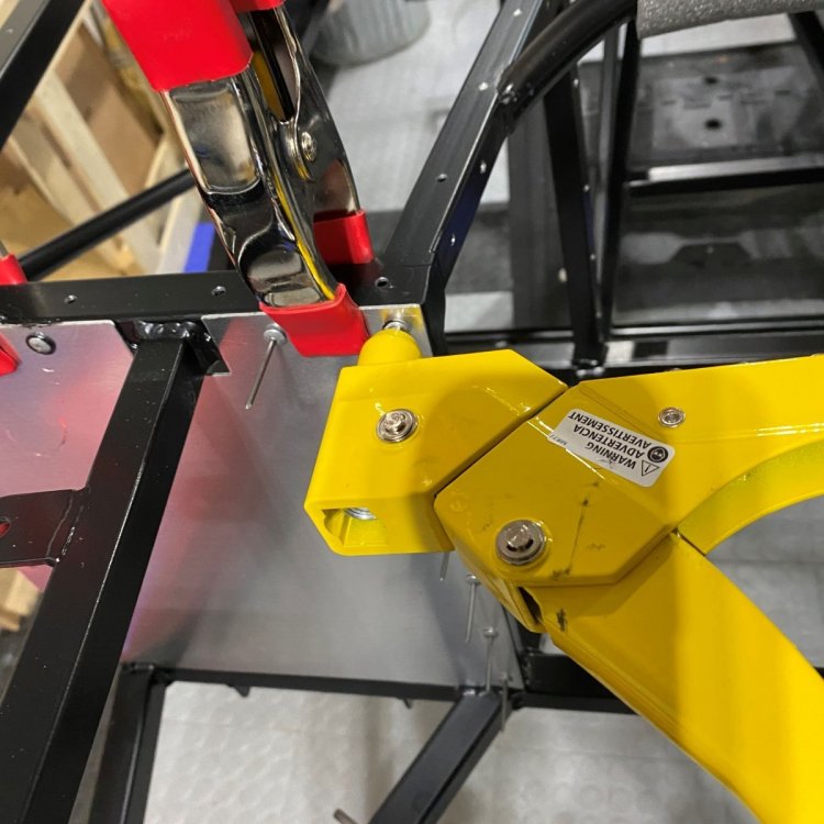

I know, I know, I should invest in a pneumatic rivet gun......... :918766748_biggrinjester(1):
The last panel of the day was the PS floor.

1. Sikaflex. amazing stuff, but no matter how careful you are and how much attention you pay, this S**t gets everywhere.  I also found it hard to squeeze out. Perhaps the hole was a bit too small!?
2. How to pull apart, clear and re-assemble a rivet gun that has just chewed up the mandrel on the second rivet you have ever installed.
3. I will have hands and arms like Samson by the end of this!!
4. Did I mention how Sikaflex gets everywhere.......i'm still cleaning the orange strap on my watch!
Hard to squeeze out the Silkaflex? Maybe its the cold  temperature of your work room/garage? Just speculating.

This time I opened up the nozzle a bit more and preheated the Sikaflex over one of our floor vents (Thanks for the tip @Kitcat).  I still found it hard work but definitely easier than yesterday.
Another thing I learned today is that about 18 hours after applying the Sikaflex it is strong enough to hold and pull away from the rivet heads and panel.  From now on I won't be in such a rush the wipe of the over spill, I'll let it cure a little and then clean up without the stickiness.
When Sikaflex reaches the end of its shelf life, it becomes very hard to press out. What is the best before date on the tube?

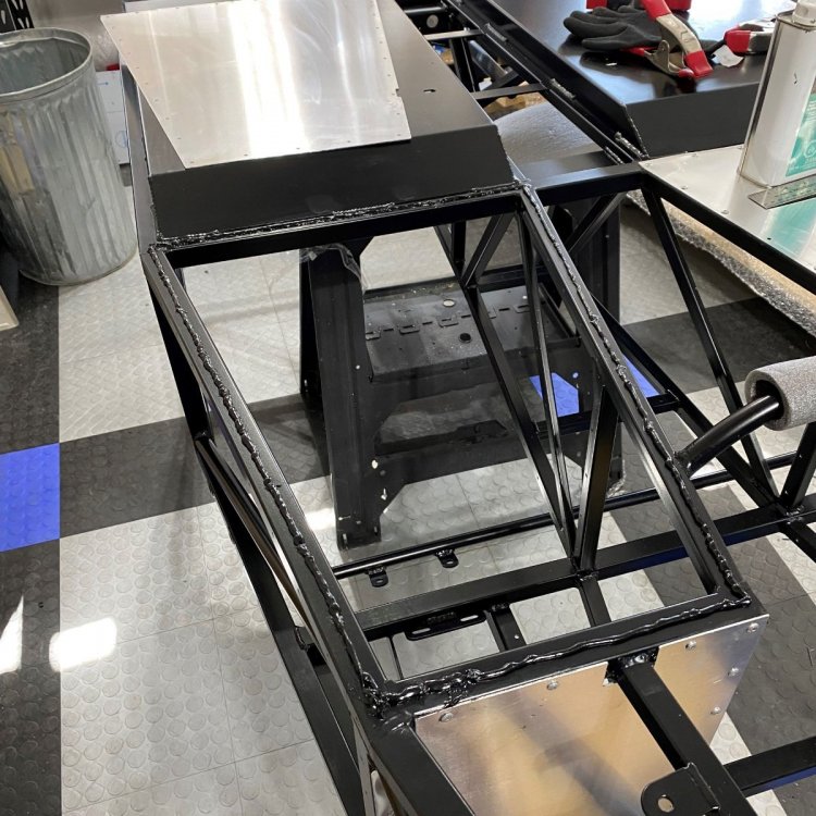

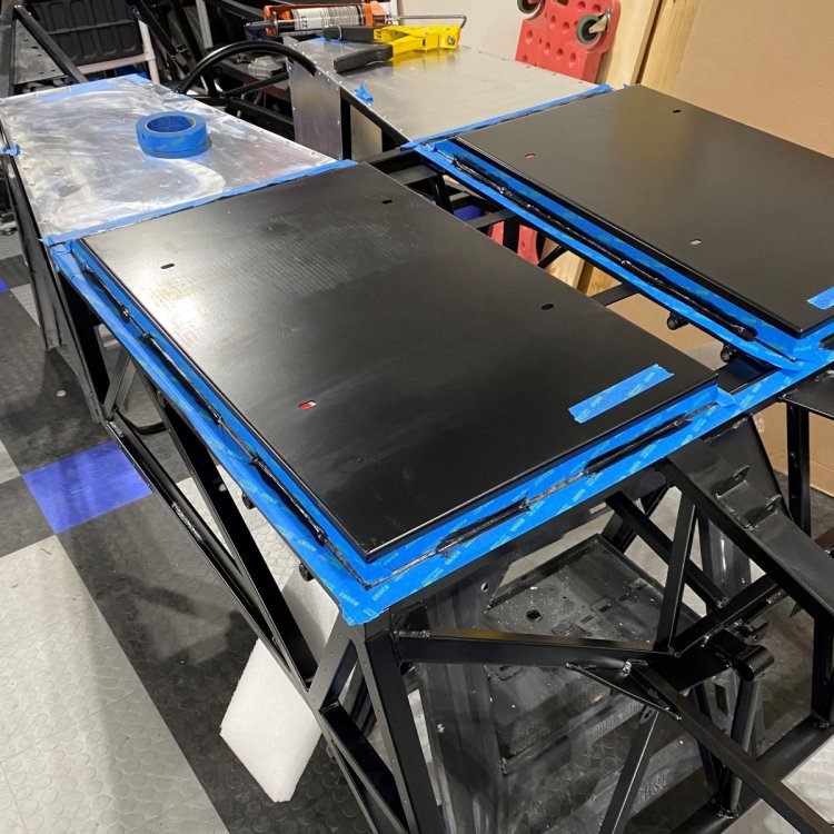

Well, I spent some time tidying up the dodgy powder coat patches and then filling in some of the floor pan joints with sealant (Thanks @BobMet, I got the idea from your thread 🍻).

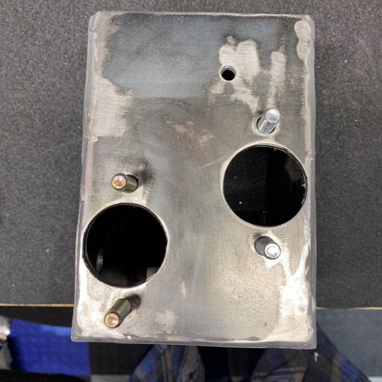

Next, I spent some time on the pedal box modification.  I talked a bit about this in my "Tech Talk" thread and finally got around to doing something.
As you know I had an issue with my handbrake bracket and had to have a new one welded on.  Well, by coincidence my welder also owned a metal signage company and was equipped with CNC cutting machines and the like.   He was able to fabricate and tack on a new faceplate for my pedal box to the Flyin' Miata spec for a very reasonable price.
Here's the before...
After....
Painted (With Rustoleum Universal All Surface Paint - Satin black
and reassembled
That looks great. Nice job!

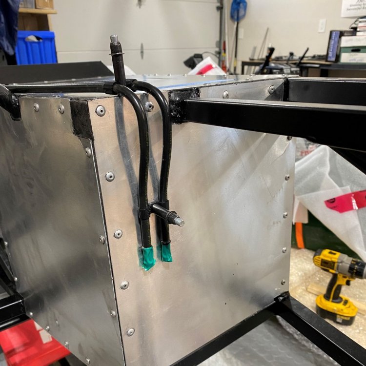

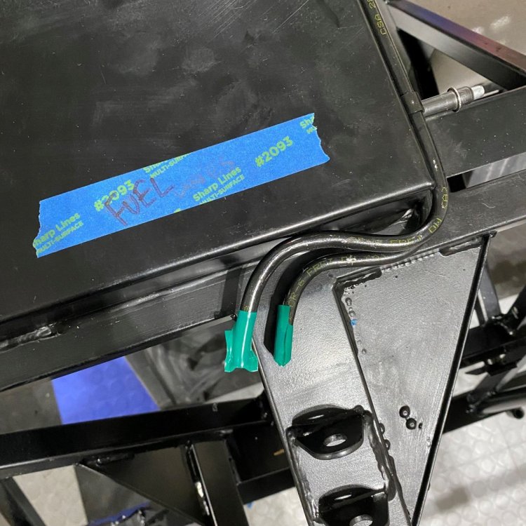

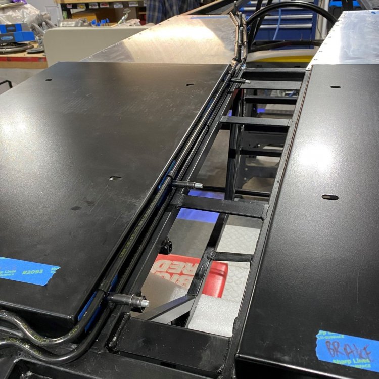

In my last post I had started to run the fuel lines lines on the chassis.  Running and bending lines is completely new to me so I have been really taking my time (Perhaps too much) to get them neat.
I bought this pipe bender at Canadian Tire and it seems to be working great so far.
I also had to try and figure out how and where I was going to terminate them at the rear to compensate for the new brackets that Westfield have introduced to the SDV chassis.
I the end, the decision was made for me when I tried to put two bends too close together and the pipe broke....I quite liked the way it turned out so I cut the other pipe short as well....I like symmetry!
I still have a few clips to add but at least its a start.

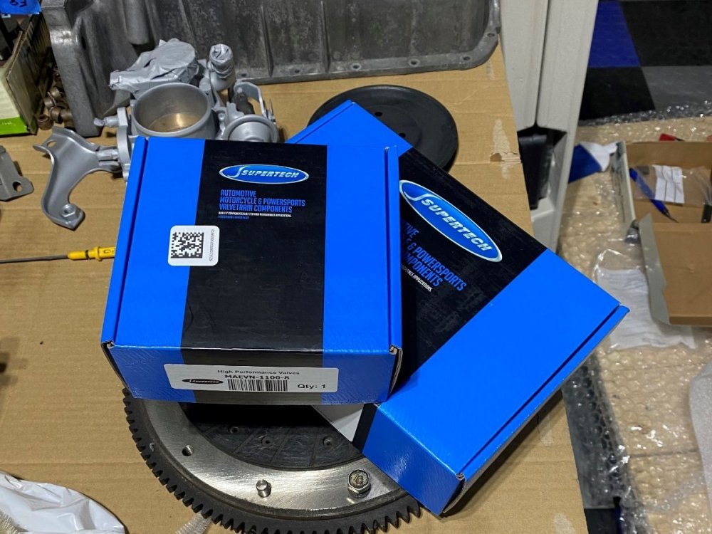

What else is new?... Well, in the fall when I was inspecting my engine, I noticed a fair amount of exhaust valve burn.  Instead of replacing the valves with stock I decided to upgrade to some Supertech high performance valves and springs from Fab9 tuning in Michigan.  After months of waiting they finally came through!  Happy Days, I can now reassemble the engine and claim back some valuable real estate in the garage.
I am not quite sure about the chassis orientation in your pictures. Correct me if I am wrong. If I am not mistaken the fuel lines run along the bottom of the floor before they turn up into the engine bay?  Is that correct, that is very exposed position, stones, rocks, curbs could easily damage the lines.
Graham
@fastg
Hey Graham,  I thought that too initially, but all the Westfields seem to have the same routing.  They are certainly exposed to stones etc., but anything bigger like a curbs would have taken out the oil pan long before the lines! lol
My Westfield has the hard lines running through the transmission tunnel.  Much older car, but it is odd they moved them to that position.  I wonder if that is a result of the Miata transmission which is wider than the Type-9?
