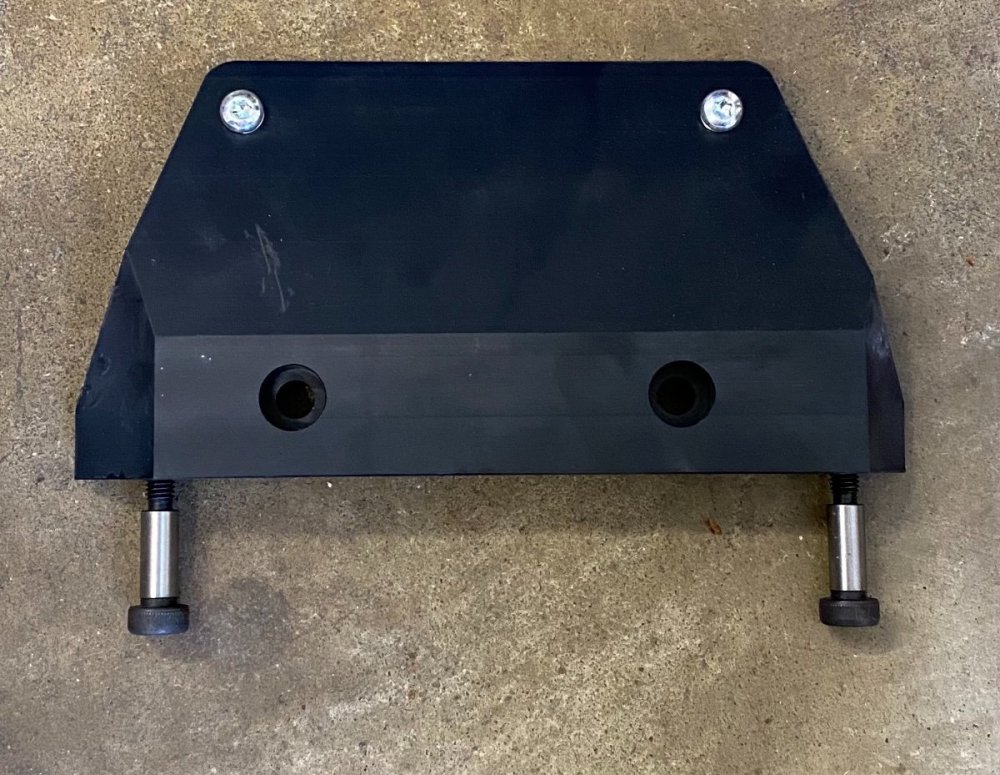

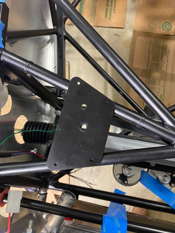

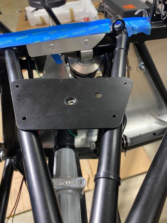

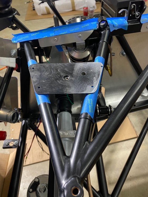

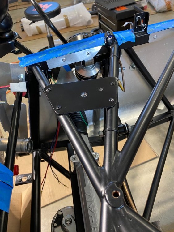

Expansion tank bracket does not exactly fit like a glove. Per Josh- either use 3 holes (“plenty” enough to hold) or drill another hole. Only thing that matters- drilling perpendicular and as close to the centerline of the frame tubes as possible.
23970DCB-8B4E-4AC7-BD9A-02AC28137E26.thumb.jpeg.ec2b58b3f6f884c3072a2b0c1afd3515.jpegDF5DE729-B8B0-4441-8651-4719AC00DFAC.thumb.jpeg.c3eca0767ddfe2b3015fd2f73252f7ba.jpeg
Mine was off but not quite that much. Rather than drill a new hole I just cheated all the holes a little bit from midline and it worked out. In your case I'd consider just drilling another hole.
I just used the 3 holes that lined up, don't need the 4th there's virtually no load on the plate, unless it's an OCD trigger.

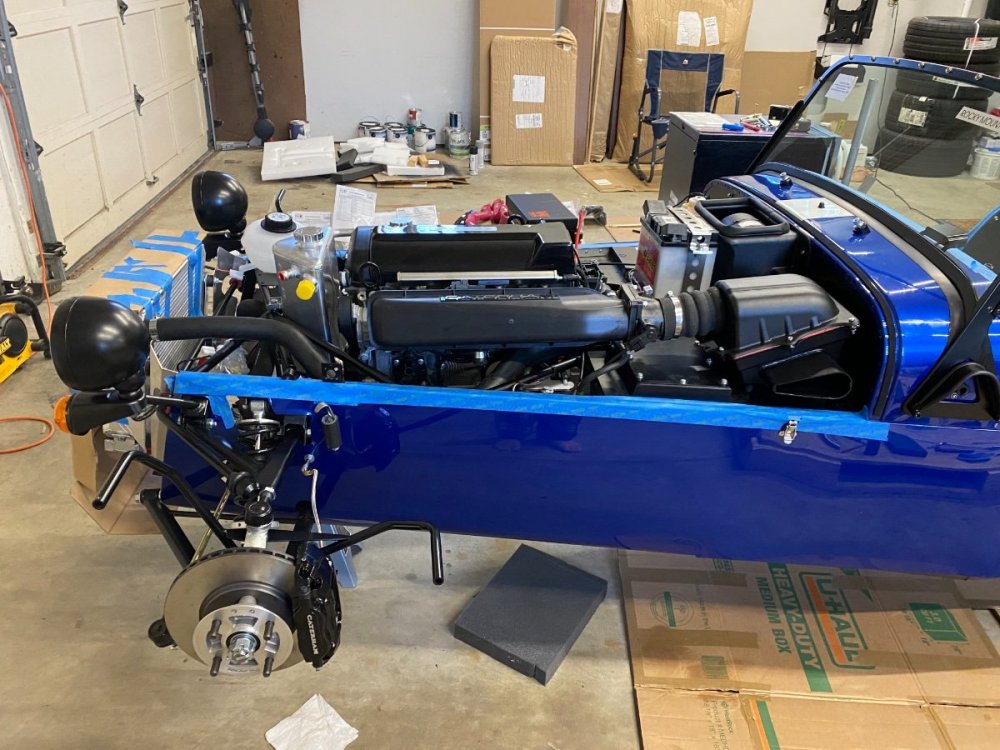

Fun build.  Nice trans tunnel insulation!
If it were my build, I wouldn't have installed the heater.
Sevens are usually hot enough.
I have my doubts that those jack stands are tall enough for the engine install???
I second the tip about waiting to install the radiator till after the engine is in place.
Install a master battery cut off switch and crash/inertia fuel cut-off switch

Okay, grinder, primer, rattle can…. drill new hole and done.

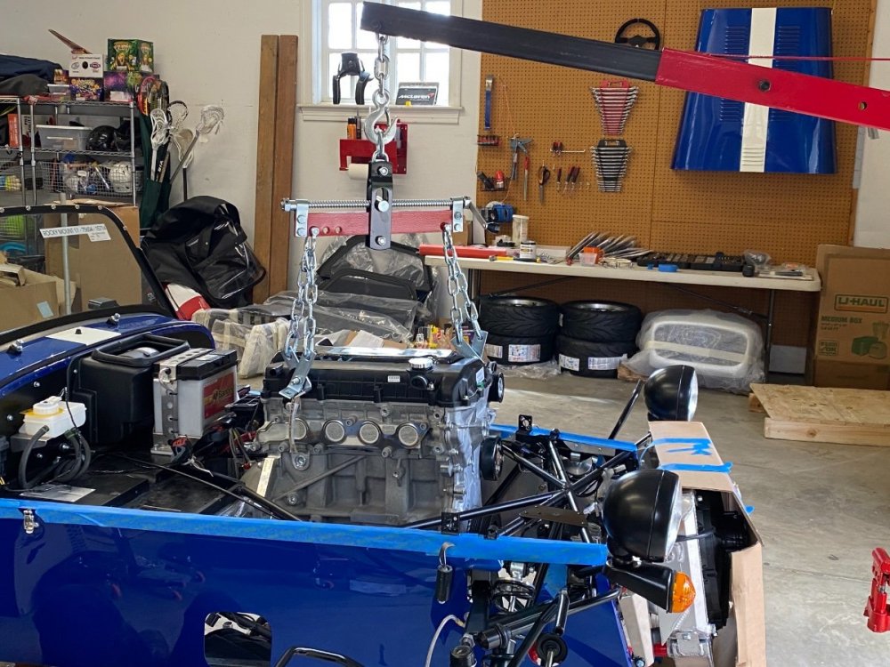

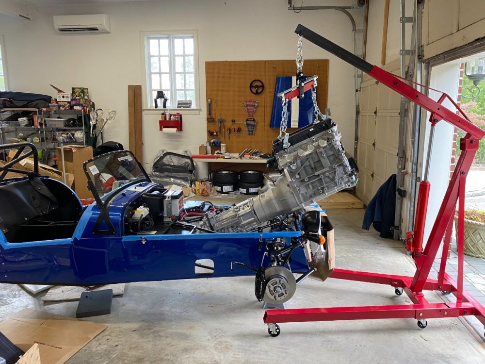

big step- got motor in today (installed diff/drive shaft first). Managed to remember to get transmission mount in place before trying to install.
So far, I have spent more time trouble shooting / finding hardware vs actually building. When I’m building, the progress is fast.
Can’t possibly overstate how helpful Josh is at Rocky Mountain Caterham.

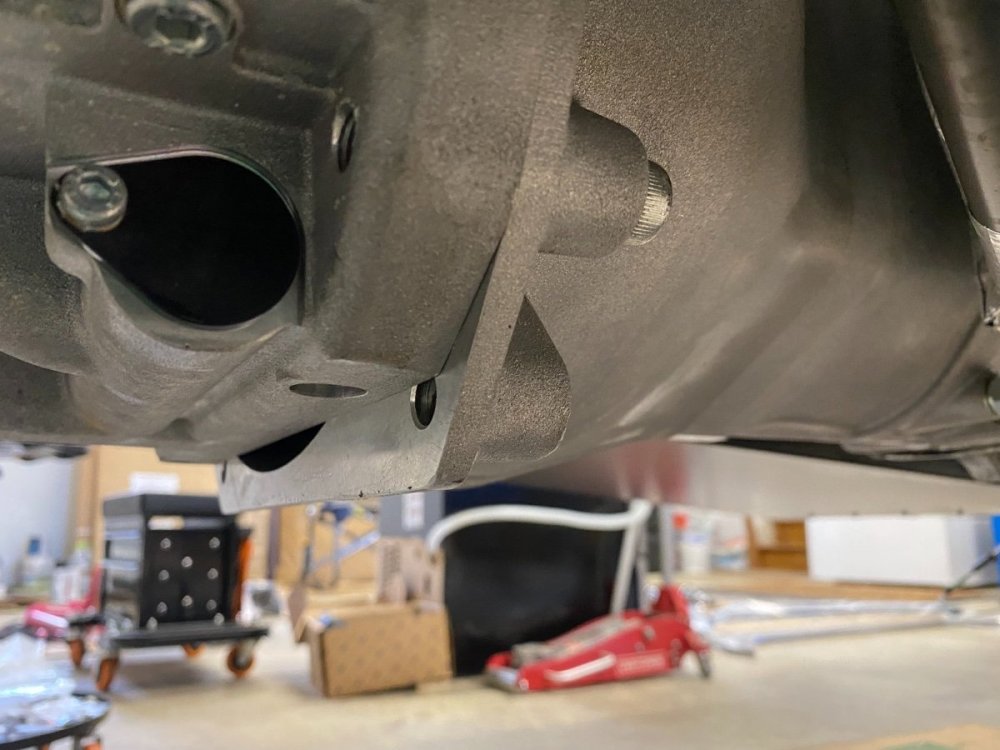

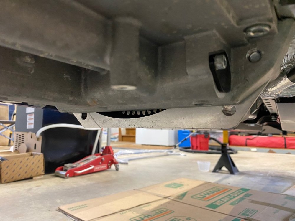

I’m a little freaked out that bell housing doesn’t mate up to transmission cleanly…
waiting for response from Josh…. Think there might be a piece that goes in front? Not full panic, yet.
6D1F8BF1-3B32-4130-9AD1-A17847DDF230.thumb.jpeg.efad0aa2ffb7f014aab8d2dbdca9f5e7.jpegC0B8E074-E322-4B54-9269-AD99DE8C9EFE.thumb.jpeg.6edbb8c50e1c7e85ccb5d8d93adf652b.jpeg5B63A8E5-5338-4932-9C9E-9F08265D72E0.thumb.jpeg.d455ff83efeb9d8f8fd510b8fdecd12f.jpeg
13 minutes ago, KnifeySpoony said:
the black wedge is the bellhousing guard - that goes right where you're concerned
Should I use some silicone, or otherwise try to seal it off from the elements?
I did not, and I don't think you'd want to; you will want to remove it for oil changes - when you take off the cover for the finger filter, the oil will drain and get all in between the guard and the sump. Taking the guard off allows the oil to drain cleanly.

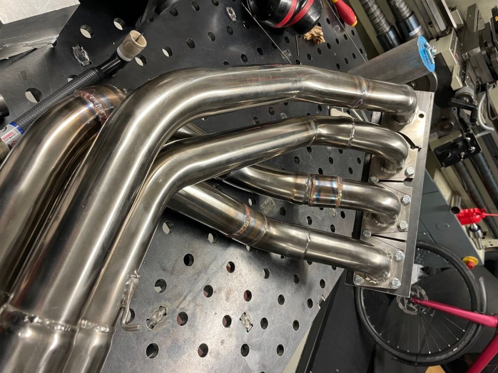

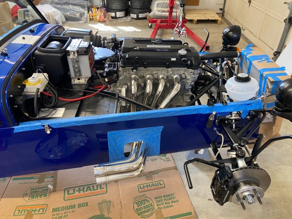

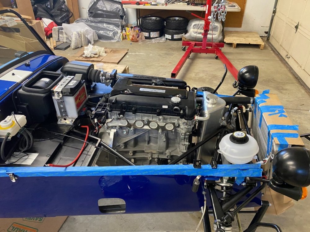

Read that I was supposed to install exhaust headers- prior to- installing dry sump. So, happily I had only set that in place, needing to go find the proper hardware.

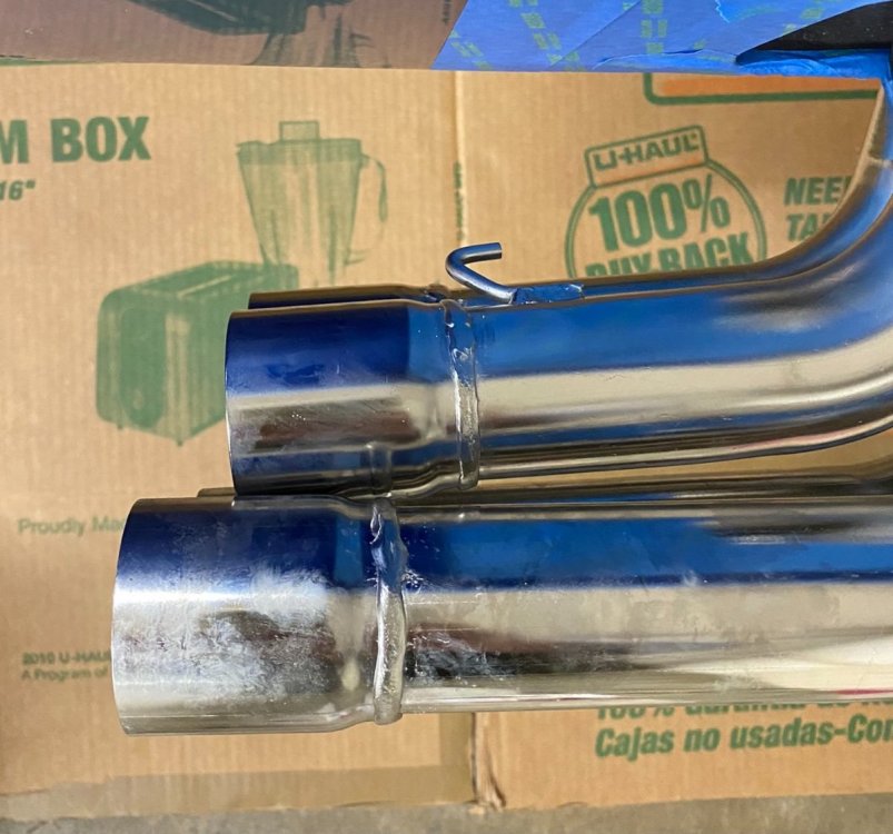

So, I just fitted them up, barely held in place for now. Seems I should bend the headers a bit to the rear to get more clearance?

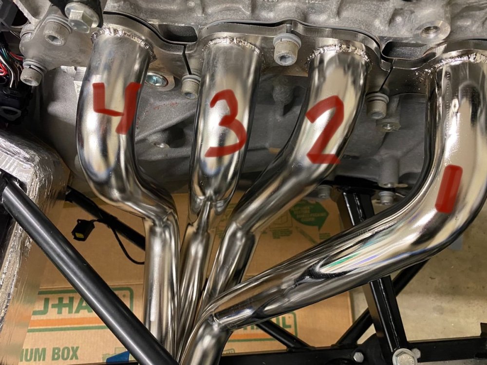

(for those wondering, the sequence is 4, 3, 2, 1 from back of the engine working forward. There is only one way they will all fit / not labeled).B97CAB77-AC59-41FD-B633-8C615871C55A.thumb.jpeg.1890bd48bd1c0d03ec759e6a681058f0.jpegB1BA99F6-F0FB-45FB-82D2-018F32D18EA8.thumb.jpeg.ee25950b321a4b404aed83ed14e410cc.jpeg
Edited by sainthoo

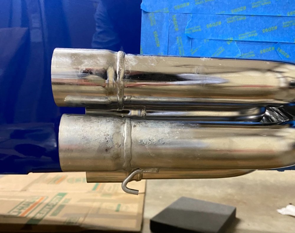

Bending headers isn’t an option, it is just not possible with home equipment. I helped this weekend another 7 owner fit some old headers, that were not a pair - we had to cut and reweld.
Looking for ideas on the headers.
I have the engine tightened down with the engine mounts and the transmission mount tight as well. The alignment looks good to me (drive shaft/transmission look evenly spaced/ aligned in tunnel). I consider shimming the left side engine mount, but that seems like an extreme/unwise solution.
Here are a few more pics if someone spots a problem…
1 and 2 are pressing hard against 3 and 4 (so I feel like there is something off with 3 and 4?).
Suggestions welcome. I feel like I need to sort this before doing anything else with plumbing, etc.
35C6E640-5083-44B0-A247-BCAB65DCDB7F.thumb.jpeg.f05282ff2f0973a3e1d7c0788d0ad9c7.jpeg2E8C1B4F-4706-4183-90EF-0BE87854F24E.thumb.jpeg.415a5c30b571685af0dd0104cbf425ff.jpeg2EEDA2AD-A993-46AF-A9E5-1BCD5A7681DB.thumb.jpeg.f788b9c55b3c4720f404796ad13e920a.jpeg
Edited by sainthoo
Well, your primaries aren't fastened to the engine yet. I would start there? Or does fastening them make the alignment worse?
Tightening would make it worse. As it is now the bolts toward the front are more loose (allowing some backward angulation).
Hmmmm... I guess we could establish some dimensions. Maybe make sure the cutout in side skin is right location (although I'm not sure how a mistake like that could be made). It seems odd that all 4 primaries would be bent incorrectly about the same amount. I'd look to engine position and exhaust cutout.

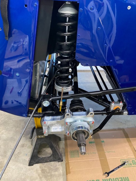

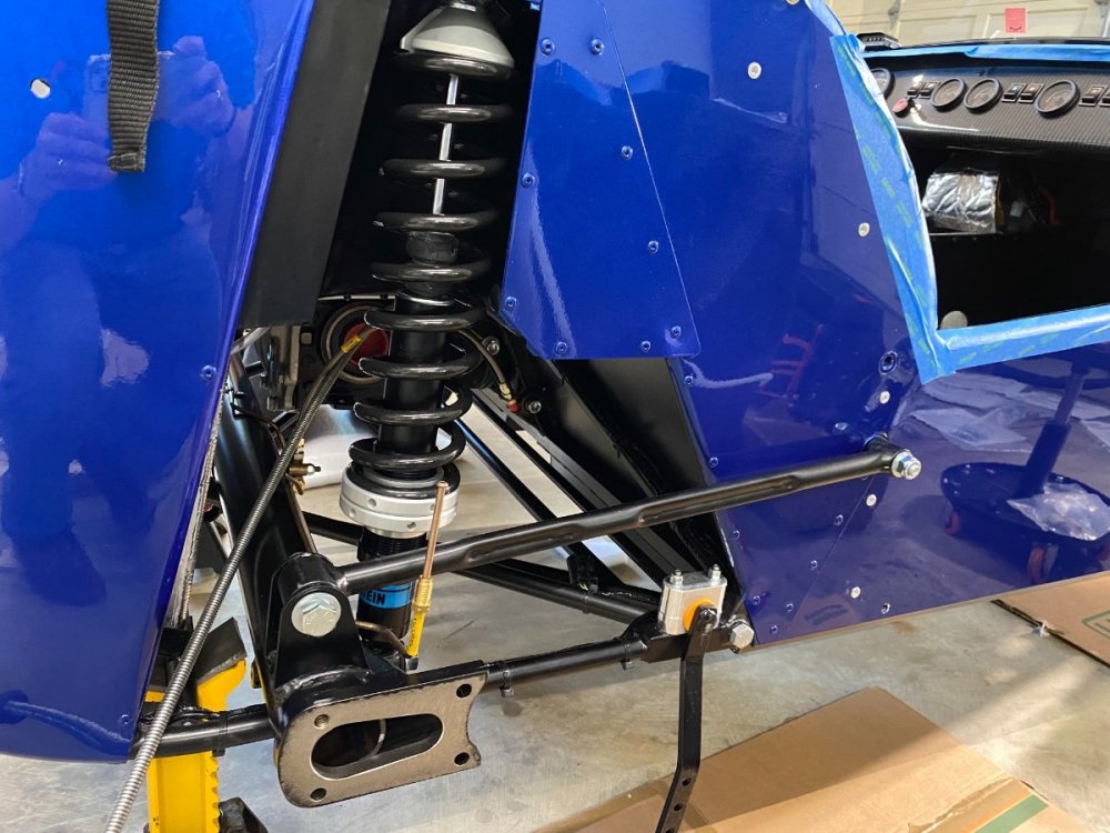

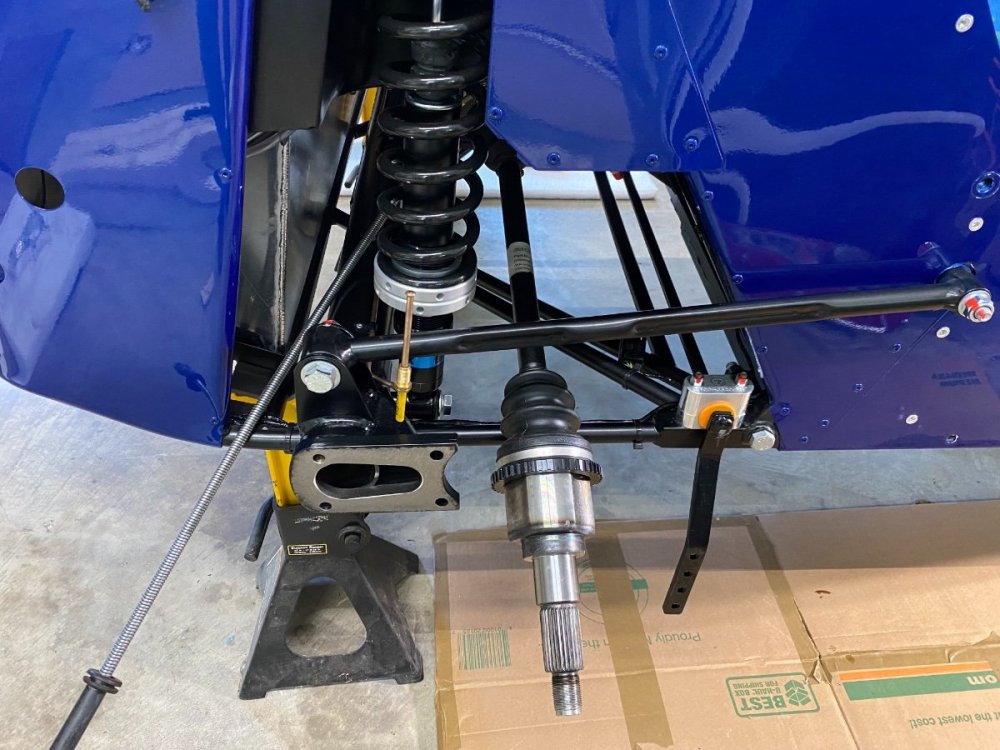

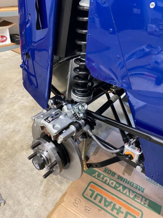

Had a day off today- so tackled the rear suspension, which is now done. As has become customary - spent as much time finding parts/ figuring out what to do as much as actually doing stuff. Getting handbrake cable onto the second caliper was a bit of a chore.

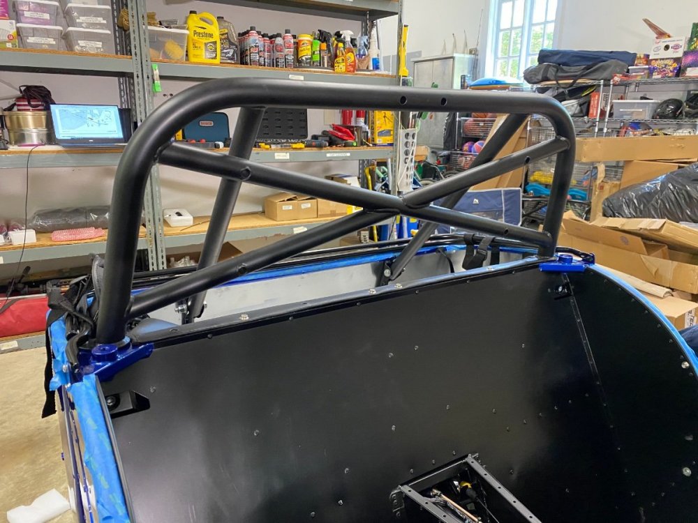

** for anyone reading/considering a build** roll bar must be installed BEFORE rear suspension (no way to install cage with spring/damper installed)89D0B91C-B1BB-4ABA-88E6-0EBF67981F68.thumb.jpeg.78e1f04cde8ed244071fc132398091de.jpeg
After that, then rear suspension.
