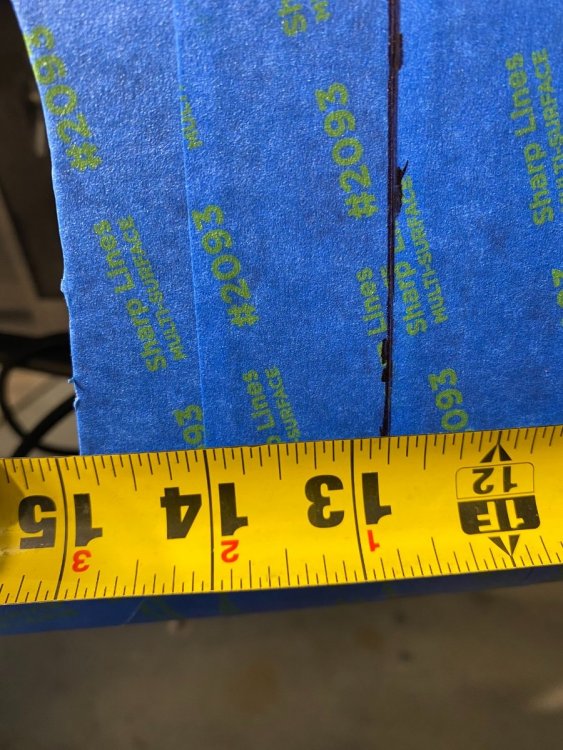

Edit #2: Caterham cut the opening in the wrong spot for the SV…. This should be located 13.625” from front wishbone.   …. At least I’m not crazy…. Now to get to a solution.

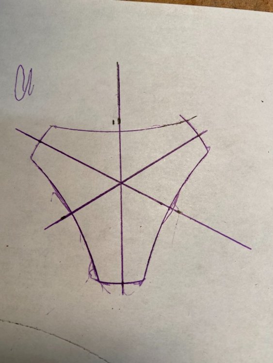

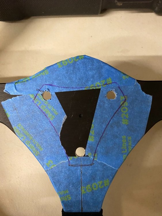

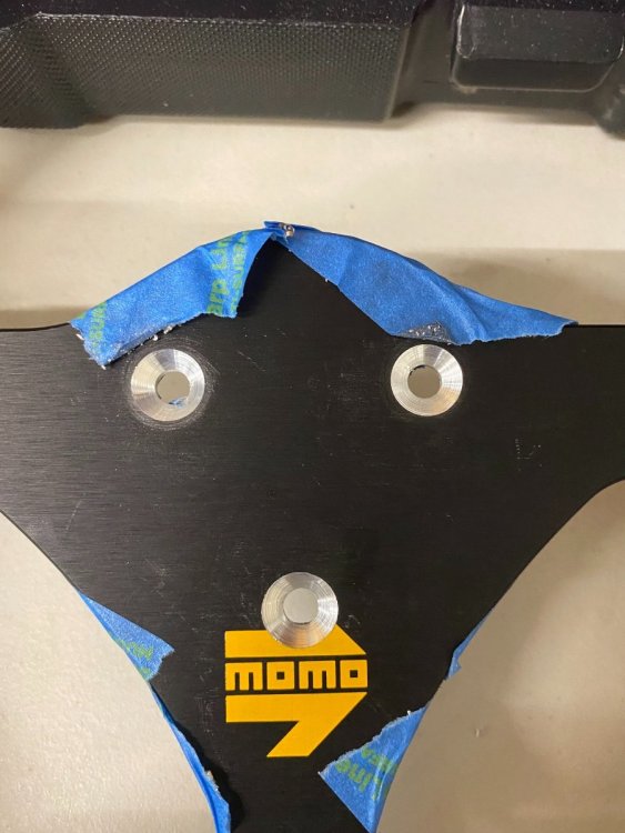

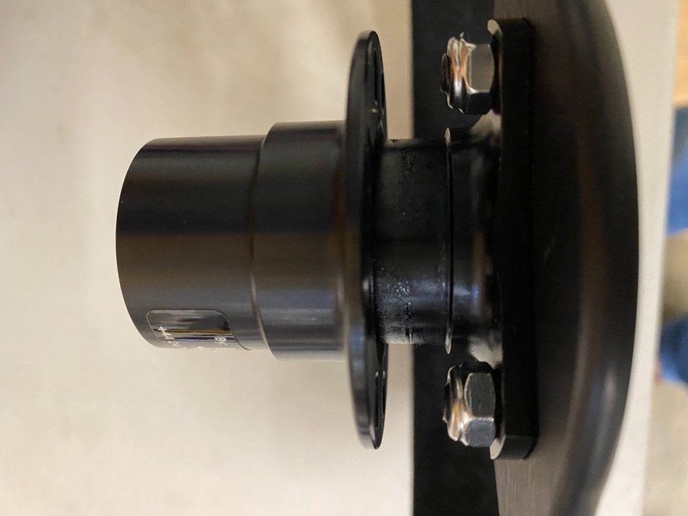

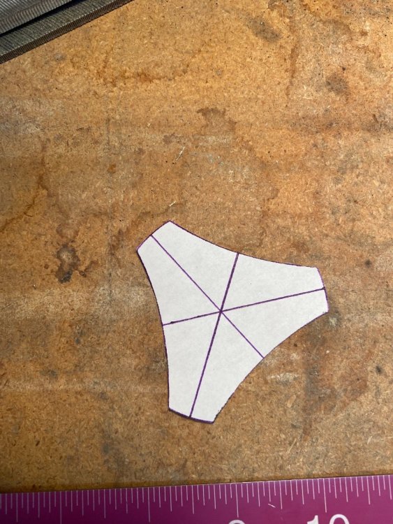

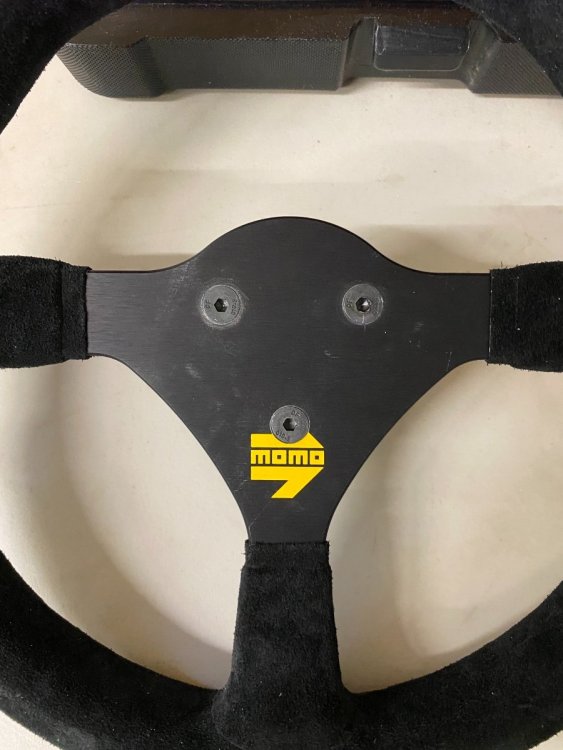

Steering wheel for those that want a pictorial (I am a rank amateur- so take that into account)
template- traced release hub, measured center points, drew lines to find center:
Nail through paper into divot to line up.
Drew a center line on wheel, lined up with my template.
Then, I drilled and fitted the center spoke. Fitted hub with bolt/nut, then centered the next 2 holes with punch, removed hub, drilled next 2 holes. (I started small, worked my way up in 3 successively larger holes)
Counter sunk side facing driver to make bolts flush. Nylok nut, making sure there is clearance for releasing hub (don’t use a bolt that is too long).
A7A9CC98-14F5-45BA-940E-B9A836B61273.thumb.jpeg.a0d19bf6aaa5c308b50033cc47068a73.jpeg66B70D9D-F6C1-4532-91F1-6D78FC25975F.thumb.jpeg.c74023cf26d2be0235916669f94f24c4.jpeg52D54CFE-387F-4E90-8291-EBF7C92082DB.thumb.jpeg.430495987ef55f442c31e08ca8d5e483.jpegAE52E387-7AF4-4C39-907D-D1F293C3090A.thumb.jpeg.dd1e9991ea567980e4312080842dec70.jpeg57F39E64-441C-4C5F-999F-7F5100DC9E34.thumb.jpeg.6881c02ed875e049f32aaa3c5106e65a.jpeg

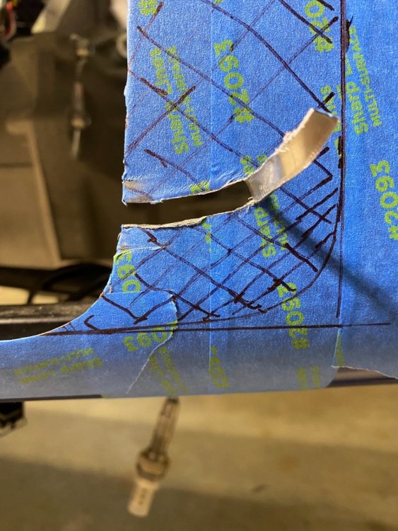

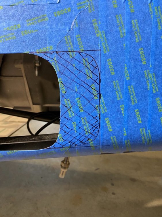

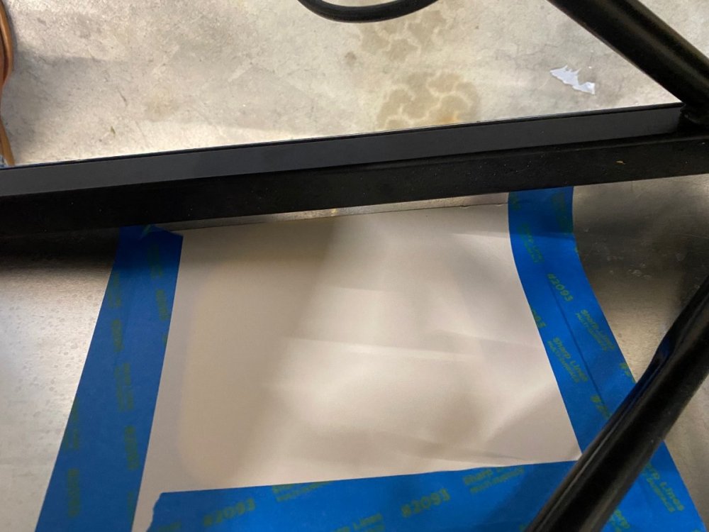

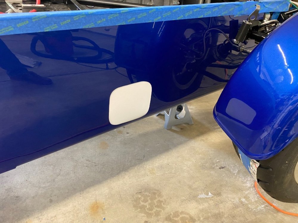

Made my template of the factory opening for headers. Then, I measured 2” forward, applied tape, applied template, marked area to be removed.
(chose 2”, as I’m going to try to make the fore and aft gap more symmetric-  will further minimize gap discrepancy with trim ring as ring does not have to fit to edge of the body- cheat in a bit on aft edge).

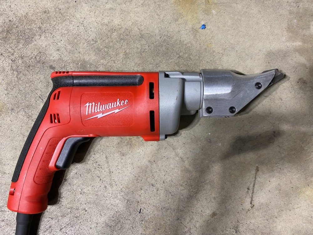

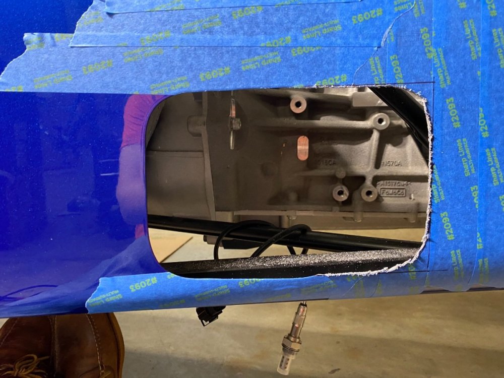

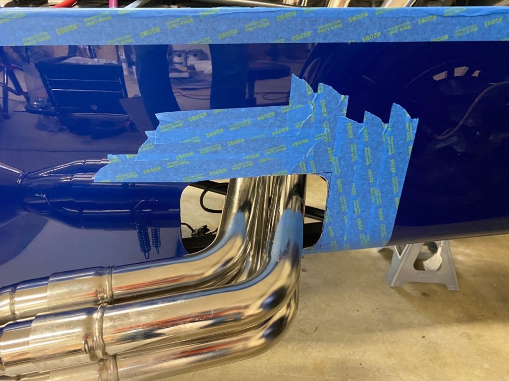

Lord help me, I did it.
First, I tried shears- straight cut, but way too fast, more difficult to turn than I was comfortable.
FCA5323A-18F3-4A1B-B5C1-5104620C608E.thumb.jpeg.940a57daa8f4198f09e8aba93678eb71.jpegA50B3004-ACB4-4E20-BBF9-133B94B295C6.thumb.jpeg.b225366b34b0b0382e29dc03e7f178d9.jpeg

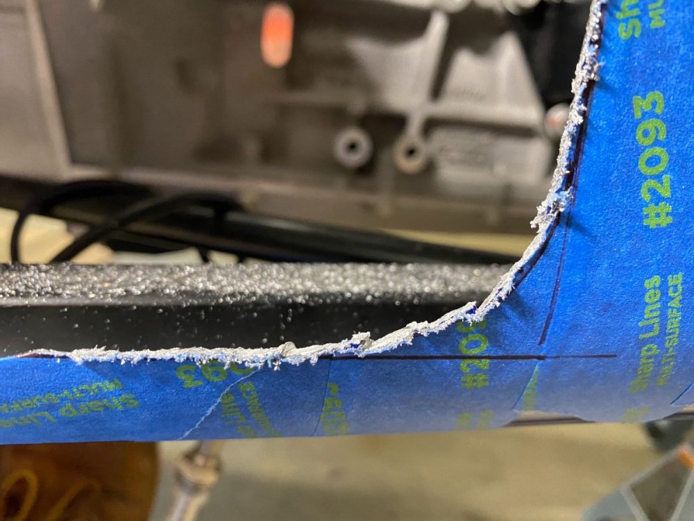

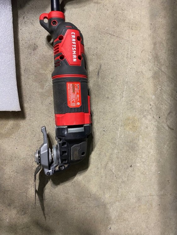

I then tried this metal cutter that fibrates really fast (same as a bone saw). Not as pretty, but more controllable. Figured I would just clean up the edge afterward.
44E4F52D-671E-4186-8164-0C27E3E9949E.thumb.jpeg.5bb4fe9e318dfb3bd049bbccd2aaea0d.jpeg64485C60-6435-4F5C-B070-088674A96394.thumb.jpeg.af5e835d5b3658577a3b11497a1ef87d.jpeg
Hole cut:2A128648-9742-42F4-AA8D-D2676B14AE2A.thumb.jpeg.a2142c6410bf2e0fd6a8e7e3839d47b3.jpeg

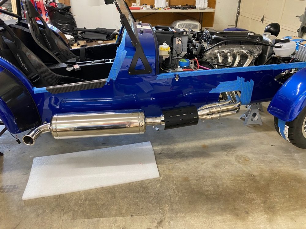

Hole cleaned up, headers installed- Finally!
Exhaust finally on the car:
Edited by sainthoo

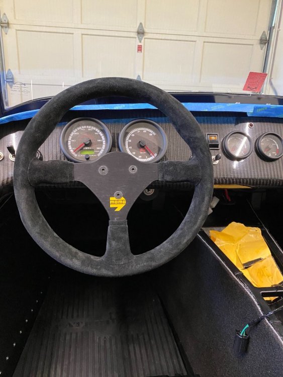

That Momo steering wheel seems quite large, is that from Caterham?
Yes, not very large at all in person (about 11” diameter), probably camera distortion.
Is it a factory wheel? The factory wheels are 260mm I believe. Mine came pre-drilled as well.
All I know is it came on the giant pallet of stuff with the kit- not drilled (me not thrilled about that).
i definitely would not want it any smaller.
edit: I do have some random extra brake line, don’t have a fuse box cover, etc. So, who knows what wheel I have?
