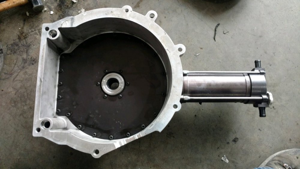

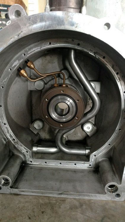

KnifeySpoony Posted July 4, 2025 Posted July 4, 2025 Having read a bit about the CSR oil level issues, I still don't understand how the total oil amount in the system is so hard to determine. With the engine running, don't the scavenge pumps deplete the oil in the sump and fill the oil tank? I get that the bellhousing mounted tank is different than the tanks on 420R and 620R, but why doesn't the tank "fill" while the engine is running, which can then be checked in the tank? Is it a matter of the oil settling so quickly back into the sump out of the tank once the engine is shut off? Can the oil level in the tank be checked with the engine running (this can be done on my 420R btw)?
Croc Posted July 4, 2025 Posted July 4, 2025 27 minutes ago, KnifeySpoony said: Is it a matter of the oil settling so quickly back into the sump out of the tank once the engine is shut off? Yes - exactly that. Also don't forget that the only point of access to the dry sump tank has a driveshaft through the middle of the sounding point. So you can only test the level above the driveshaft which is notoriously inconsistent in my car because the oil goes hiding around the system. I can lose 2+ quarts in the system when I do an oil change as I measure what is taken out and compare to the dry capacity (which is known). My method is clunky but it does ensure safety of engine. Oh if you open dry sump tank while engine is operating you do get covered in oil - it splashes and breathes heavy. Took a while to clean me and the car up when I tried it exactly once.
wdb Posted July 4, 2025 Posted July 4, 2025 (edited) 29 minutes ago, Croc said: Oh if you open dry sump tank while engine is operating you do get covered in oil - it splashes and breathes heavy. Took a while to clean me and the car up when I tried it exactly once. Ugh! That's not much of a sump tank. The one I put in my 7 is a swirl chamber for the first half of its height. Taking the cap off lets one watch the scavenge pump output glide around the sides. EDIT: Oh I see now, looking further back the thread. Quite an, errrr, interesting design. Edited July 4, 2025 by wdb
KnifeySpoony Posted July 4, 2025 Posted July 4, 2025 Seems an odd/dumb design... Can you just change to more traditional dry sump tank layout? Pop in the nice triangular tank up front? Or the rear mounted 620 tank? Seems like it almost might be worth the faff.
Croc Posted July 5, 2025 Posted July 5, 2025 Remember the CSR chassis is different to the regular SV chassis. So there are tubes in the way of doing the traditional dry sump tank up front of engine behind the radiator. The 620 rear mounted tank is daft - not a fan of that design. Adds weight and messes up your weight balance. I use a similar approach in the BMW CSL (because the trunk is the only spot for 15 gallons of oil) and the volume of hot oil running fore and aft is ridiculous plus a safety issue. The CSR dry sump tank solution is quite ingenious for compact packaging while not messing with the weight balance front/back. It follows from open wheeler and sports racer solutions. However, it is not designed to be as easy for consumers with road cars.
