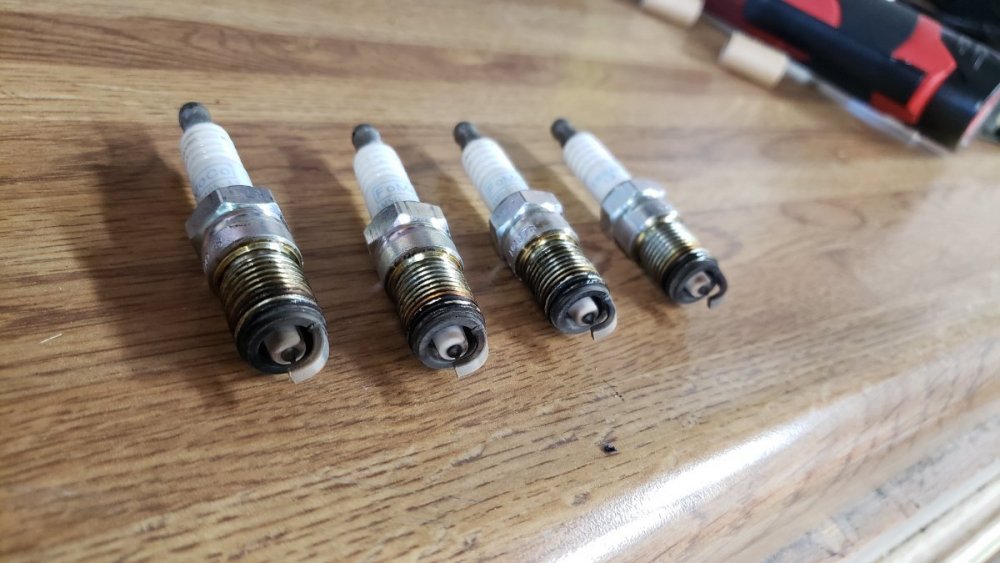

Croc Posted June 12, 2022 Posted June 12, 2022 One other thing - when you took your first set of plugs out did the tips show evidence of running rich or leaning out? I am expecting you should see them fairly clean but would like to confirm.
KnifeySpoony Posted June 12, 2022 Author Posted June 12, 2022 Here are the original plugs - they look ok to me
KnifeySpoony Posted June 12, 2022 Author Posted June 12, 2022 (edited) Here is the new set. The one on the left is the rear cylinder (pulled a day after driving, otherwise I assume that is the wet/dead cylinder?) Edited June 12, 2022 by KnifeySpoony
KnifeySpoony Posted June 12, 2022 Author Posted June 12, 2022 Maybe the consistent miss on the rear cylinder with the BR7EFS plugs is a blessing for diagnosis? ie, maybe should put them back in then do some troubleshooting. ie switch plug position, then coil position etc? Will datalogging show cylinder misfires?
