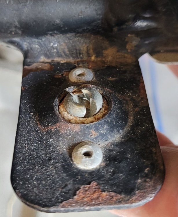

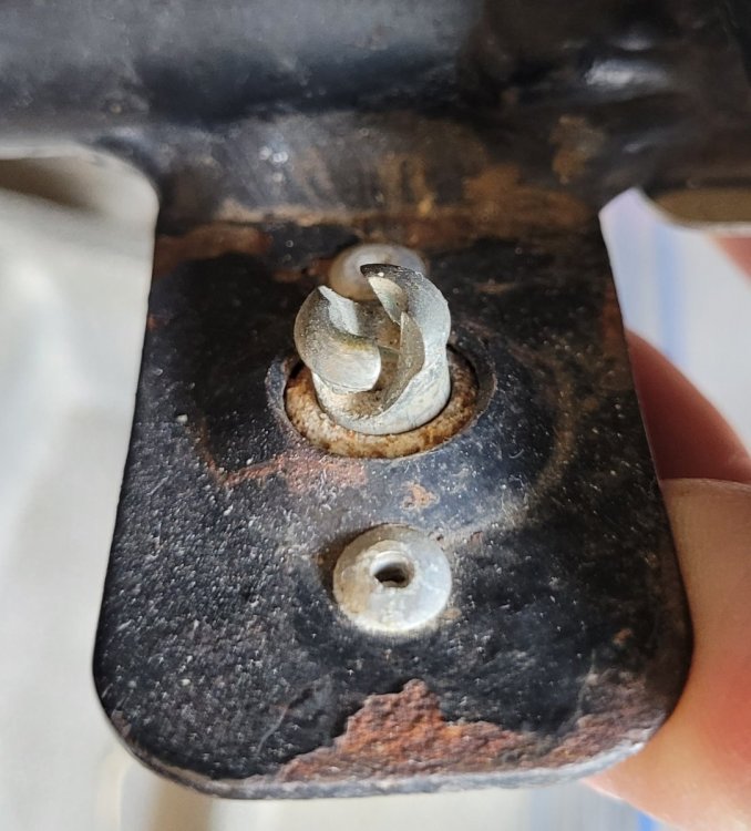

I’m checking my car (310S) prior to starting it after winter, first time removing the nosecone, and both lower Dzus bolts are missing. Can I replace just the bolts?

I’m not familiar with newer cars but on my 1995 the bolts are attached to the frame for the bottom fasteners. The “S” springs are on the nosecone. The top fasteners are the opposite, more or less.
I'll assume you want one of the aftermarket fasteners which are similar to the aviation type but are measured differently for ordering.
Generally, the aftermarket self-ejectors are not offered as individual components. If you want to replace just the fastener (no retaining groove for the ejector type snap ring), for the shank size, using a six inch dial caliper, measure the center hole size in the plate or find a known size bolt that is a little smaller in shank size. There are also metric fasteners available.
For the "grip", with the dial caliper, as you open the jaws with the thumb wheel, a rod extends from the square, far end of the caliper. With the nose installed and pressed inward toward the chassis mounted fastener spring wire, place the far end of the caliper across the plate (not over the rivet area) and extend the rod to touch the spring wire. The "grip" ordered will be the first grip length size LESS than this distance. They tend to come in bags of 10 so keep some in a glove box. The spring is pulled out of position by the fastener to hold the panel and prevent falling out from driving.
Self-ejectors also come in different grips and may have different rivet spacing. I think the spring wire thickness is fairly standard/universal.
Thanks for the helpful advice. The one thing I don’t want to do is remove the rivets and replace the whole fastener. Wonder what happened to the bolts?

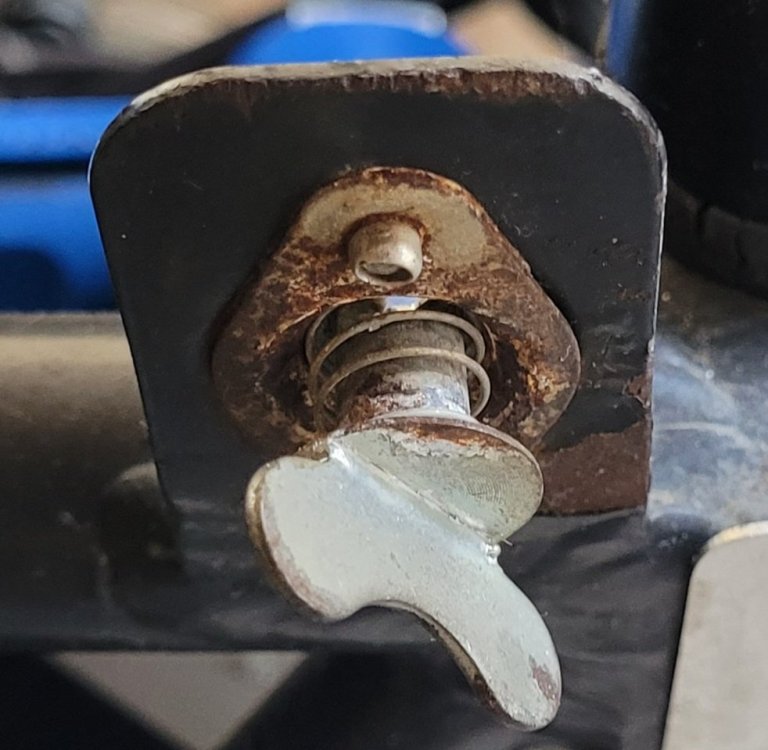

Here is what happens after years of neglect and why Im recommending stainless here.
Also,  although your Dzuz are reversed in order, the captive concept is the same.
Your screw should not have fallen out unless there was a constant pushing force on it for a long time.  If they had released from the S springs or were never fastened to begin with, its possible they could have been worked through the holes.
The winged screws are my addition.  I drilled out the old rusty flush ones and riveted these in.  Its really easy.  You're working on fiberglass so make sure the rivits are light duty aluminum.  You gotta know how to rivit if you own a seven.20230401_105843.thumb.jpg.51d875c08ff6471b82021d1c47dee97d.jpg20230401_110024.thumb.jpg.5f96c1714908ccb6bc21dbfd5303bd14.jpg20230401_110027.thumb.jpg.06ab9625fbe7afb0244413576de6ecb1.jpg

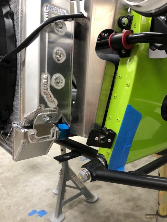

Here is a way to add adjustable side mounts without welding. Also, Skybolt makes very nice dzus type fasteners.
Edited by MV8

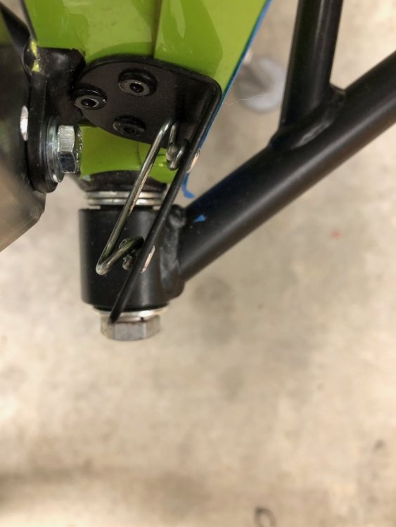

Drew spring on the wrong side of the bracket plus the cat brkt is better/lighter.
Wow, the idea of being able to operate all four Dzus fasteners without getting underneath the nose is really appealing.  Thanks for posting.
