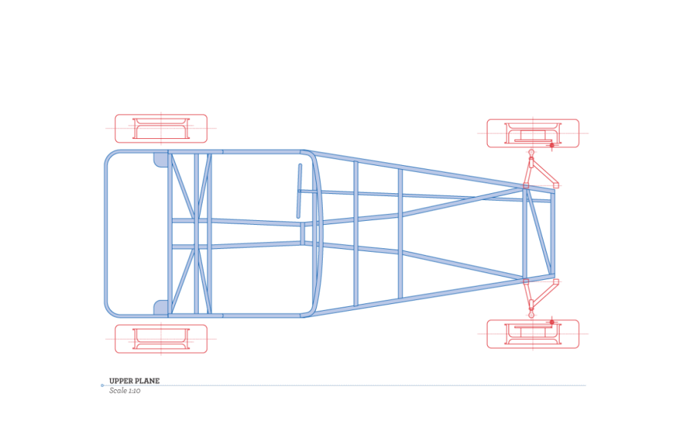

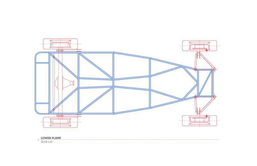

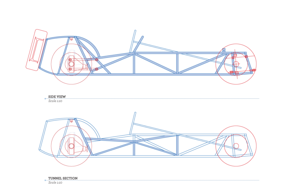

anduril3019 Posted May 28, 2023 Author Posted May 28, 2023 Design intent is for a somewhat traditional build, styled similar to Series 2/3 Sevens from the mid to late 60s. Engine: Cortina pre crossflow, tuned as budget allows. Mainly want to get it on the road! Transmission: Cortina or Pinto 4 speed, standard ratios. Have both, not sure which I'll use yet. Front Suspension: Triumph uprights, Lotus lower wishbones, custom upper wishbones, anti-roll bar, Triumph steering rack. (Wishbones courtesy of Xtra Special Sevens) Rear Suspension: Cortina axle, trailing arms, Panhard bar. Wheels/Tires: Cortina GT, steel, 13 x 4.5, 175/70-13. Frame design is a hybrid of the plans, mods, and specs floating around online. Stretched a little so I can fit "comfortably."

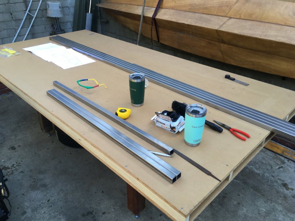

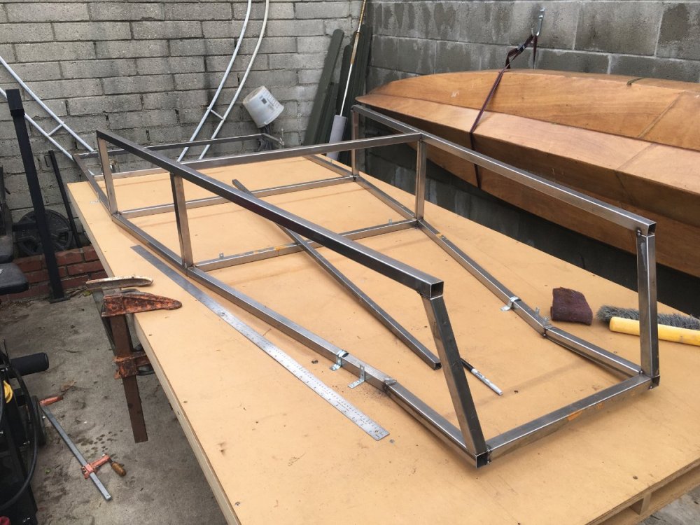

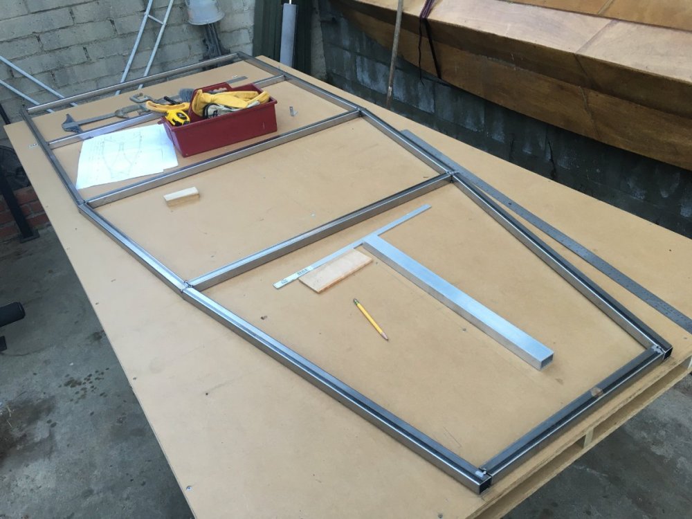

anduril3019 Posted May 31, 2023 Author Posted May 31, 2023 Build Table and First Tubes Table is built from 3/4" MDO and 1 x 2 poplar ribs. It lives outside, the MDO has held up surprisingly well and the surface is nice to work on. Not much rain to worry about in California, but it did get caught uncovered in a couple of storms and still remained flat through the crucial build stages. It's about 2 years old now and has about an 1/8" droop over its length, but is still usable as a level work surface. On hindsight, I'd make the section taller, but it's worked well as is. After a lot of planning, the first few tubes have gone in place. 2
