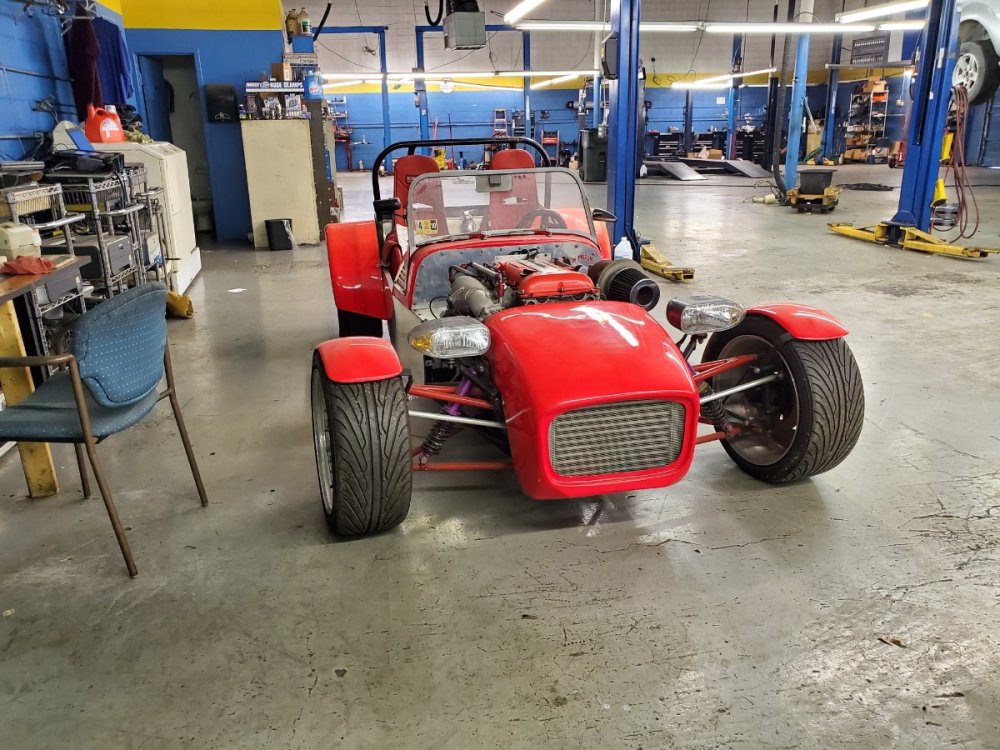

JohnCh Posted July 18, 2023 Posted July 18, 2023 I see you practiced restraint when choosing the engine -- that turbo looks bigger than my steering wheel! What are the specs? Cheers, John
Bob Drye Posted July 18, 2023 Author Posted July 18, 2023 3 hours ago, JohnCh said: I see you practiced restraint when choosing the engine -- that turbo looks bigger than my steering wheel! What are the specs? Cheers, John The turbo is a BorgWarner S300
Bob Drye Posted July 18, 2023 Author Posted July 18, 2023 SR20DET CP 8.5 pistons, Eagle rods, Mild porting, Electromotive Tech GT stand alone, 74 lb injectors, Gretty intake, SR20DE cams.
Vovchandr Posted July 18, 2023 Posted July 18, 2023 31 minutes ago, Bob Drye said: 477 hp @21 lb boost 93 octane pump gas. Jesus 2
FE07 Posted July 18, 2023 Posted July 18, 2023 Well that should be QUITE the interesting ride!!! Traction control??
MV8 Posted July 18, 2023 Posted July 18, 2023 Nicely put together. Back story? Looks like dwarf car inspired ifs and custom spindles with a standard racing cross flow radiator (22x19 originally?) turned vertical, cut and shut.
panamericano Posted July 18, 2023 Posted July 18, 2023 If you can get enough tire on it, this should be the only 7 with wheelie bars out back.
Bob Drye Posted July 18, 2023 Author Posted July 18, 2023 I'm 76 and have Parkinson's so this is my latest handicap vehicle. 1 1
Bob Drye Posted July 19, 2023 Author Posted July 19, 2023 Mustang axle stubs. Wilwood 2500 lb front brake kit. Dwarf car wilwood rear brakes. Full midget 2 pass radiator. Custom intercooler. 1131 lb with 8 gallons of gas. 2
