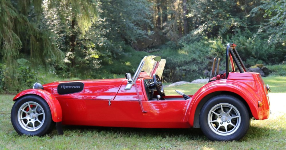

Cueball1 Posted August 14, 2023 Share Posted August 14, 2023 (edited) I recently saw a car for sale but cannot find it again. 😑 Owner had developed a sort of v shaped acrylic wind deflector. In the discussion of it he mentioned he tried several different variations. He finally landed on a long v from the top of the windscreen following it down then swooping at an angle backwards after reaching the body. Said this long version was much more effective. He even had a name for it which I've forgotten. In selling the car he mentioned they would not be included for liability reasons. Anyone have experience with something this? Any other effective methods found for decreasing wind and pressure in cabin and increasing comfort? Edit: found it! He called the Vaccaro wings. anyone have any experience with something like this? Ugly but if effective... Edited August 14, 2023 by Cueball1 Link to comment Share on other sites More sharing options...

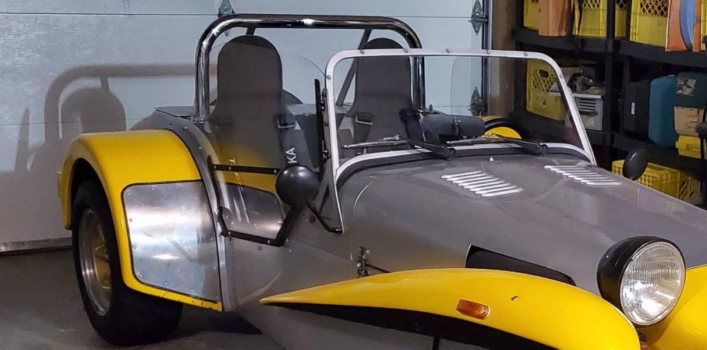

JohnCh Posted August 14, 2023 Share Posted August 14, 2023 I experimented with this quite a bit on my Westfield prior to the USA2005 tour. The key was angle and length. These two photos show both: Ugly? Yes. Even worse aerodynamics? Yes. Effective? Absolutely. With the wind wings in place, turbulence is significantly reduced. Much closer to running with side curtains than to running without. A caveat is that each type of se7en is different. In my experience, the Westfield without wind wings is equivalent to a Caterham S3 with standard floors. However, a Caterham SV with lowered floors is a bit better. If you want to go down this route, my suggestion is to make mockups from wood (I used 1/8" hardboard and sections of 2x4) and find the angle and length that work best for your particular car. Once I had the final combo, I supplied that wood template to a shop that does Plexiglas work and had them cut and bend them from polycarbonate to match. -John Link to comment Share on other sites More sharing options...

Croc Posted August 14, 2023 Share Posted August 14, 2023 The simpler variation I did a long time back was take the standard Caterham plexi wind wings and bend them further in boiling water. This has the effect of making them stand out from the car further and shift the buffeting point rearwards past my ear. Not as effective as John's but a lot simpler to do. A variation of that theme done by someone else was to glue a plexi post (with a rubber end cap for the body) onto the Caterham wind wings and push them outwards. Link to comment Share on other sites More sharing options...

Frankie Posted August 17, 2023 Share Posted August 17, 2023 Contact Tony. Thats his car in the picture, member name, tvacc. I bought my 7 from him and it came with some small side deflectors that were attached by the door pins. They really worked well for me and they look good. Link to comment Share on other sites More sharing options...

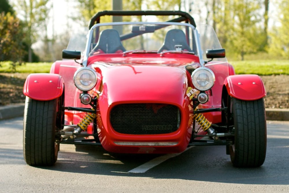

Jesse D Posted August 29, 2023 Share Posted August 29, 2023 I put on Brookland screens. Can't put the top up but completely ended the buffeting and I can wear a ball cap up to 60 mph. 1 Link to comment Share on other sites More sharing options...
