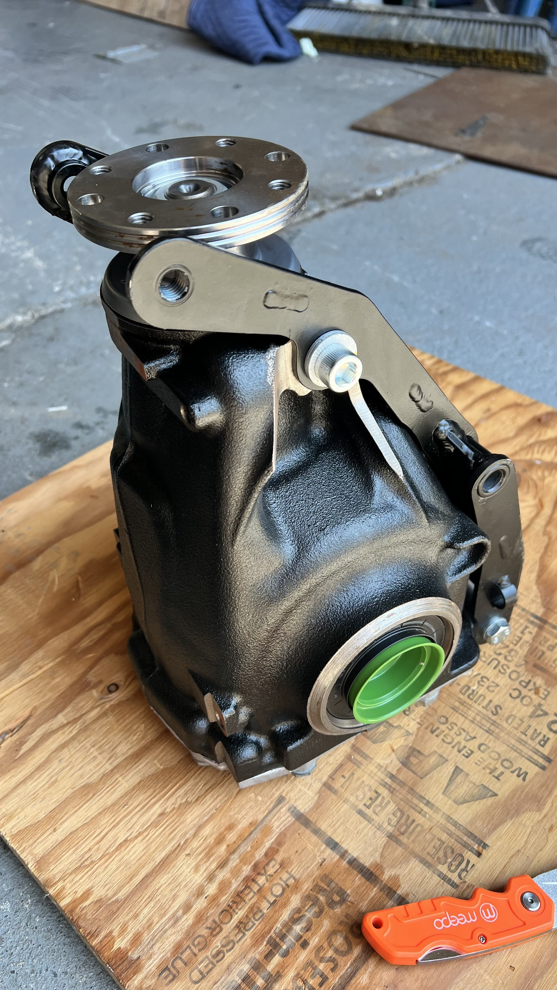

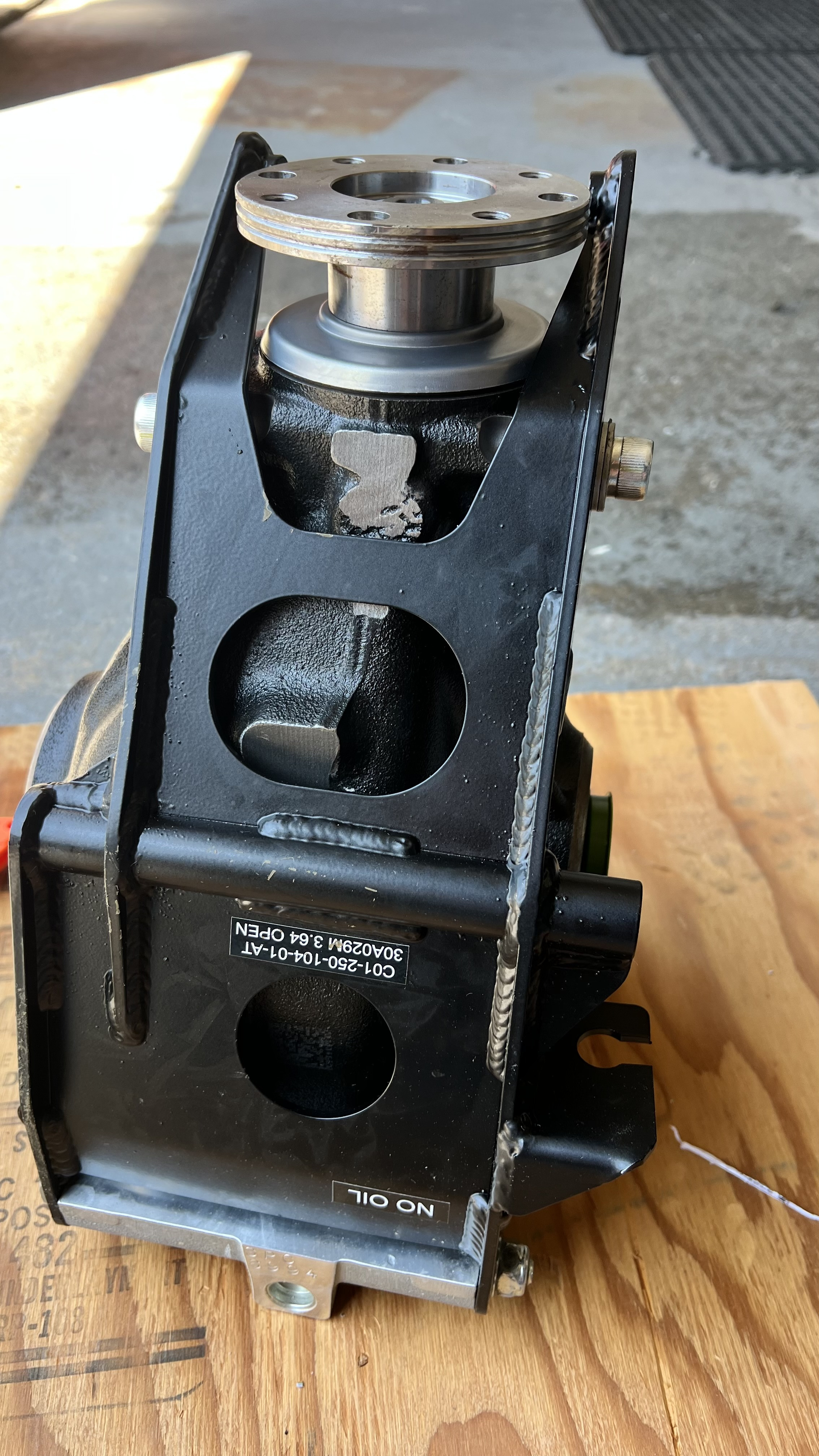

CBuff Posted Monday at 11:56 PM Author Posted Monday at 11:56 PM My 2023 420r with 3.91 rear end and 5 speed (11k miles ). The lsd has started to make a lot of noise. Slow full lock turns sound like it’s coming apart. Pre load is still at 38lbs and the wheel turn in the same direction when raised. the sound makes me think I am living on borrowed time. And I can’t stand the clanking grinding noise anyway. spoke with Steve perks at Tracsport. He is sourcing me a new 3.64 diff from caterham and dropping in a Tracsport lsd and sending me the entire unit. We will see if I have the skills to replace the unit. Money sent late last week. Will see when it arrives.
