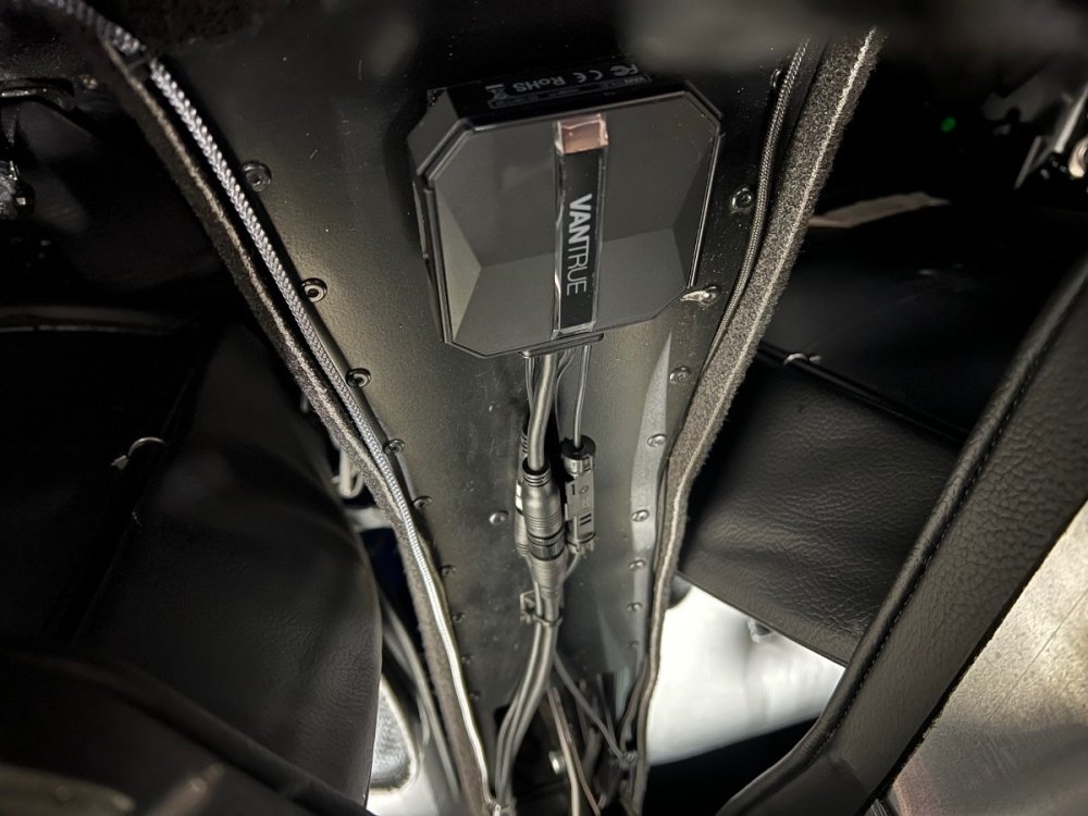

Since you need to pull the sd card to grab lots of footage (you can download certain clips via your phone). I want the main unit accessible but out of the way.  Under the arm rest seemed like a good place again assuming the cabling reaches ).

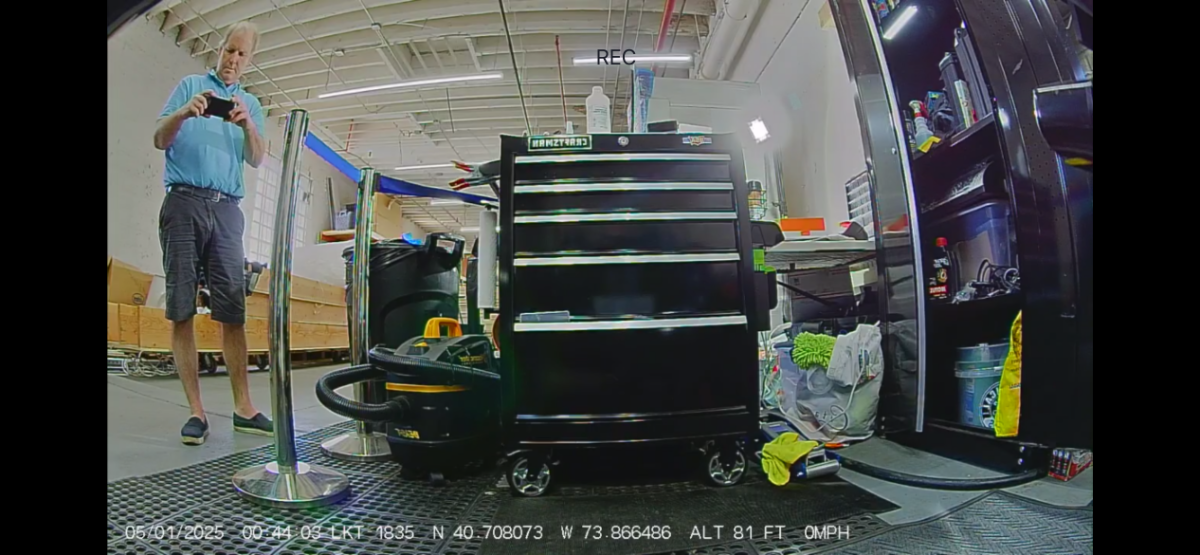

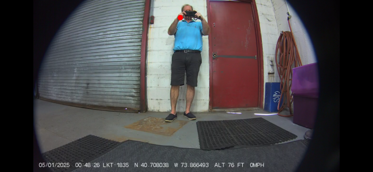

the nail biter part was cutting the hole in the grill. But if I totally jacked it I could get a replacement relatively easy.  For now I just framed it with a 1” rubber grommet.  It works well. The ultra wide angle camera (4K front) does catch a good bit of it into the frame.  But it doesn’t bother me too much. If I pull footage from it I would likely crop and zoom in a bit anyway which would cut that black circle out.  The 4K should allow that.  But again I will use the go pro for the most part for any footage I really want to use. I could enlarge the hole and move the camera further out but for now I am happy with it
image.thumb.jpeg.6ea7be96dee24e026d55edf34fa54629.jpegimage.thumb.jpeg.12c70abd5a951d0437b4e761946f1a92.jpegimage.thumb.png.a199e91c136db374a67cc4d7bf4fb806.png

It’s a new built 420 so the tunnel top is just held in with two screws (which I dont think actually engage any thing and aren’t really needed).  To fully remove it you need to fully engage the parking brake and remove the shifting knob.  But the unit is duo locked down. I can just raise the rear of it without dealing with the parking brake or shifter and slide it out.   No seat removal needed.
that photo of the unit is with just the rear raised (parking brake and shift knob intact).  Sorry the photo is upside down (I guess I need to reread the idiots guide to uploading )
