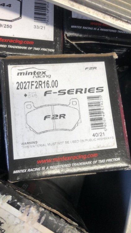

Croc Posted December 16, 2024 Posted December 16, 2024 12 hours ago, KnifeySpoony said: Which pads in the rear? OEM pads I went through in 8 days, so I "upgraded" to Ferodo DS3000 and only was getting 5 days. And one of those sets had catastrophic failure on the 5th day (completely crumbled off of the backplate) My 420R track car has always used Mintex 1144 all round and I am very happy. TFL has been changing its track customers over to the F2R compound. Harder to warm up but once warm they stay strong with little fade. Only one of their customers has asked to go back to 1144. I would not use F2R on street though. Once I go through the current 1144 pads I will try them.
