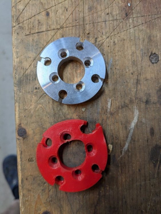

Throttle pulley for the 90mm throttle body. The supplied one was huge and I was only getting about 1/2 throttle. I experimented with sizes until I got just the right movement. The 3D printed one lasted well, it could the 20 min track day sessions were fine, but the 30 min session it started to deform badly. I had to turn it to a new hole between sessions. Finally I sent the file off and had a CNC machined pulley made.
Graham
  • Like 4
It was a Prusa PLA+, nothing special. I believe using some of the newer filaments that can stand high temps it would have been OK.
Graham
Under bonnet temps are pretty extreme for PLA or even PETG.  Some of the major filament makers provide data sheets that include max temp ratings (claims?) before softening that are often helpful in filament selection. There are also some good YouTube channels that regularly test filaments to separate those claims from reality.  If you haven't found this one, I highly recommend it.  He has a PhD in Mechanical Engineering and teaches at the University of Budapest. His filament testing procedure reflects this background.  https://www.youtube.com/@MyTechFun

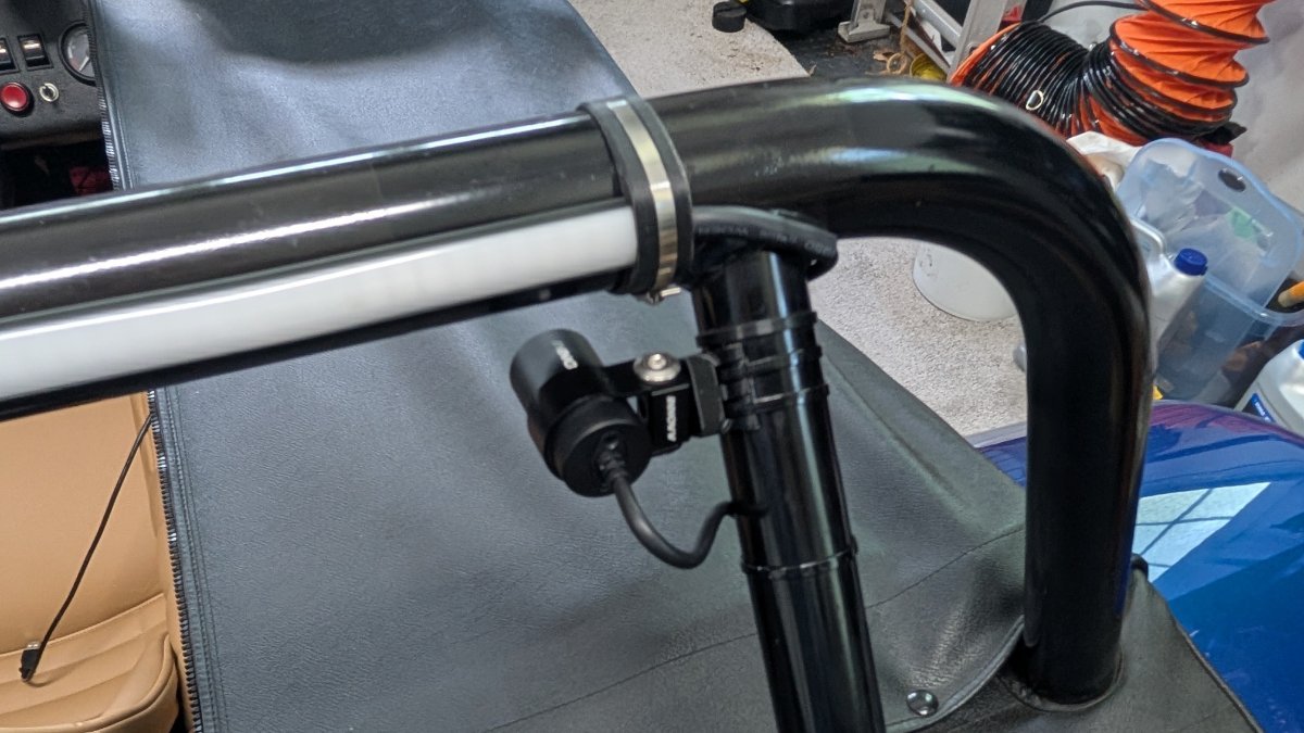

Yesterday I printed brackets for dashcams on the rollbar.  They're working well, secured with VHB tape under the bracket and zip ties slotted in.

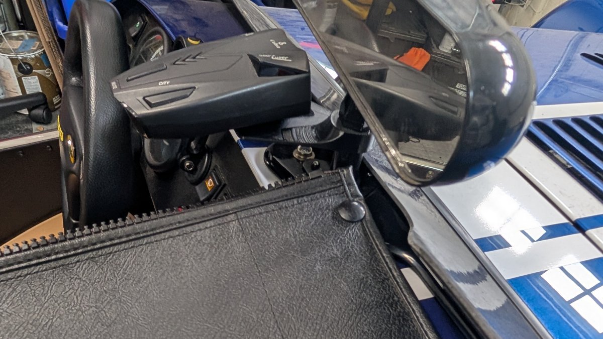

Also made a little tray for a radar detector, mounted on the aeroscreen mirror post.  The detector is secured with Velcro.  The mount works well, but I can't really hear or see the signals so it might not be helpful.

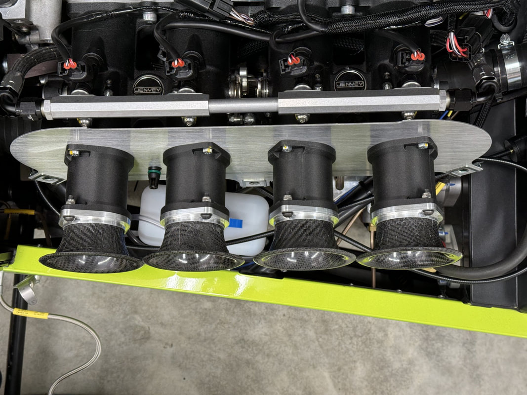

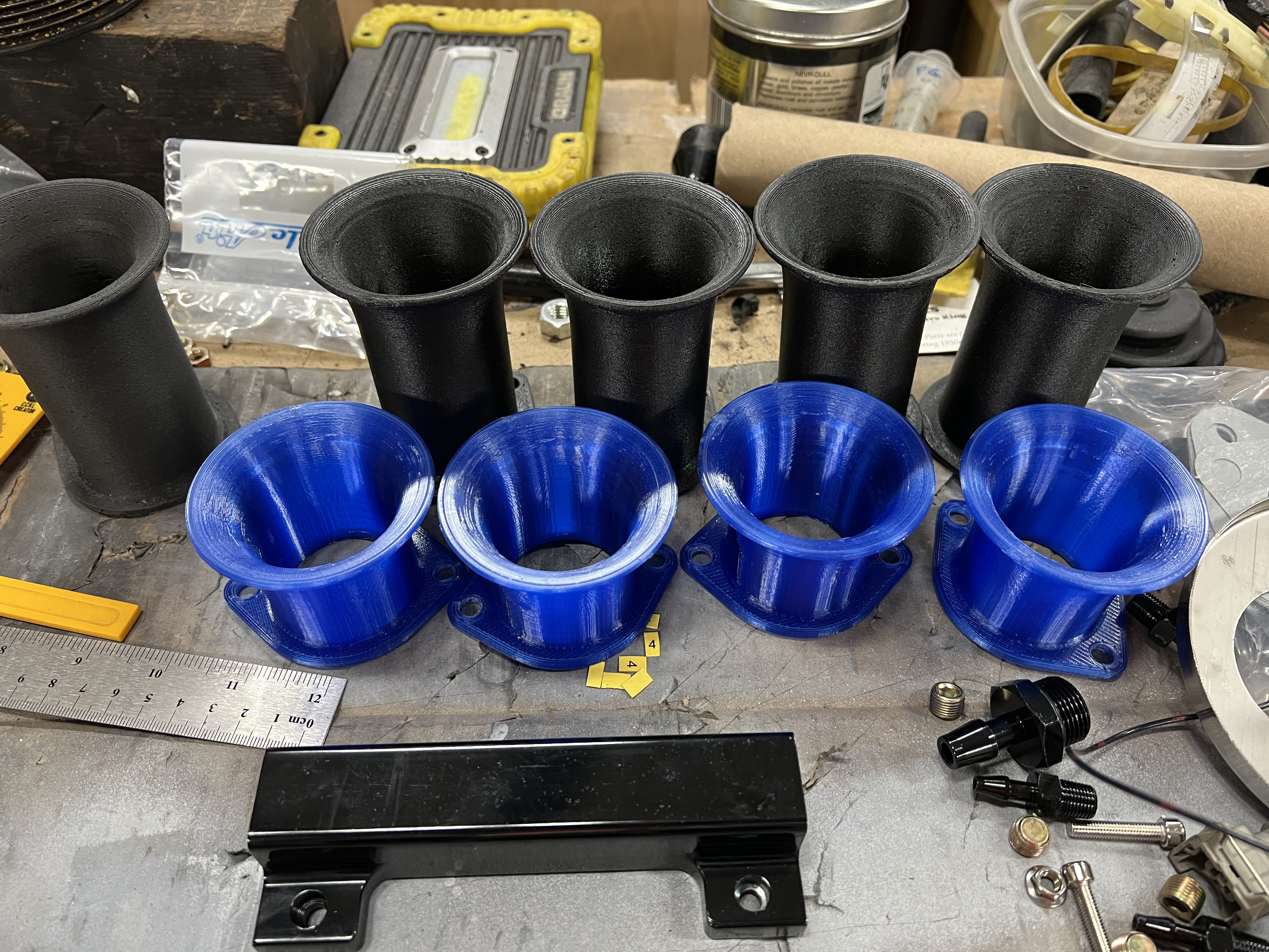

PA12-CF (Nylon PA12 carbon fiber) and (blue) pure PC..
FI body 40mm 95 and 35mm stacks  (pre-finishing)...
Edited by ptegler

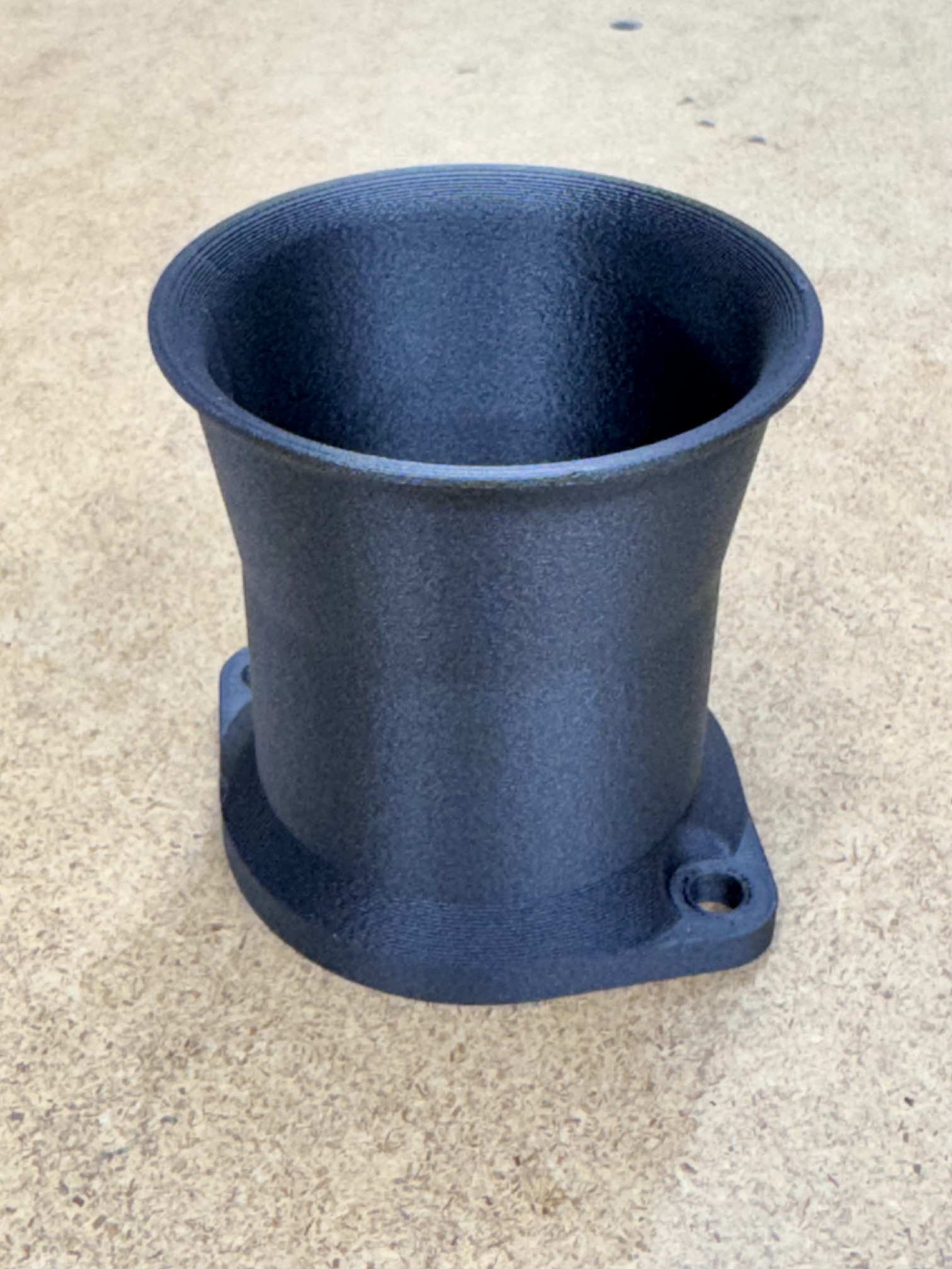

Looks good! One thing to know is that without a thick chamfer, the layer lines may start to separate from vibration where the base transitions to the tube. Even though I included these on the extensions I made for the Caterham, I failed to add a fillet in the small area cut out for the bolts. That was enough of a stress riser that two of them began to separate at that location after about 3800 miles.
I don't have a picture of the revised parts I printed, but I took a similar approach with these airhorns I did for the Elan.

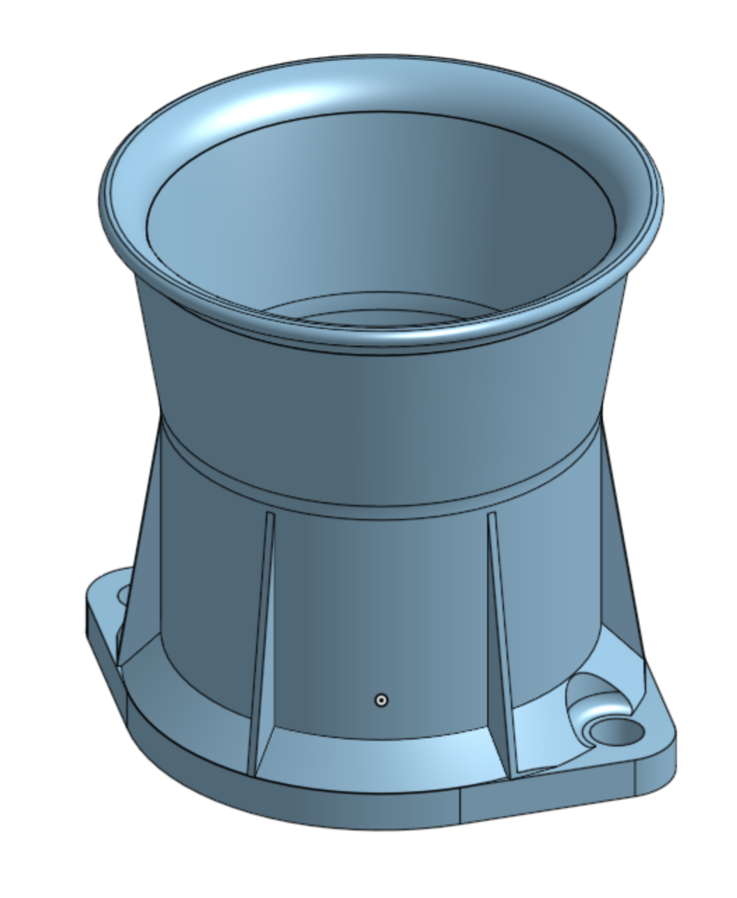

If those don't hold up, I'll print the version I subsequently designed which adds ribs around the circumference. Not printed yet, but here is a screenshot from CAD.
Nice! Is this PA12?
It wouldn't print as clean, but you could change the orientation of the part so the layers are perpendicular to the flange.
Another option may be to connect them all, perhaps in the middle, and turn it into a more rigid one-piece part.
The original extensions were PA12-CF, but I've switched to PET-CF. I want to maximize airflow and ensure the base is perfectly flat, so don't want to introduce the variability that comes with printing it in a different orientation. The new design should be fine, but if not, I'll go with the external ribs.
That's a good point. The flange isn't going to be flat if you print it vertically.
I've got to try PET-CF.  It looks like this would be a great fit for a lot of the work I do.
If it needs to be FLAT you may want to sand it down, regardless of orientation.  Nothing wrong with a little post-process for functional parts
