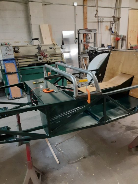

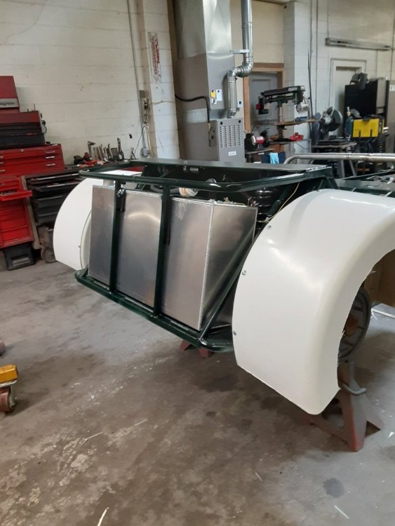

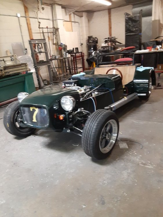

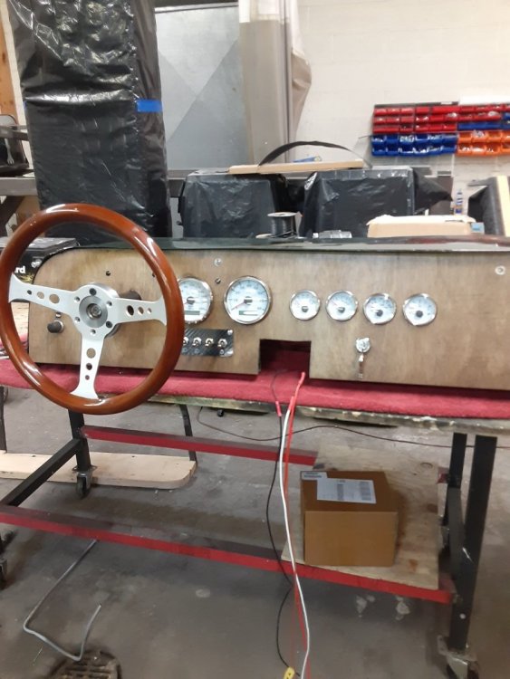

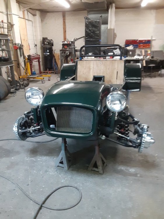

Alex-Ks1 Posted August 11, 2022 Posted August 11, 2022 Hi, I'm new here , just about finished with my 7 , did all the work my self , started in late March of this year , so my back ground is European auto classic restoration , did hundreds of classics in my business but never did a car for my self , so I did . Bought the book low-cost , then modified it for my use , but kept the frame to book size I put a 3.4 GM V 6 , in it after I rebuilt it and and a T5 ,5 speed trans and a 3.08 S10 rear end . It's carbureted , no fuel injection . I did all my own work on rebuilding all the components , made my own seats , made the instrument cowling useing GPS speedometer Plus taco and the other 4 gauges , I used brookland wind screen instead of the full frame windscreen . It has a 18 gal gas tank I made . What I didn't like was the front steering and suspension , I used a new Mustang 2 front system , and steering much stronger and more rigid . 3
MV8 Posted August 11, 2022 Posted August 11, 2022 That's a great power train. M2 is a popular IFS. Looks like a TBI intake in the pic but it is hard to tell. It Also looks like you kept the bumpsteer in check and added some ackerman too. There are several locost books now. I assume you are referring to Champion's book.
Alex-Ks1 Posted August 11, 2022 Posted August 11, 2022 It is a TBI both Edelbrock and Offenhouser stoped making the four brl manifold , becides the holly 390 CFM is way to expensive. Im the process of making my own low profile manifold .it's really not that hard , jus time and patience. So for now I have a Ford autolite two brl Carbonite with an adapter I made to fit , again not that hard ,just time and patience , An interesting thing is I was about to make the front fenders I went to a place called TRACTOR SUPPLY. They had fenders of all sizes for farm equipment and trailers ,I bought on , set on a wheel and laughed, it fit perfect so I cut it in half to make two , what a time saver that was I haven't had it on the road yet but it runs so sweet , loud as a dragster it has no mufflers just straight pipes .But who cares , it's a racecar By the way ,,,,,,, racecar spelled backwards is RACECAR 1

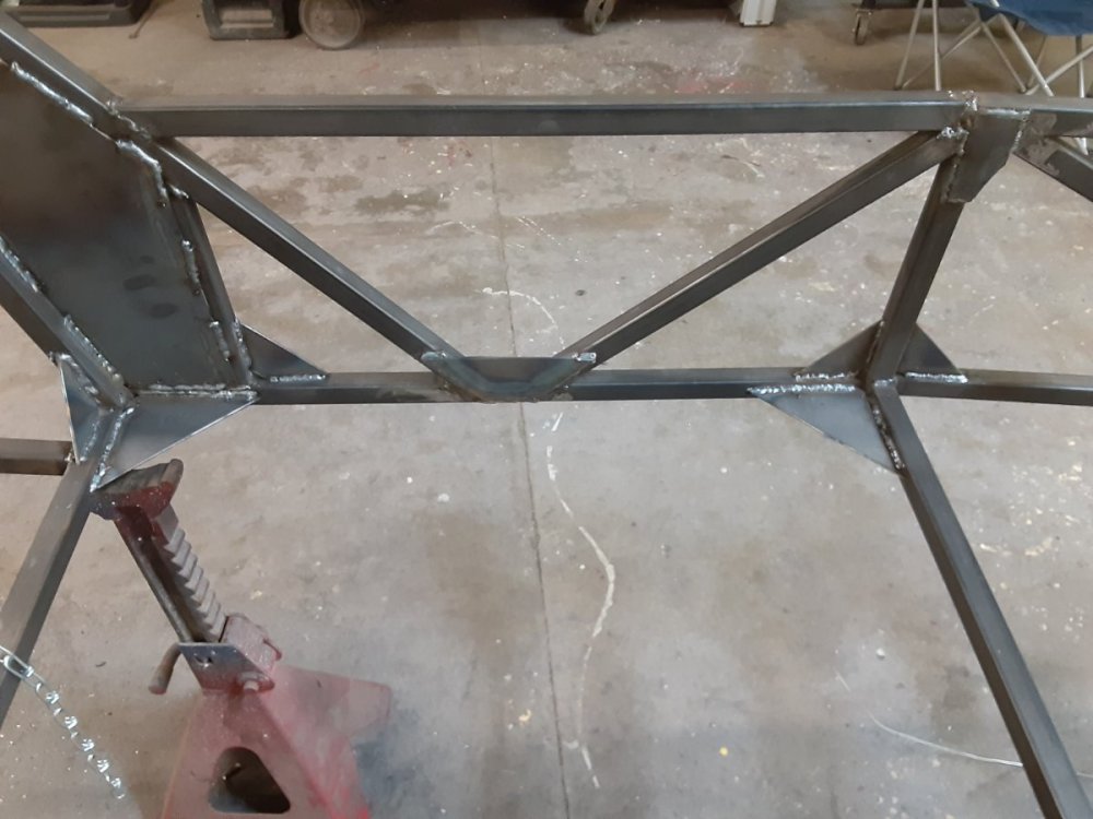

Alex-Ks1 Posted August 11, 2022 Posted August 11, 2022 That's all well and good but you can't buy any of these manifolds ,I made a three bolt to four bolt adapter for the Ford autolite carb for the TBI manifold . This two brl carb has the same CFM as the holly 390 . I have looked all over the the Eddy or Offy manifolds, none are for sale and no new ones anymore , I have seen these photos on the web on alot of 2.8 V6 forums , Yes the carb sticks out of the hood , yes I had to cut a hole in the hood ,Yes I'm making a scoop for it and I do all my own painting and body work , in fact I did everything in my shop The frame is much stronger than the book frame I put gussets at every joint ,I wasn't concerned about how light it could be , but how strong it can be where it shows no gussets is because I didn't put them in yet 1
