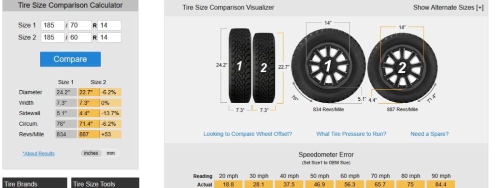

Currently have 185/70/14's on my 03 SV, factory manual states 185/60/14's are optimal. Not much available in a street tire for either size, wondering whether I should switch back to the 60 series to bring the car back in to factory spec. The question I guess I have is whether dropping the sidewall height is worth it for the more accurate speedometer and perhaps a little more clearance for the front cycle fenders.
What say you?

tire dia. (in)
tire circum. (ft)
tire revs/mile
195/60-14
23.21
6.08
869
185/70-13
23.20
6.07
869
185/65-14
23.47
6.14
859
185/60-14
22.74
5.95
887

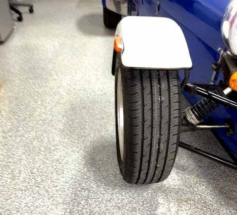

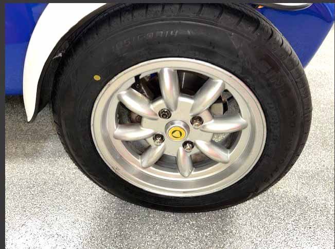

Been a few weeks, the Caterham was put on the back burner (actually all the cars were), but after careful consideration, I replaced the eight plus year old Pirelli 185/70/14's with Falken Sincera SN250 A/S tire in the Caterham suggested 185/60/14 size.
Sure not as aggressive as the R888, (still "H" rated up to 130mph )but also safer for all year round driving, and especially in the rain, which has been known to pop up with little notice in my neck of the woods. Had the car out for a test spin earlier today (11:30am, already 87 degrees). Car feels sure footed with no clearance issues, even at full lock.

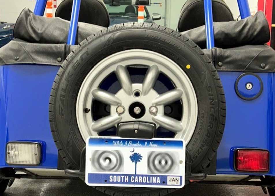

If you have a spare tyre carrier,  the mount bung will be fixed at the center height of the specified tyre and wheel
I'll let the picture speak for itself
I do not believe that is the case. My car came with two different spare tire brackets. One has a single arm and therefore only uses a single lug nut. That is what is on my car now with the OEM 16” HPC wheels. It is still in the body shop, DON’T ASK, so I cannot take a photo of it. But the second bracket is like mrmustang’s photo with two arms for two lug nuts. It’s shown in the circle with other parts that came with my car.
I cannot see Caterham making up four different drill jigs for four different wheel diameters (let alone consider different sidewall heights) so the spare tire will sit nicely on spare tire frame. It would make more sense to have one hole set for halfway between the center of the 14” and 15” rim sizes with a bracket that would work for those sizes. Then have an adaptable bracket for the other rim sizes.
I know this is plausible because I have seen a Caterham 1700 Sprint which was shipped with Revolution wheels, I assume 14” when first ordered. Later the original owner had James Whiting make a number of changes. One was to modify the mounting bolt and the accessories (I assume the bracket) to fit 16” HPC wheels. See the final line items at a cost of 30 GBP on the work sheet.
