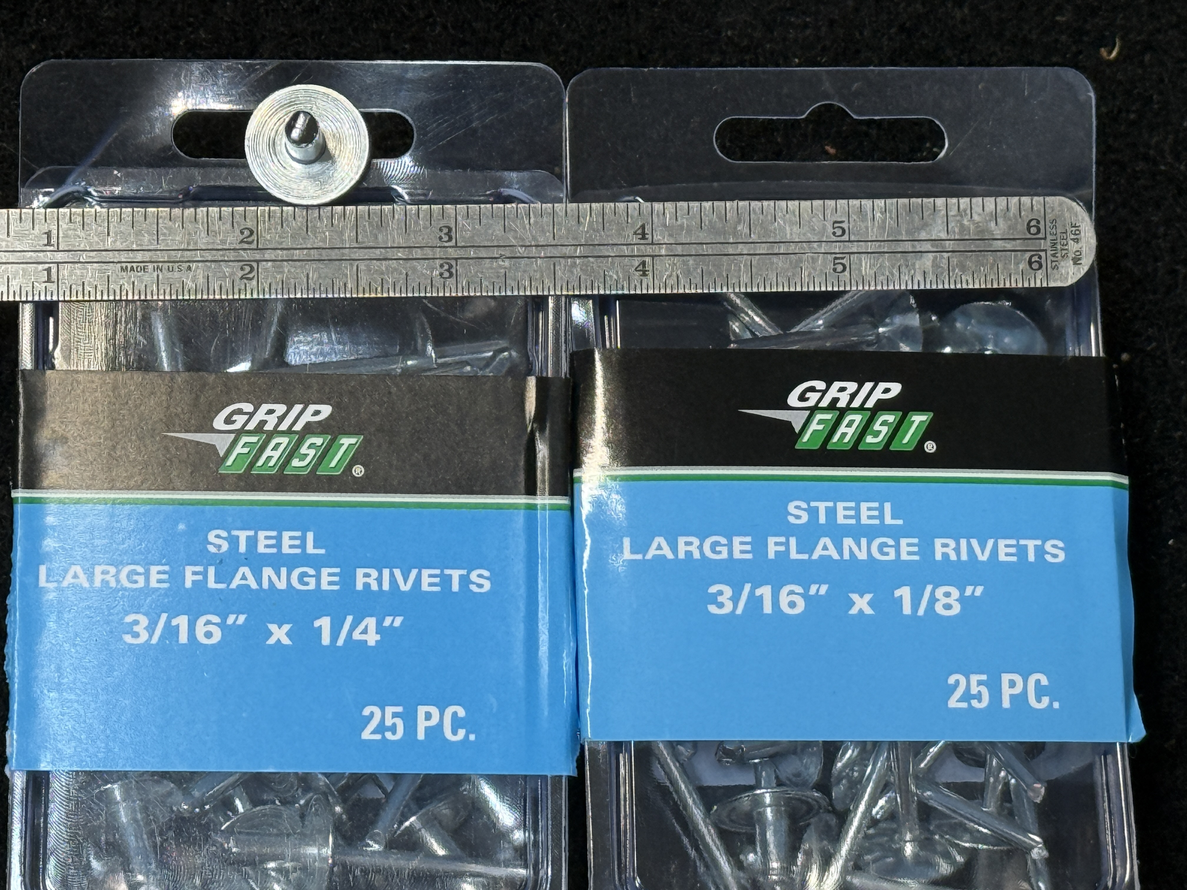

pethier Posted 1 hour ago Author Posted 1 hour ago On 6/11/2026 at 10:51 PM, pethier said: I picked up some pop rivets with oversized heads I found these pop rivets at Menards. The flanges measure 0.626", or 5/8", or 15.9mm.
7Westfield Posted 31 minutes ago Posted 31 minutes ago (edited) if you'd rather have aluminum, I can mail you a handful https://www.speedwaymotors.com/Large-Head-3-16-Inch-Exploding-Rivets,42816.html?sku=910049-PLN remember---add lightness Edited 21 minutes ago by 7Westfield
