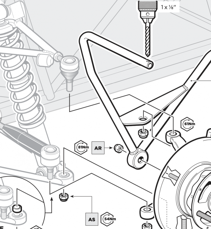

  15. I'm jealous @sainthoo, I'd love to be able to do it all over again. I would install the radiator after the engine as it is pretty easy to damage it especially when you roll the crane into position. For the radiator brackets, see if you have what is in this picture:
