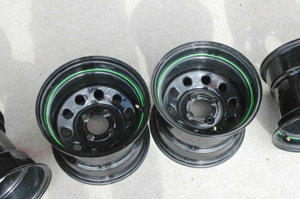

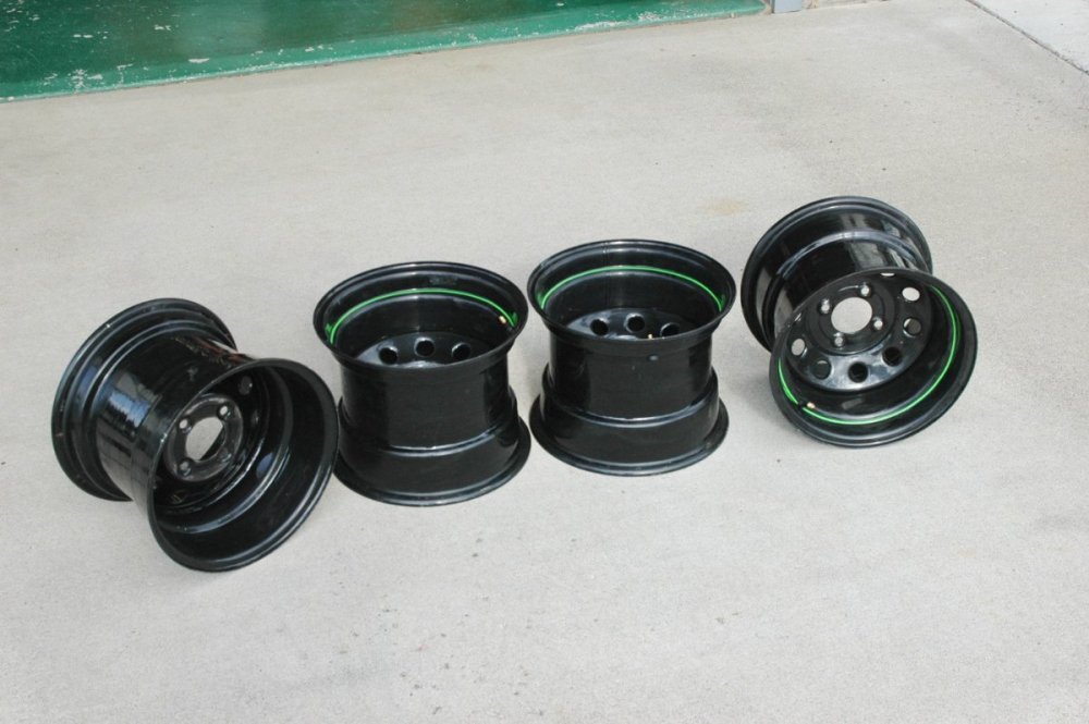

I use 13" x 10" Real Racing Wheels on my Westfield for autocross. I run Avon Avon slicks and love the combo. They are light and strong and I have many hundred runs on them without issue. It's worth checking with Real Racing wheels. I think they are much less expensive than Kodiaks and he will make them with any width, bolt pattern and backspace that you want. dave

I have two sets of wheels for my Westfield. The street wheels are Revolutions in the 13 x 7 size and they are fitted with 205/60-13 Toyos. The autocross wheels are Real Racing Wheels and they are 13 x 10 and I use Avon slicks on them. I have to say that the car corners pretty darn well on 10" wide slicks! dave

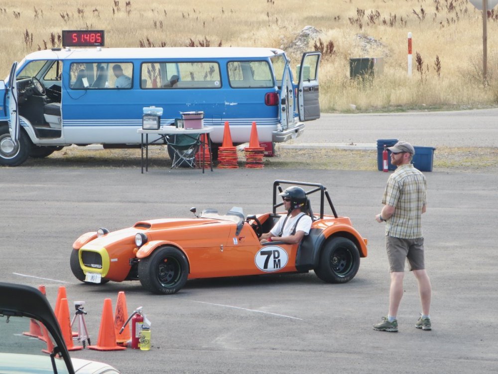

Look at that - I'm internet famous! That is my car, with me driving it, at a local autocross event a few weeks back. The parking lot is at a local church and they allow us to run there on some Saturdays when church is not in session. Frankly it's almost too small for a good course but we make the most of it. My car is Honda S2000 powered and has Omex ITB's which add some grunt in the mid range and they make it really fun to drive and give it a fun sound. My main competition is a friend of mine who races an Ariel Atom with a supercharged 2.4L Honda in it. It pulls so damn hard that it's hard to process....and on 13" wide Avon slicks it hooks up in a big way. I beat him on this course by 2.7 seconds on a roughly 52 second course to take FTD. I've raced him 3 times so far this season (with many more days to come no doubt) and set FTD at each event. I don't have the big grunt he has but the handling balance is better and I have to slow less for everything and that's what really counts in autocross. Last season I raced my car 18 days and set FTD 16 times...the other two days I placed second. Westfield makes an awesome car that is very tunable and can be made to handle so very well that it's very easy to drive at the limit. And that it wicked fun. If I end up with more video I'll be sure to share it here. dave
