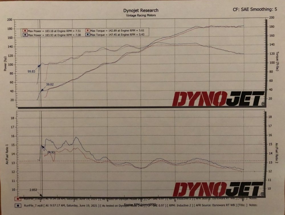

JohnCh Posted June 19, 2021 Author Posted June 19, 2021 Revisiting this thread after nearly 10 months because the car finally made it to the dyno today! The shop, Vintage Racing Motors, focuses on building, restoring, and maintaining vintage race cars, including some very, very high dollar stuff. As a result of this work, they frequently put the same engine on both the engine and chassis dynos so have a pretty good feel about parasitic losses with their specific Dynojet. Byron felt 18% was correct for my car. It may be right, it may be wrong, but interestingly, using that number results in nearly the same output I expected to hit given my exhaust, which is sized for my older 210hp engine. That system should cap out at about 225hp. Peak number at the wheels today was 184hp which converts to 224hp using an 18% loss. More importantly, the curve looked great. Yes, there is some torque to pick up below 3500rpm by richening the mixture, but it's minor. The power curve is billiard flat from 7000-8000rpm, showing there is still some upside at the top. Might be the exhaust, might also be the 45mm TBs are a little small. Cam timing could also help in that range, but would come at the expense of the bottom end. Regardless there is some headroom available for future upgrades that don't involve opening the engine. I'm happy and finally feel confident to really drive the snot out it. The red line is where we started, the blue is where we finished. It's hard to read the rpm scale at the bottom, but the run spanned 2000-8000rpm. On the way home I was behind a Tesla 3 Dual Motor whose driver decided to show off shortly after the light turned green. He then tried it again as we merged onto the freeway. I don't think the result of either event was what he expected while driving his invincible Tesla -John
Croc Posted June 20, 2021 Posted June 20, 2021 That smoothed things out nicely. Intersection of power and torque curves is at a good point for being usable on the road without stressing the engine.
fastg Posted June 20, 2021 Posted June 20, 2021 Strange statement, hp and torque always cross at 5252 rpm. If not you have a bugus dyno run. Graham 1 hour ago, Croc said: That smoothed things out nicely. Intersection of power and torque curves is at a good point for being usable on the road without stressing the engine.
Croc Posted June 20, 2021 Posted June 20, 2021 10 minutes ago, fastg said: Strange statement, hp and torque always cross at 5252 rpm. If not you have a bugus dyno run. Graham @fastg Stop it Graham, I was trying to wind up John!
JohnCh Posted June 20, 2021 Author Posted June 20, 2021 @Crocyou can -- and likely will -- try harder than that! Yesterday when looking at the map, I discovered the lean condition down low was user error. Somehow when building out the map last year, I accidentally left the cells in that rpm range at load site 15 (full throttle) untouched from my previous map. Adjusting to a tiny bit richer than the corresponding cells at load site 14 as with the rest of the rpm range should sort that out. -John

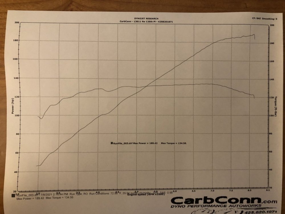

JohnCh Posted July 8, 2021 Author Posted July 8, 2021 I took advantage of some downtime and booked a session at another dyno facility to compare their numbers to those achieved a couple of weeks ago at VRM. My assumption was this other facility, with a much newer Dynojet would produce higher numbers, but I was only partially right. Peak power was up to a bit over 189 vs. 184, but the entire torque curve was shifted downward except for the top end where it increased. In fact peak torque was fully 12 ft-lb lower today, but the torque falloff over 6700rpm was less severe, resulting in power increasing all the way to 8200rpm vs. flat from 6700-8000rpm in the original dyno session. Weather was nearly identical both days, the only differences were the Dynojet versions and the fact today's run was done in third gear vs. fourth at VRM. VRM tried third, but there was a lot of wheelspin. We tried fourth today, but the pull was taking too long and resulting in a really, really wavy trace that looked like a sine wave. Third gear today seemed wheelspin free. -John
Kitcat Posted July 9, 2021 Posted July 9, 2021 Any theories on the relatively low torque # and the big drop off? My two stock Zetec SVT’s managed low to mid 140’s in torque, on a supposedly conservative Dyno. We each have 2 liter engines. On the positive side, your torque number is a nice fat/flat shape, all thru the RPm range.
JohnCh Posted July 9, 2021 Author Posted July 9, 2021 No idea. The torque doesn't feel less than the old engine with milder cams and lower compression ratio. That engine on a Mustang dyno registered 145 ft-lb, so consistent with the readings from VRM's dyno. Perhaps doing it in third gear lead to more parasitic losses than fourth gear which is 1:1, but that wouldn't explain the differences over 6700rpm. To me this simply shows that comparing dyno numbers gathered from different dynos is inconclusive. -John
JohnCh Posted July 9, 2021 Author Posted July 9, 2021 Looking more closely at the two dyno graphs as well as previous ones from a Mustang dyno with stock pistons and Kent DTEC10 cams vs. the new DTEC20 cams, I think I may know what's going on. The CarbConn graph is much flatter between 4300rpm and 7000rpm than the other graphs, and it doesn't peak until about 7000rpm vs. 5500rpm. Although I said there was no wheelspin during the third gear run, I'm wondering if there was a little? That would explain why the numbers on both graphs only differed by a couple of lb-ft at 4300rpm and 7000rpm, but the rise that happened between those two numbers in the other graphs were absent from the CarbConn results. Perhaps I was simply hitting the limit of torque the tires could transfer to the rollers during that range? The dyno operator at VRM could feel the wheelspin in third and I could see it while standing behind the car. At CarbConn, I was driving -- and have no experience doing dyno runs so easy for me to miss that slight sensation -- and no one was looking at the tires to confirm no slip. Judging by the seat of pants, the shape of the VRM torque curve also feels more accurate. There is a DynaPak hub dyno about an hour away. I may book time there to see what they show given their system eliminates the possibility of tire slip. -John
