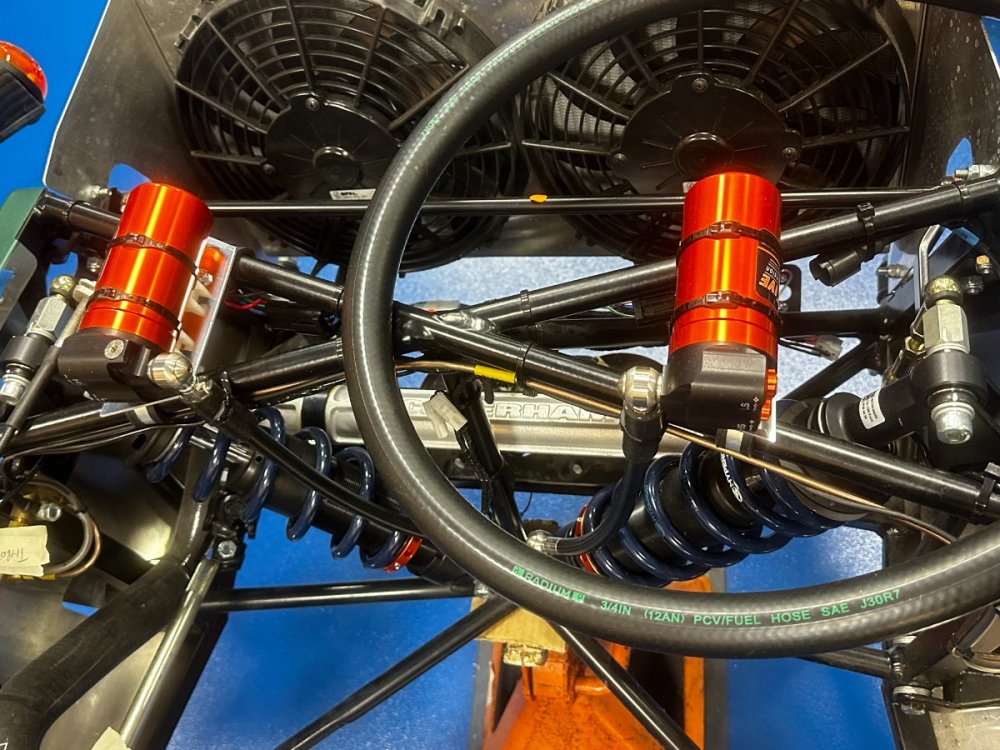

Croc Posted March 13, 2022 Author Posted March 13, 2022 23 minutes ago, Renottse said: Question @Croc about the tractive suspension fine tuning. Will it be the mechanical adjustment only? Or, does Bruce have the ability to make adjustments to the tractive control unit programming? There is always an element of mechanical adjustment. We cannot change the programming but we can change the presets for the suspension, e.g. soft to hard front to back. The final thinking of how we do this remains undecided but we can see the potential for say a dry setting with neutral to firm setting, or a wet setting (soft all round).

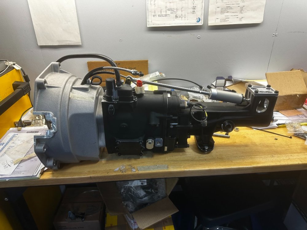

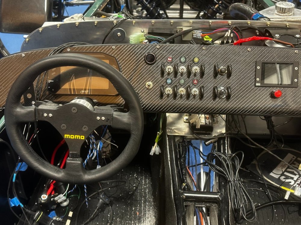

Croc Posted April 23, 2023 Author Posted April 23, 2023 Time for an update and progress has been made! The missing pieces on the Sadev gearbox that were needed to sort out the gear change have now been received and are installed. This was the source of the over 12 month delay. So nothing stopping the gearbox from now being bolted to the completed engine and installed in the car. Well...maybe Bruce's race season....which is about to kick off. The Tractive suspension is installed and wired in - ready to go. The ECU adaption to Caterham wiring harness is complete. Because the ECU was a MBE upgrade over the standard Caterham ECU, a bridge box was needed (mounted on the shelf above the actual ECU) which has the sole role of just plugging into the existing wiring harness. The extra pin ins/outs are then wired in separately. A non-standard ECU was needed anyway as the engine was going to use a bespoke tune rather than a Caterham tune. The upgraded ECU can then integrate engine and Sadev for engine cut during gear change plus throttle blip on downshift. Given the hp levels, it was also fortunate the upgraded ECU can handle traction control at the same time and integrate that with the throttle control for the gearbox. Wiring is done - Digital dash and switch gear (following the 620R style). The screen on the right is the Tractive suspension control panel. The two knobs to the left of the screen are the launch and traction control knobs. The little black round dial to the left of the switch gear is the gear indicator. The box on the tunnel up under the dash is the suspension ECU. The rats nest of wiring is best seen here. Its all labelled. The scuttle is removable with screws rather than rivets so access is easier than normal. The black round tank in lower region of photo is the air tank to power the pneumatic gear shifts for the paddle shifter. Finally, a way forward is available. Engine and gearbox install next. 3

fastg Posted April 23, 2023 Posted April 23, 2023 Croc, what ECU are you using? How are your detecting wheel spin for your traction control, do you have wheel speed sensors? Graham
Croc Posted April 23, 2023 Author Posted April 23, 2023 29 minutes ago, fastg said: Croc, what ECU are you using? How are your detecting wheel spin for your traction control, do you have wheel speed sensors? Graham The standard Caterham ECU is a MBE 9A4. I have gone with an MBE 9A9. So have full OBDII. Full digital dash and gearbox integration. In the last of my photo threads, referring to the third photo, the 9A9 is the box under the shelf. The box on top is a wiring box that looks like a 9A4 ECU but is really just facilitating the Caterham wiring harness into the ECU I am using. For wheel sensors, I am using Bosch ones on all 4 wheels. The May 30, 2021 post shows the custom reluctors and wheel sensor mount sites. I have a model number for the Bosch sensors somewhere if you need it. Technically, the wheel speed sensors and the ECU could handle ABS brakes - all we would have to do is buy the Bosch ABS kit and install it on the calipers. While that was contemplated, decision was made not to as the brakes work great as they are so why complicate things any further. I have adapted the standard Caterham brakes with a proportioning valve but once the brakes are fine-tuned I don't think I will need to touch the valve again.
