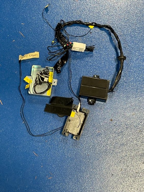

More progress this week.  The immobilizer accidentally dropped off the car.  These are automotive security devices essential in the UK given the high rate of crime present and the current inability of the UK to send convicts to Australia.  They work to provide a complete circuit when a key fob sensor is in close proximity to a receiving sensor mounted on the steering column.  With this then power is provided to the electrical circuits to allow the car to start.
In reality, most US builders of kits just tie wrap the key sensor to the steering column next to the receiving sensor so that it is always on since the USA does not have anywhere near the level of crime and thievery seen in the UK.  Something to be said for the Second Amendment I guess?
We could have put it back on but decided not to.  Its just extra wiring complexity and a likely future failure point.  Quite an intrusive piece of kit when seen in isolation.

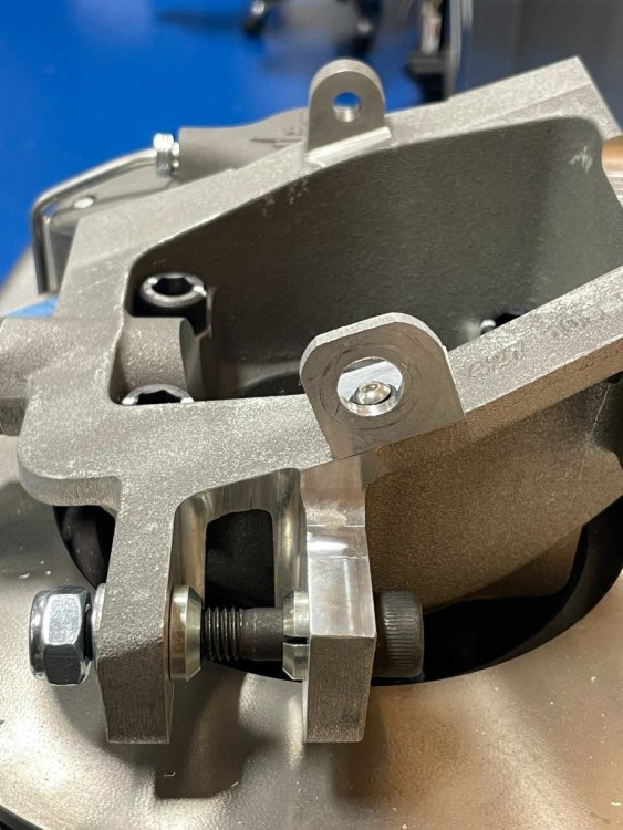

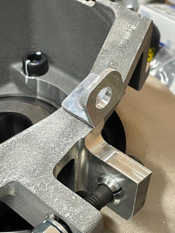

With the wiring advanced far enough, it is time to wire in the wheel sensors needed for measuring wheel rotation speeds for launch control, traction control and the ABS brakes.
This is the right rear.  Brackets for the sensors now mounted on the hub.  As a reminder, the CSR chassis is independent rear suspension.  These hubs will look nothing like what a de Dion rear end car will have.  The IRS was reputedly derived from a 1990s era VW Passat sedan.  The rear uprights are pretty tall when you see them.  To this a custom wheel hub is mounted onto which the brakes/wheel assemble.  This hub was reputedly developed by Titan Engineering for Caterham or so I was told once.
Lots of measuring is involve to ensure no interference with the suspension but yet close enough to the reluctor wheel to ensure optimal contact.  The photo below shows the precise tolerances needed for this to work.  These wheel speed sensors are quite large compared with the usual speedo sensor that Caterham would provide.  The reluctor wheel is the "cogged" tooth around the drive shaft (the thing with the rubber boot).  These were 3D printed in plastic for trial fitting and then sent to a professional to mill out of metal.
With that the right rear suspension can be mounted on the car.
Next step is left rear suspension.  Much easier second time around.

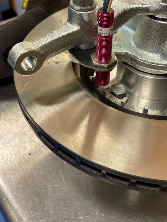

The front wheel assembly is now coming together with the wheel sensors.  A milled reluctor wheel for the front wheel has been designed and fabricated to drop inside the front brake disk.  Next step is disassembly, zinc-coat the reluctor to protect it and then final assemble.

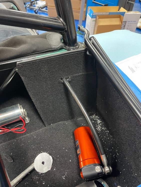

Following on from last week, the rear suspension assembly can move forward by sorting out the remote reservoirs for the rear shocks.  Holes made to bring the reservoir into the boot area and they will be bolted to the boot floor.
