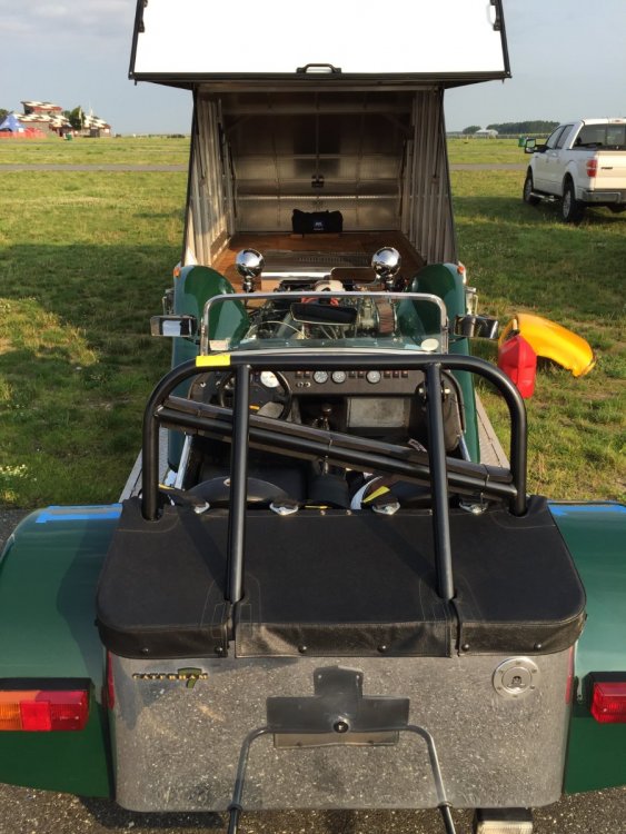

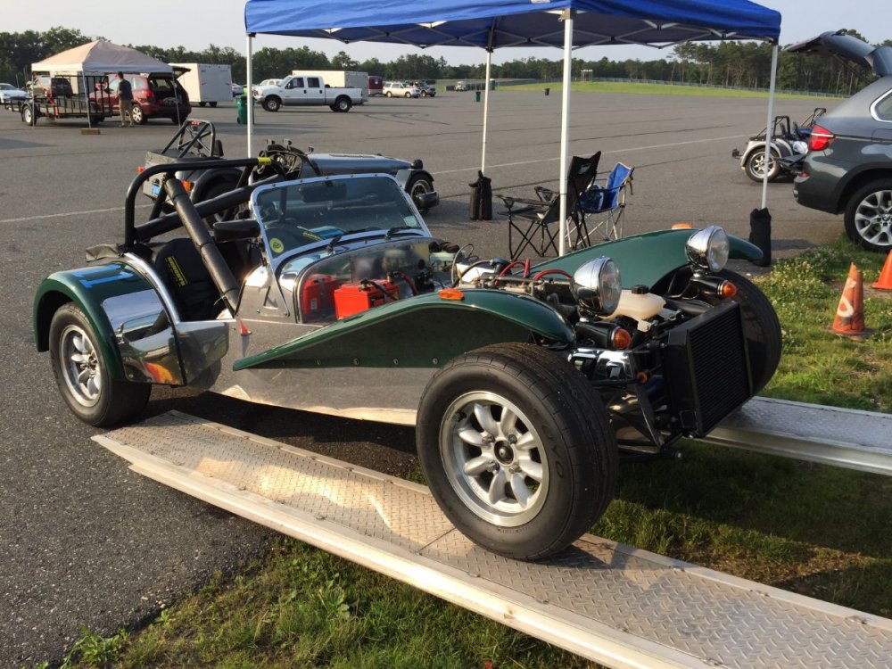

This stuff really works. The initial goal is to polish off the machine or mill finish so that there is no visual granularity remaining. From that point on, you are just working on refining the mirror finish. While all of the aluminum one my car is 6061, the bonnet is a different variant of 6061 and was more challenging to get a nice as the rest of the car. It just requires persistence and patience. I have tried other brands and while most of them work ok, none seem to work as well as this stuff. When I was flying a Gulfstream, my mechanic contacted the Gulfstream finishing shop for guidance. This is the stuff they use on new Gulfstream jets brightwork. Once you have polished the car a few times, it gets easier and easier. Mine is down to an hour of hand touchup every month or so.

Mike - You’re making me blush.🙂 And tbh, I’ve never been totally happy with my polishing.  More haze than I’d like.

@papak wins the shiniest Birkin the world.  Love the mirror finish you have obtained on your car!
