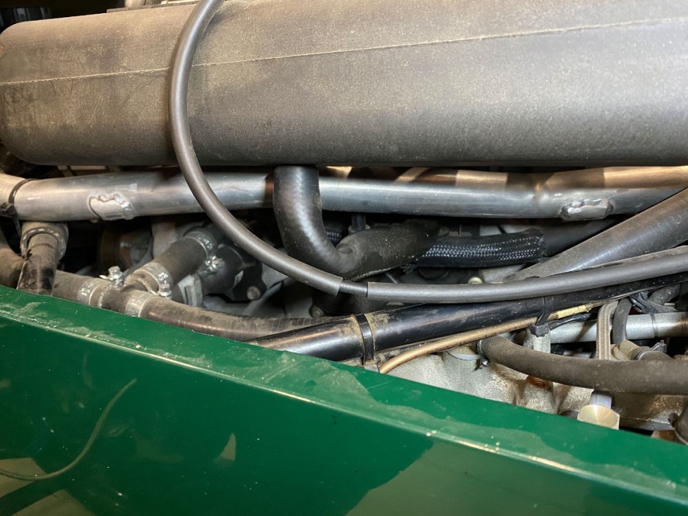

Progress today that significantly ups my chances for NJMP. After moving coils around the car seemed to just run very poorly (and rich) at idle and ran slightly better with at higher RPM. I got new spark plugs because it was clear it was running rich but the results remained similar. A then while staring off into space I am looking at my car and voila - there is a hose under the inlet not going anywhere! Plug it in and the car now runs smoothly. Picture below shows the offending hose hooked back up from the PCV system. Just need to get a clamp to secure it (don't know if there was a clamp that popped off or if there was never one there)
I don't think anyone said look for a vacuum leak :classic_ohmy:
Now I just need to sort out the throttle. Today actuating it cannot make it stick open but I need to be confident on that before I track the car. Not sure why it stuck and why it is not sticking. Pretty simple system and the cable seems to actuate very smoothly. If anything, it is in the physical pedal. And I also need to ensure this was the cause of the rapid RPM increases that occured.
