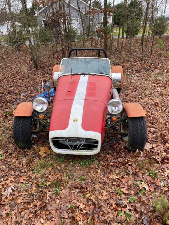

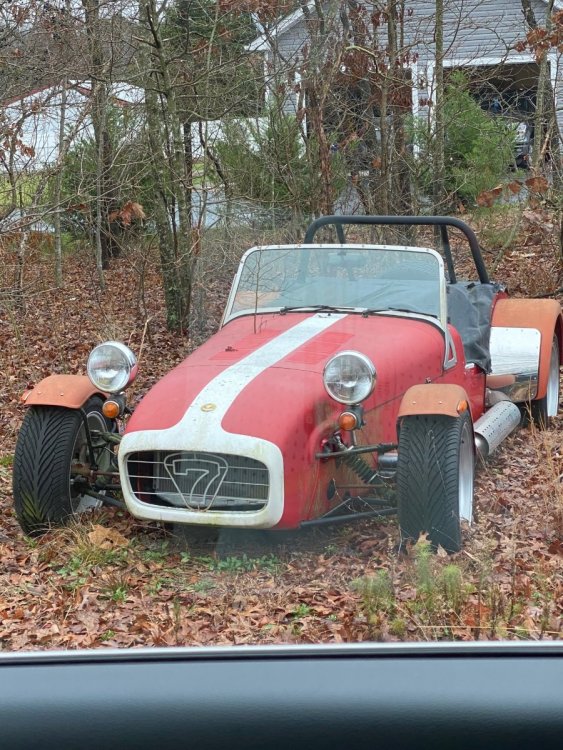

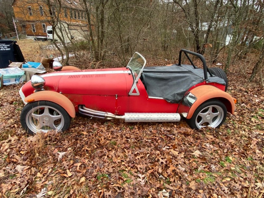

Good afternoon all. My father-in-law passed away last month and my wife drove down to his home to assess the property and begin the lengthy process of determining what’s what. They have some acreage and this beauty was sitting on the property! I have no details on the car outside of these pictures as I’ve yet to see it in person. My brother-in-law still lives on the property and claims that it did run at one time. Thought I’d post it up and see if anyone had any insight based on the pictures. It’s looking more and more like it’s going to find a new home in my garage and become a project for me! I’m beyond excited!

It seems to be a Caterham, based on the hood emblem and other details.
The small tree growing through the front bonnet opening suggests it’s been sitting a while! As does the faded paint.
The driver’s side exhaust means its a X-Flow engine or maybe a Zetec. The wheels were standard on Caterhams for a period of time.
This should be an interesting project!

Agreed. Pretty neat as a find.
If I had to throw a stick at it, I'd say it's a 2004 SV Zetec. The blinkers on the fenders is the only thing leading me towards a later year rather than going into the 90s.
Can't be too late 2000's due to the headlights still being 7in and mounted in the back of the nose cone.
I think the wheels are a later year thing too.
It will certainly need some love but it seems to have good bones.
Once you get us the VIN we get a lot of information out of that for you.

It’s definitely been sitting! We are estimating that it’s been there for around 15 years. The tree growing through the bonnet made me chuckle!
Definitely has the Caterham badges, but that great to know about the drivers-side exhaust. Once I get my eyes on it, I can get some much better pictures and details.

Awesome info, thanks! We were thinking early 2000s as well based on the timeline of the family’s travels and moving history, so it sounds like we were on the right track.
It definitely needs some love, but I’m really excited to get it working again and back to its former glory. I wouldn’t mind modernizing it along the way too based on some of the newer models I’ve seen too. Heck, I’ve even seen some crazy LS swaps out there!

Thats a pretty accurate stick.  Definitely Caterham SV.  All the details match up.  Definitely zetec or SVT zetec as the exhaust is the super long one with the integrated cat converter.  Crossflows did not have that as they did not have to meet emissions.  The side wing repeater blinkers were always included in the US kits but they were a UK SVA requirement so most did not make it on a US build car as it is just one more thing to go wrong.  The wagon wheels were 2003-2005 area, maybe as late as 2006?   The rubber looks like sumitomos which were common replacements for Avon CR500s once the original set wore out.
Thats a very worthy project and worth a fair bit even in this state.  Recommissioning something like this is lengthy - all engine and transmission fluids, suspension bushings, maybe the shocks, all new rubber, refurb brakes, replace all the hoses around the engine bay, test all the electrics and thats before you start the cosmetic stuff.  Buts its all straightforward, just lots of little jobs.
Congratulations on this find!
