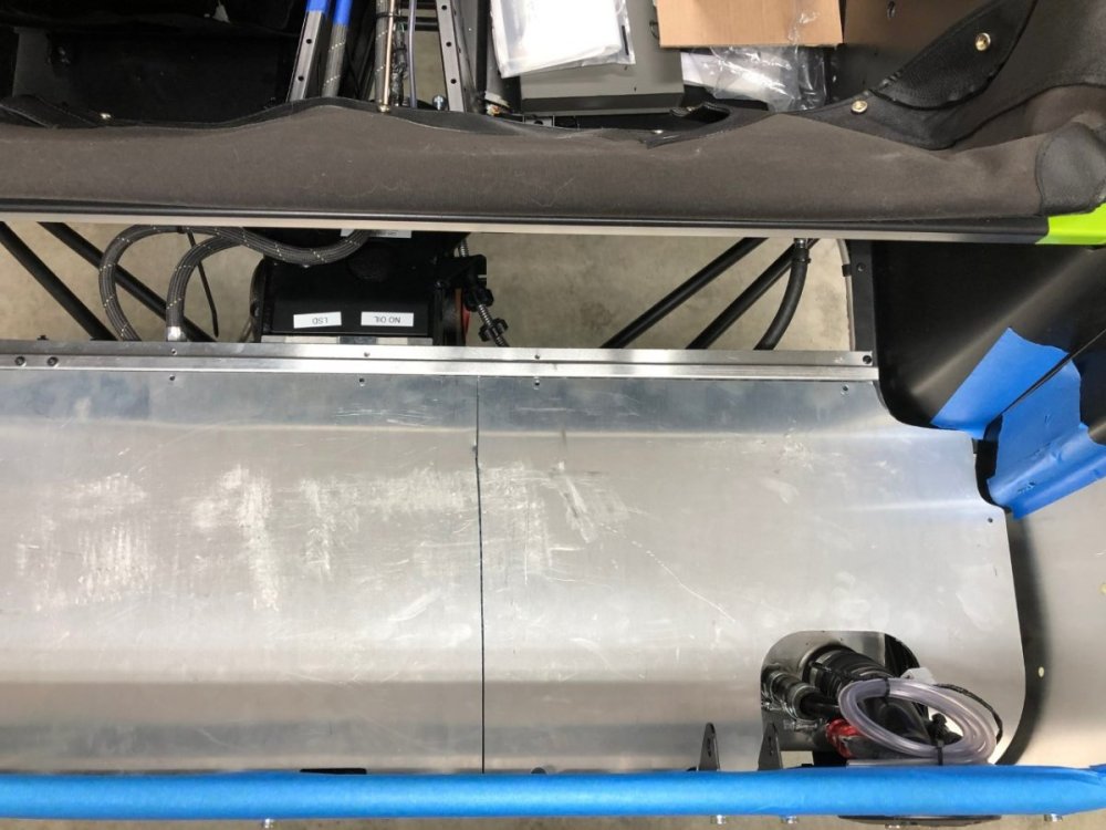

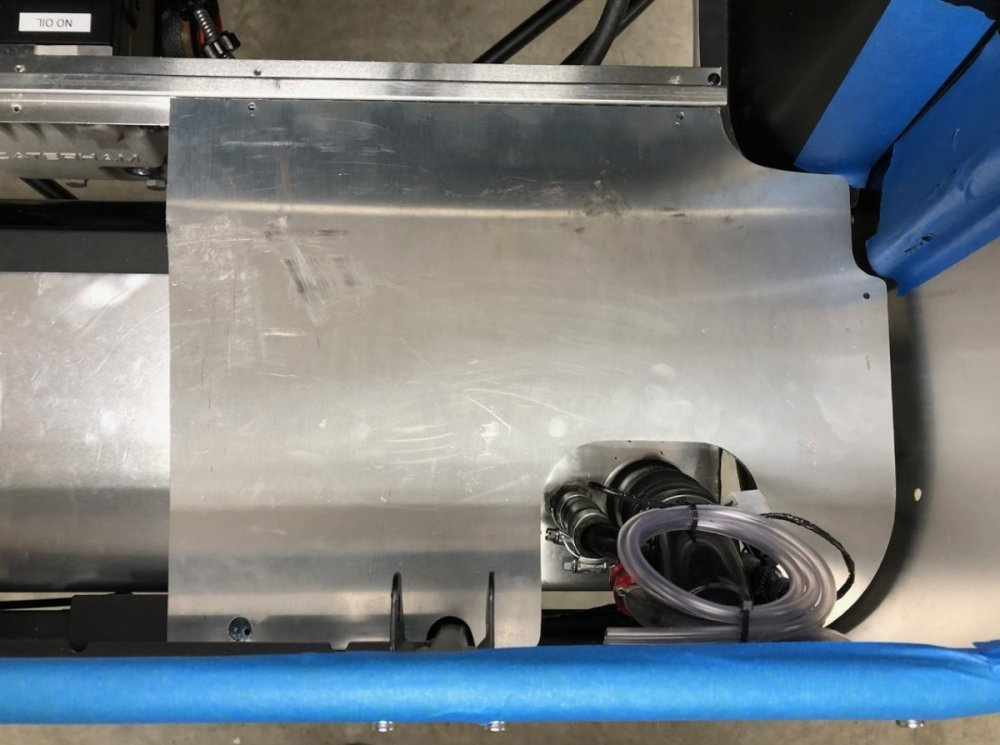

Anyone who has removed the honeycomb boot floor can attest that it's an exercise in frustration.  It's one of those there-is-absolutely-no-way-in-hell-that-can-wiggle-out-without-bending-something moments until suddenly….it's out.  Looking at the supporting frame, there is no apparent reason why Caterham doesn’t simply cut the floor into two pieces so it's easy to remove and install when you need to access the fuel tank.  Since they didn’t bother to do it, I did.
This was my first experience cutting honeycomb. It turns out that when using a thin jigsaw blade, the blade can twist within the honeycomb, creating a bevel cut and pulling the saw into the guide while slowly pushing it over despite the use of clamps.  Unfortunately, I didn't catch this early and ended up with a cut that is anything but straight.  Not a big deal given it's only a cosmetic issue and isn't visible when the boot carpet is in place.  The honeycomb floor is now quick and painless to remove and there is no impact to the rigidity of the floor.
This photo shows the right side of the rear frame for the boot floor.  The red line on the tape shows where the two sides will meet once it's cut in two.
The next two photos show the boot floor after the cut.  First, with just the right side in place, then with both sides.

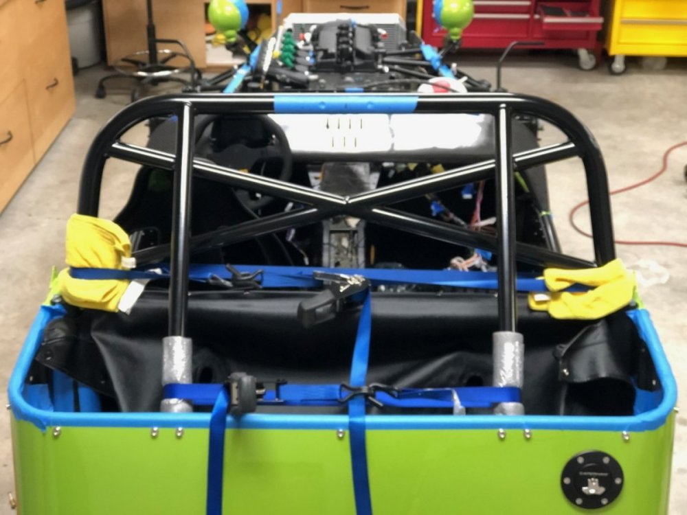

With boot floor cut and fuel plumbing work done in the back, it was time to install the rollover bar.  Taking a tip from a build blog, before blocking access with the bar, I ran a harness bolt into each harness fitting to make sure they weren't gummed up by paint.  They were fine, but it was clear the person who drilled the aluminum strip in the back of the boot cover that sits over those holes was having a bad day.  The holes for the passenger harness bolts were partially blocking the threads, and it appears they tried drilling those holes a few times, because they were not a shape one would confuse with round.  Removing it from the car then cleaning things up with a file and it was time to install the rollover bar.
As others have found, bolt alignment was off.  In my case, a pair of ratchet straps were required to move things around enough to get all six bolts in place.  Tomorrow I'll drill the holes for the 3rd brake light and prep and paint the aluminum mount.

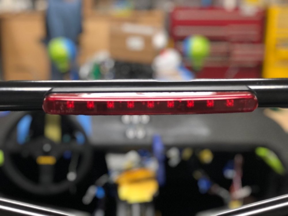

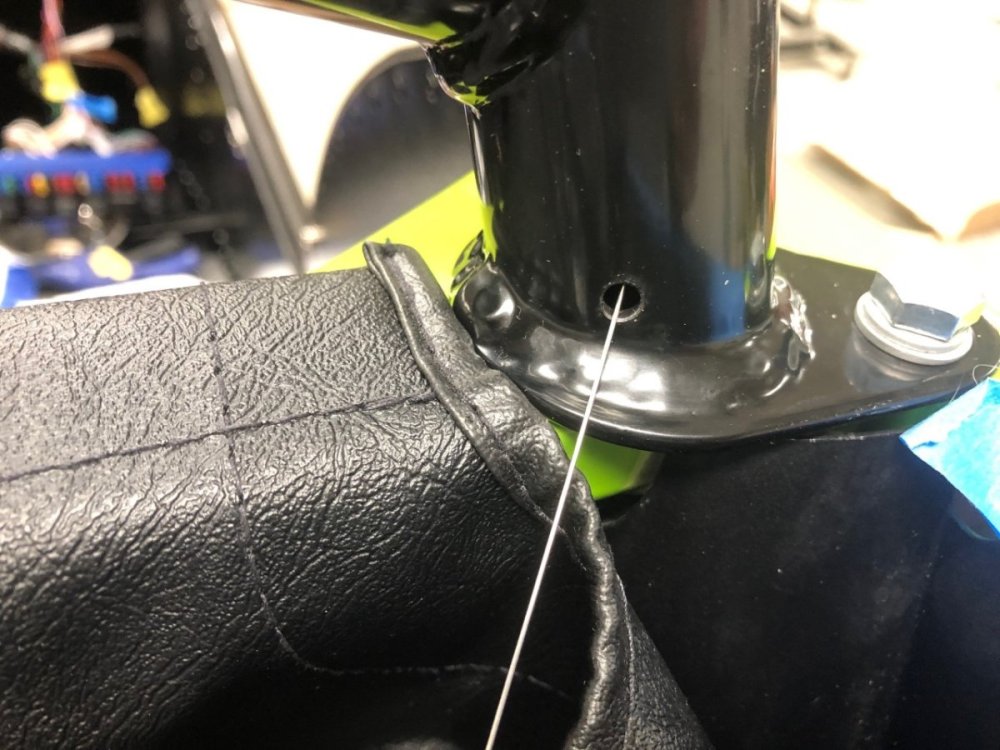

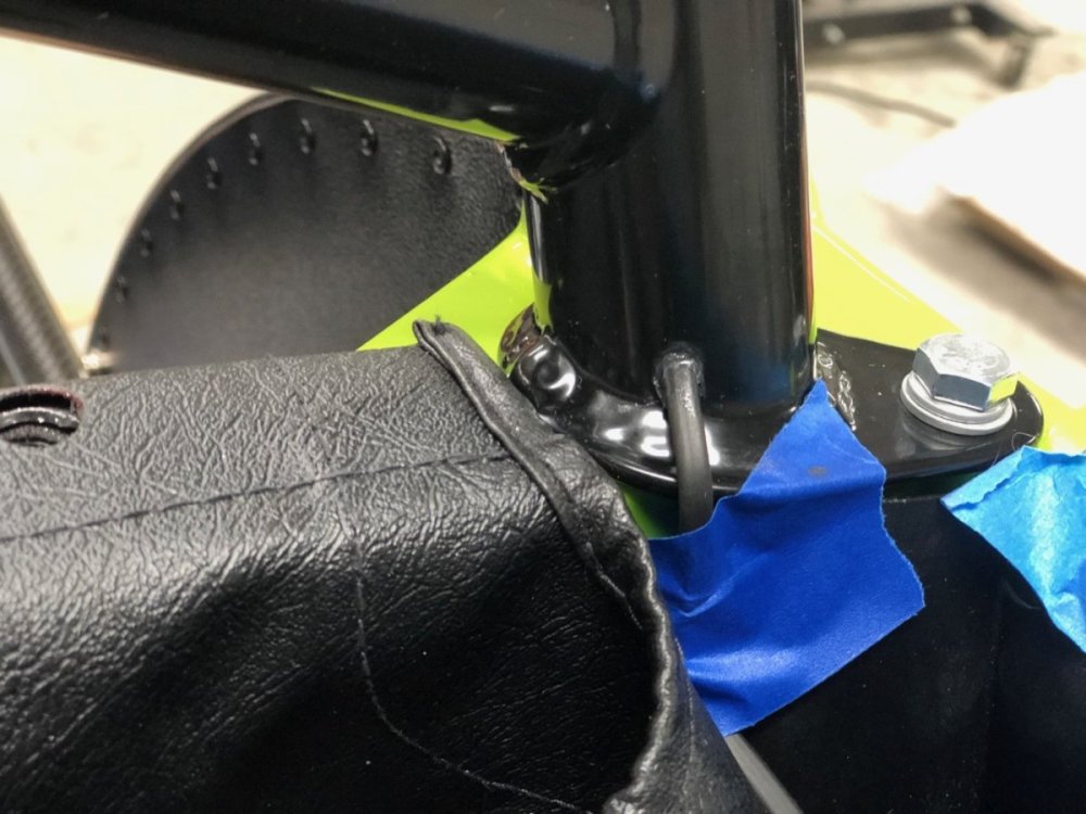

A few random updates I'll break into two posts.  First, the 3rd-brake light is installed.  I purchased an unused Beachman Racing setup from someone on the forum.  The mount is beautifully machined from aluminum and is normally installed in its natural state, but having that as the only piece of brightwork on the car seemed a bit out of place.  A light sanding, then shooting it with primer followed by Rustoleum Satin Black which is a decent match for the powder coating used by Caterham, and it blends in with the rollbar.
Running the wire through the rollbar was not as daunting as it sounds.  I ran safety wire, which is thin yet stiff, from the exit hole on the bottom of the rollbar up to the entry hole on the top, grabbed it with a pick, pulled it to the hole, then reached in with forceps to grab the wire and pull it out.  Wires from the light were then twisted to the safety wire and sealed together with adhesive lined heatshrink to avoid separation in the middle of the rollbar, and finally the whole affair was pulled through the rollbar.  Drill holes were  painted to prevent corrosion and the holes were sealed with liquid gasket to prevent water ingress.  Worked great.

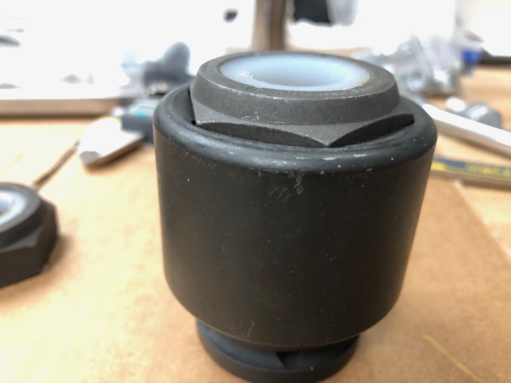

When buttoning up the rear suspension, I discovered an interesting problem with the axle nuts.  These are handed with left-hand threads on the driver's side and normal, right-hand threads on the passenger side.  The bottom of both nuts were 41mm, but the top of each was larger and required a 42mm socket to engage the full height of the nut.  The delta between top and bottom was larger on the driver's-side nut and this difference was visible to the naked eye.  Not a problem per se, but I don’t' recall seeing this in the past with any nuts.  Once a 42mm socket arrived, they went on without issue.  The photo below shows the driver's side nut dropped into a 41mm socket, with the greater than 41mm portion sitting above the surface.

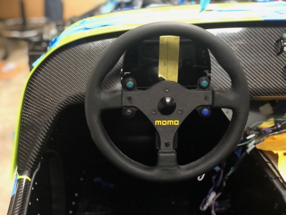

Like on my Westfield, some of the electronics are controlled by switches on the steering wheel.   However, unlike the Westfield where these switches are hardwired with a coiled cord running from the steering wheel hub to the back of the dash, for the Caterham I'm using the Freewheel kit which is wireless and has some PDM control.  Green buttons are turn signals which self-cancel based on an adjustable timer and pressing them concurrently triggers the hazards.  The blue button toggles between high and low beams when the dash mounted headlight switch is on or operates as a flash-to-pass button when that switch is off.  The small black button will either be used to control the resettable trip odometer or single wipe functionality.  The single wipe function is more interesting but will be seldomly used, whereas the trip odometer is used every time I fill up the tank.  With the AiM, you either need to go through a few menus to reset it or install a dedicated shortcut button.  Since I want that one push experience, it's either add it to the dash or the wheel.  The large black button in the center is the horn.  I'm having the Caterham 7 logo laser engraved on it which will make it look more intentional.  Although I'm using this same switch on the Westfield, the steering wheel spokes on that car are true black, unlike the very dark gray of the Momo, so the button doesn’t stand out to the same degree.  Hopefully the logo makes it visually more interesting.
My initial plan was to make the switch holder plate out of aluminum, but I went down the rabbit hole of drawing it in CAD and 3D printing a mockup to visualize it and play with button locations to ensure they are comfortable for me to operate.  I then realized 3D printing gives me additional flexibility for wire management as I can print in channels to hold the wires then small cover plates to hide them from view.  The final version will be printed with more care and should look good in the carbon fiber nylon used elsewhere on the car.  I'll post pictures of the wire management later.

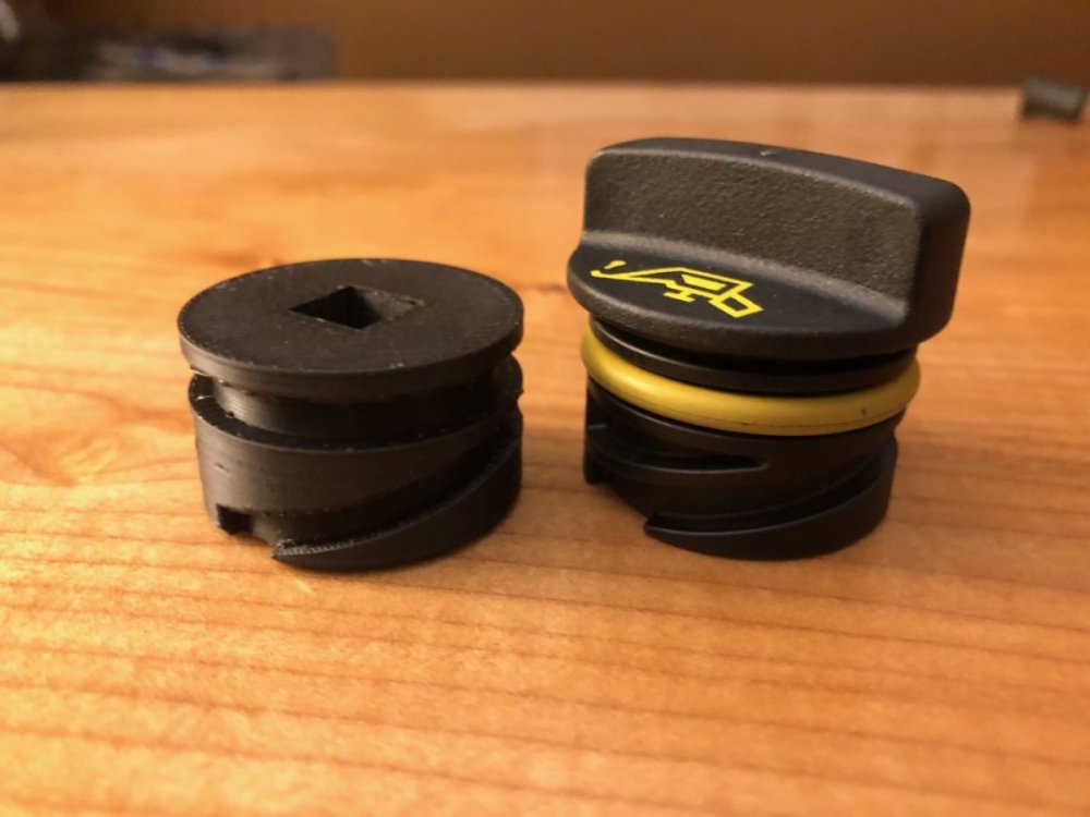

Lastly, I played around with making a low-profile oil filler cap.  The rough mockup works surprising well.  I need to make a very minor tweak then print it with finer resolution settings out of the carbon fiber nylon, but I think this is the direction I'll go.  Although I'm not a fan of an oil filler cap that requires a tool, the square shape is sized to fit a 3/8" driver.  Since I always carry tools with me, I will always have one of those in the car.  I may also print up a small tool that I mount under the bonnet to make it even more convenient.

Third Brake lights looks great. I have been trying to think about how to do this on my yet to be built or delivered 420. How did you drill into the roll bar? Just a punch or did you vice something to the bar itself (Likely overthinking a lot of this). And you just wired into the existing brake light harness by the right rear wheel? Any issues with the light and weather gear clearance/visibility or interior reflections - not sure how much night rain driving you plan on doing. I was thinking of including a switch on that electrical run to disable it in the very of chance I would not want it to illuminate. Again, over thinking everything

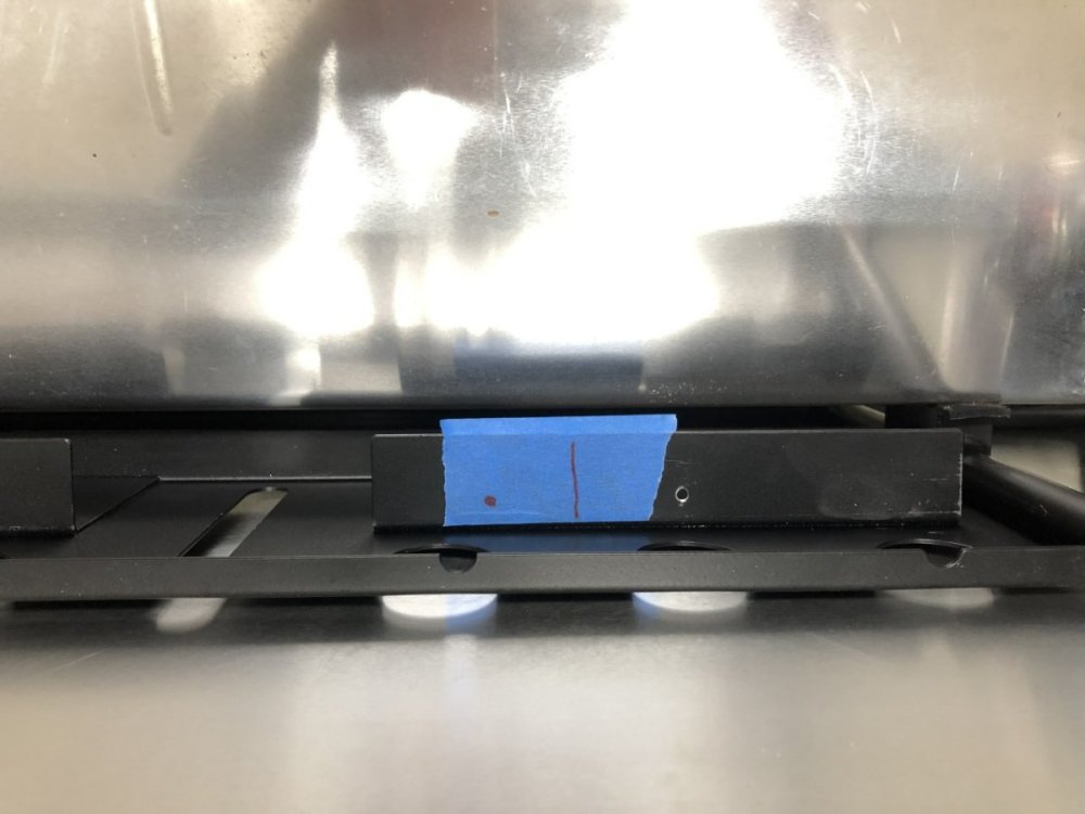

I did the following:
  • Blue tape on the rollbar where the mount would go, then put a level on the rollbar, and clamped the mount in place when the level on that part was the same as the rollbar.
  • Marked the holes with a pencil, removed the mount and punched the center of one hole.  Drilled that hole (it's for an M5 screw as I recall), and tapped it.
  • Put the mount back on with one screw, used the level again to ensure the other hole was still properly marked with that one side already fixed and repeated the drilling and tapping process for the second screw.
Bruce and Caterham sell a sub loom that inserts between the rear light connectors.  However, I've have read that a dedicated wire may already be in place for this on current cars.  I haven't checked yet as I haven't completed the final wiring which will include a Backoff module that flashes the 3rd brake light a few times on initial brake application.  I have something similar on the Westfield; based on experience, it definitely gets people's attention.  I need to tie up some things before adding the battery and energizing the system to check the connections and complete that work.
I was told this brake light assembly fits with the hood in place but haven't confirmed if that's true.  If not, I'll deal with it.  I don't anticipate ever using the full hood as I much prefer a halfhood and those can be made to accommodate a light in that area.
