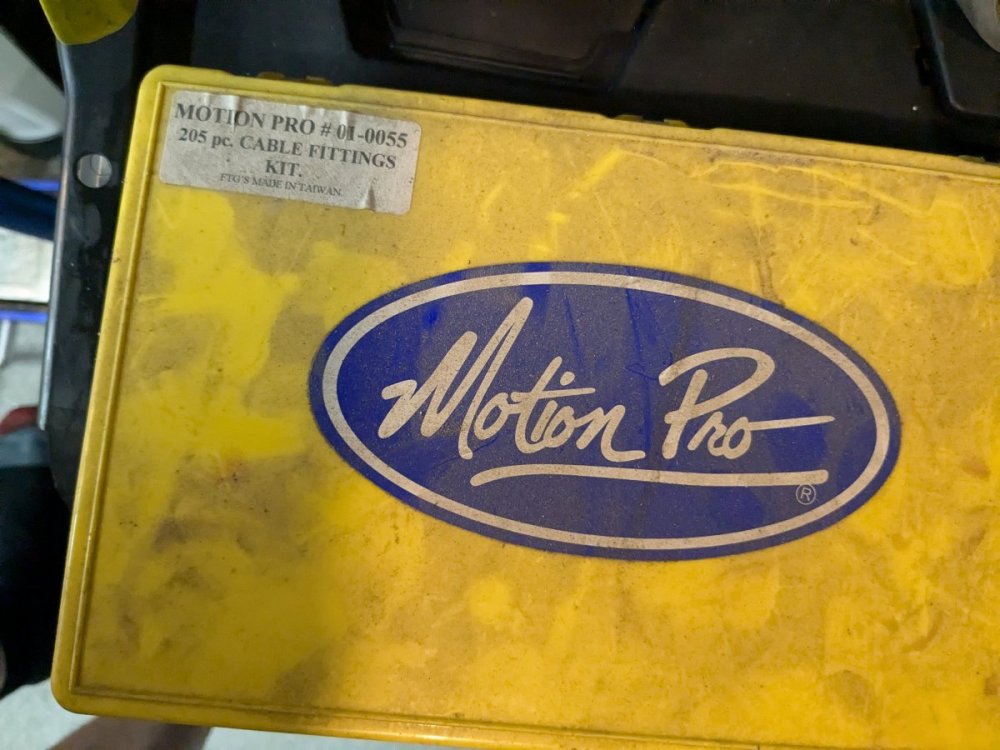

fastg Posted July 4, 2024 Posted July 4, 2024 See if you can find an old time motorcycle shop in your area. Most will have a kit to make cables. Graham
