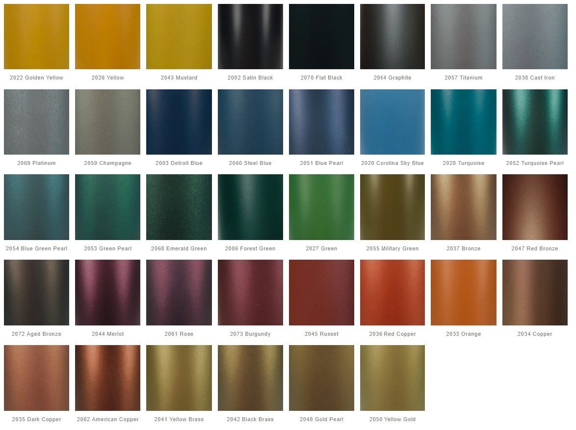

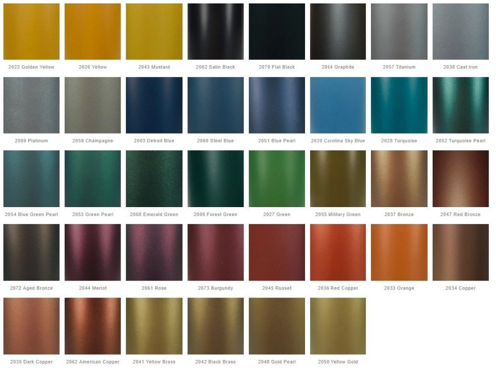

What do you guys think about ceramic coating the Header and Exhaust (by Jet-Hot)? Objective is to reduce the heat. Will it help? Any long term negative effects?
If it's good to do, thoughts on the color? Here are the possible color options:
I'm thinking 'Red Copper', as opposed to boring 'Satin Black' or 'Flat Black'. But, will 'Red Copper' clash with Exocet Red exterior? Or, 'White'? It'll match the Rollcage.

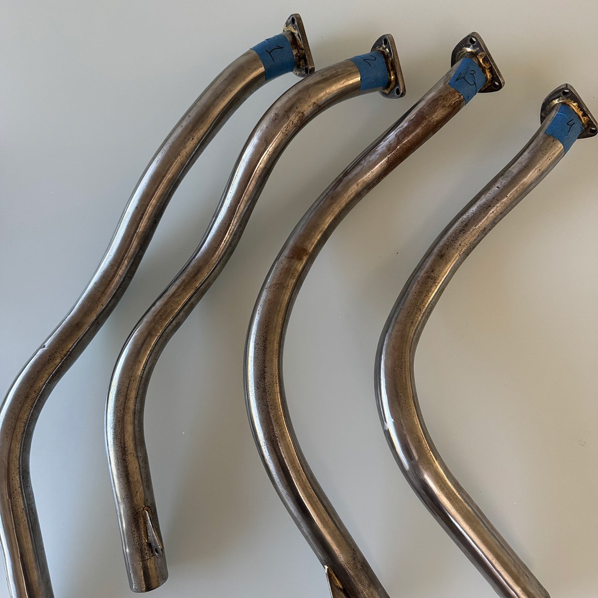

If you're applying this coating to a used system, you'll want to spend lots of time on prepping the parts. Jet-Hot does not do that for you. If you have surface rust and want a clean finish, spend the effort to clean it up because although it covers the rust, it doesn't smooth it. The finish is thinner than I expected.
I don't know if the underbonnet temps have really improved, but the finish looks very good and there is zero rust or discoloration.
Photo 1 shows you what I started with.
Photo 2 shows you the prep work removing all the surface rust.

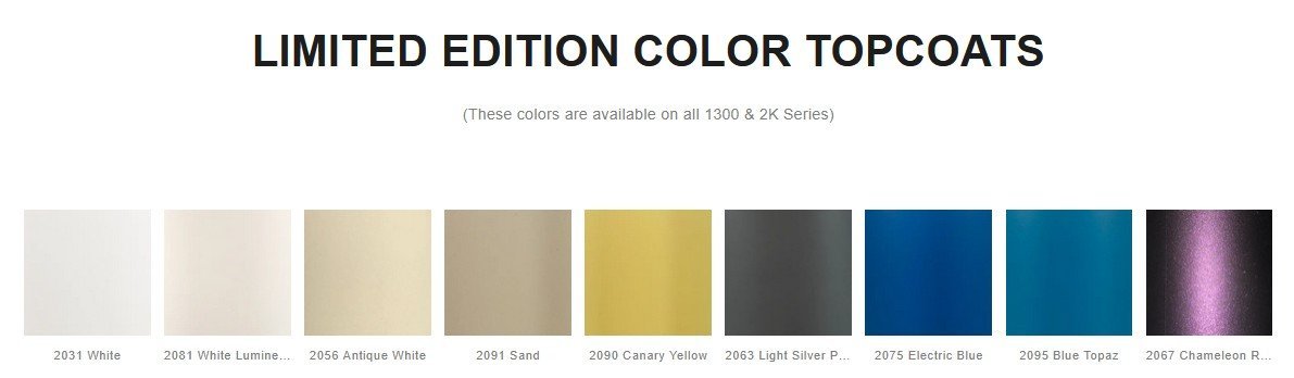

Photo 3 is the result from Jet-Hot.

Also, on color, it’s white or black. Everything else would just look like they couldn’t match your paint IMHO.

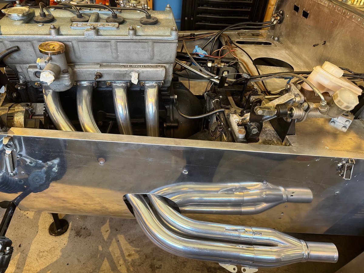

I wrapped the Jet-Hot coated headers on my Lister over 10 years ago.  No problem with moisture retention with the titanium wrap as it does not absorb water.  Also, with a surface temp of just over 600F, water does not stay in the wrap for very long!
Here is a shot of the headers with the wrap after 10+ years of use:
468309137_27961537950104012_6586540074857720039_n.thumb.jpg.5d1cf9ea8bf7c60bde0138d52c3670bb.jpg
Wow, I can’t believe you’ve kept a 10 year old engine that clean!! Looks amazing.
Diverting slightly from the main topic -- I was reading up on the titanium wrap and it says that it loses its flexibility after heat cycling. Has anyone ever tried removing the material? It sounds like it might be a tad messy or difficult.
I had to remove it from the collectors to pull the side pipes and it came right off.  I re-used it and re-wrapped the collectors with the same material.  Didn't seem to be an issue, at least in my experience.
