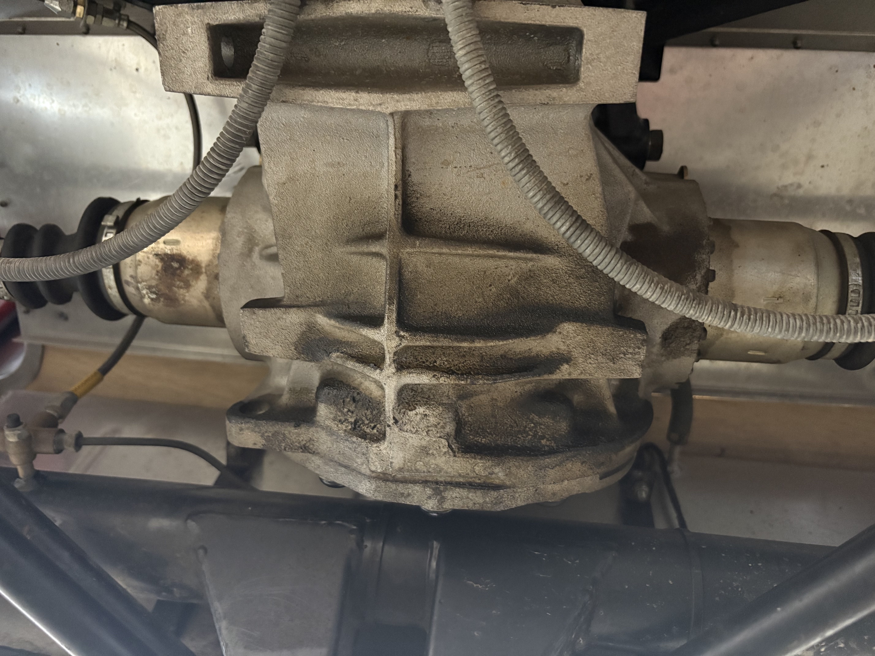

Origin7 Posted September 3 Posted September 3 I’m hoping someone can help me pinpoint the root cause of a clunking noise that seems to be coming from the rear universal joint or differential. When there is a load on the drivetrain, the noise goes away, but it always comes back when I’m barely tipped into the throttle. I tried greasing the universal joints, but there was no improvement. I also checked the driveshaft for play, and everything seemed okay. Half-shafts seemed alright too. When I first got the car, it made a loud clunk when I released the clutch. I found that the bottom differential mounting bolts had loosened and backed out. It looked like they had been loose for quite a while. I tightened them, and that particular clunk went away, but this other noise started afterward. I’m wondering whether all that movement damaged the pinion bearing. The noise also changes as the car warms up, which makes me think it may be bearing-related. Hoping to determine what it is before I go through the trouble of dropping the diff. Has anyone else had a pinion bearing fail? If so, did you experience similar symptoms?

Origin7 Posted September 6 Author Posted September 6 I went through the suspension. No obvious culprits, but I did snug up a few things. I took the car for a drive, and the noise persists. I didn't describe it well before. It's rotational-sounding, almost a rattling, when under very light throttle. The frequency of the rattling increases with speed. Basically it sounds like a bad U-joint. I've also heard a similar sound when the center support bearing on a drive shaft failed. I suppose it's time to drop the drive shaft and take a closer look at the U-joint and pinion bearing.

Origin7 Posted September 7 Author Posted September 7 I dug in a bit deeper this morning. Again, the U-joints look OK, and I’m not seeing any play in them. As I rock the driveshaft back and forth, I’m getting some backlash in the differential pinion gear, which sounds similar to what I’m hearing while driving. It also looks like the pinion shaft may be rocking side to side, but it’s hard to tell in such cramped quarters. Long story short, it’s looking like the differential is the problem. What’s the best source for a Ford Sierra 3.92:1 differential here in the U.S.? Would I be better off having mine rebuilt? I’ve also been reading about the Quaife ATB internals. Is that upgrade worth it?
