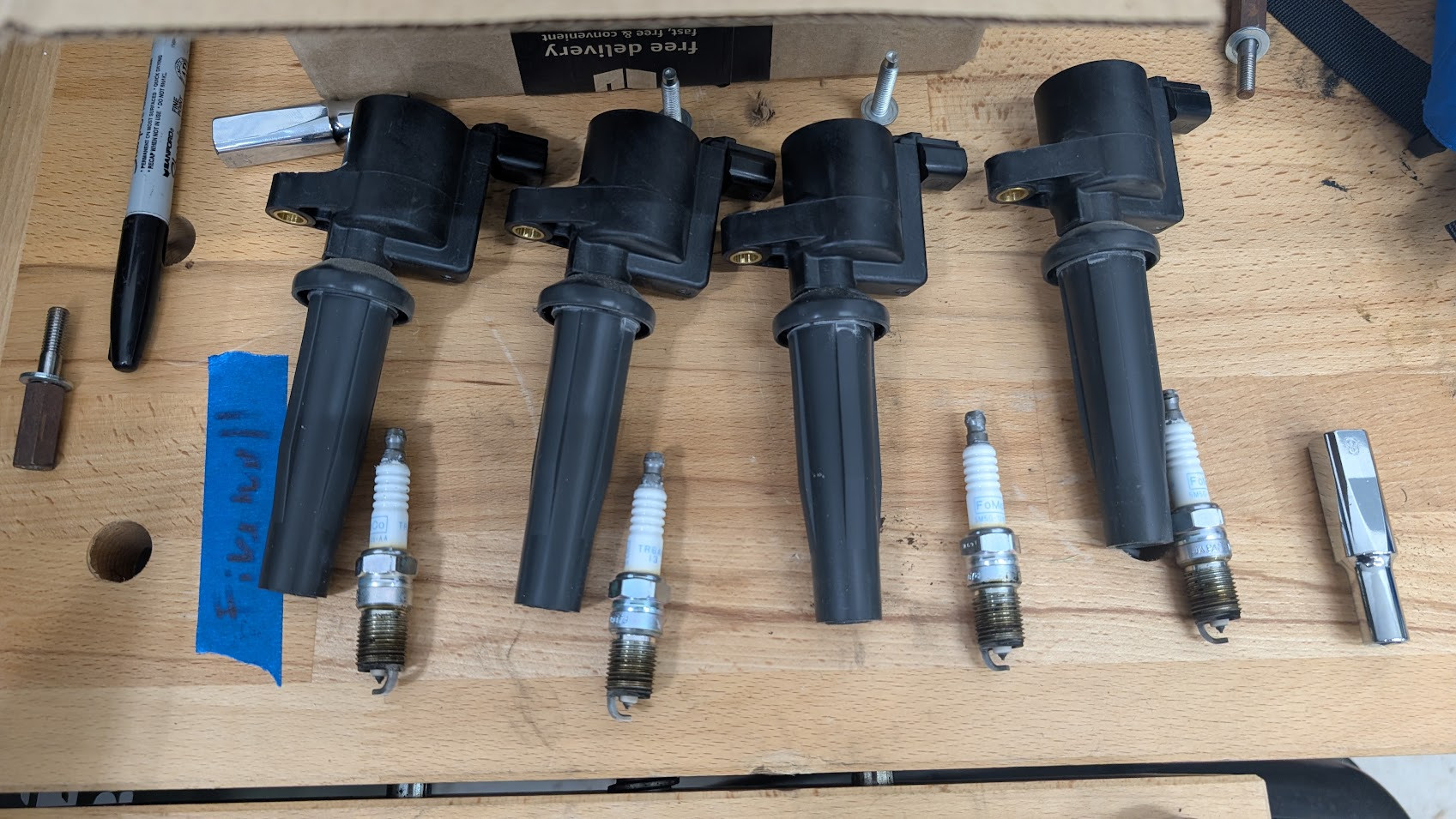

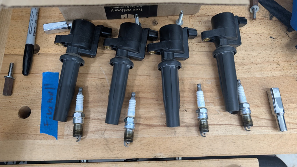

I purchased a single new coil and swapped it into each cylinder, and nothing changed.
So I thought maybe it could be multiple bad coils, so I swapped in 4 new ones and did 4 new spark plugs at the same time.
That made no difference.

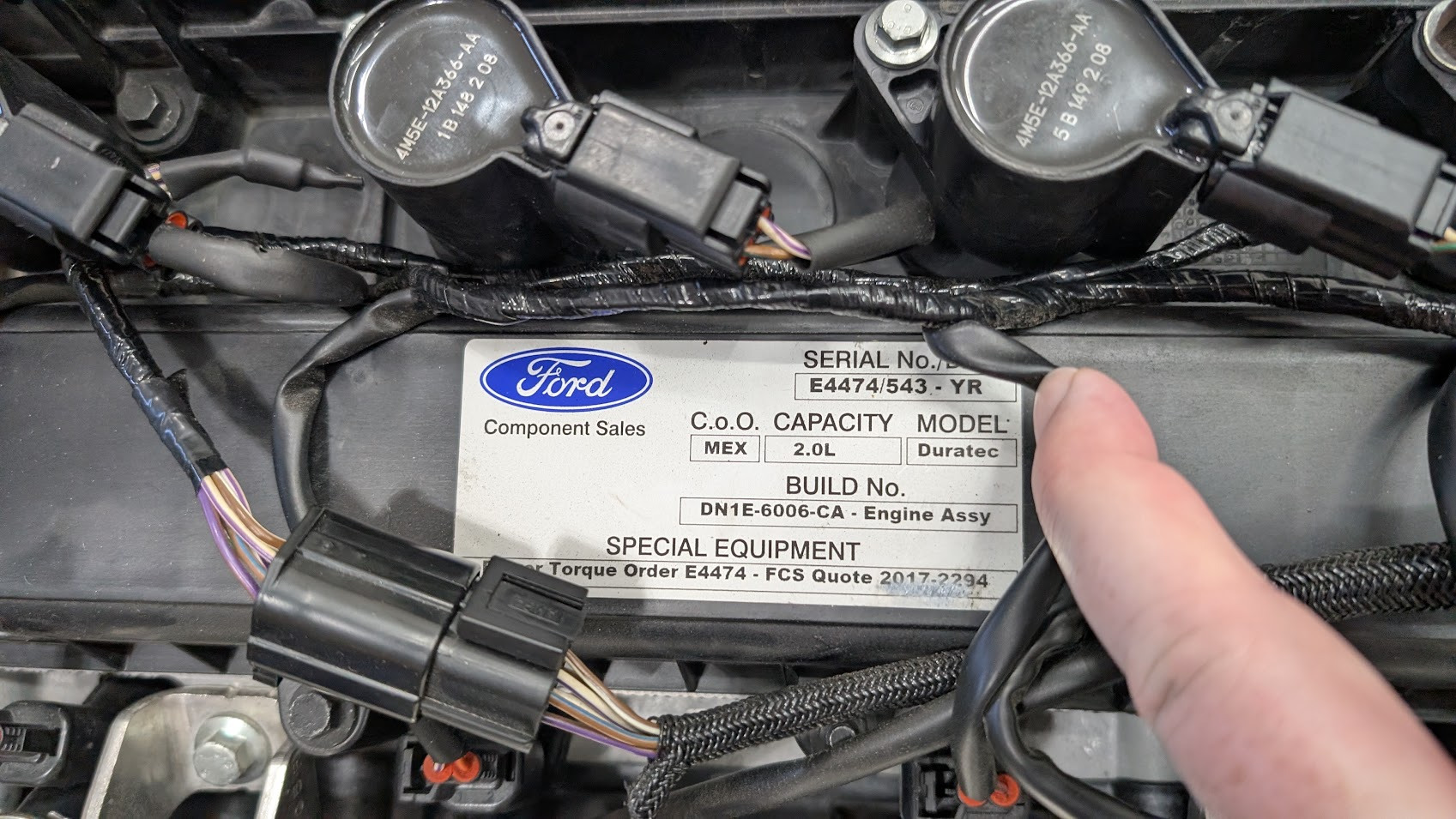

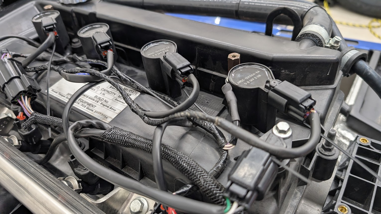

The harness for the coils is a known issue, and it behaves like you're describing when a wire develops a fracture. I'd start there. You might be able to find the offending wire(s) with a multimeter and some luck recreating the conditions or simply treat it like a wear item and replace it. Rocky Mountain or Beachman Racing might have one in stock.
Hmmmm….you have followed the basic diagnosis approach I would take.  John’s suggestion is the next one I would try.

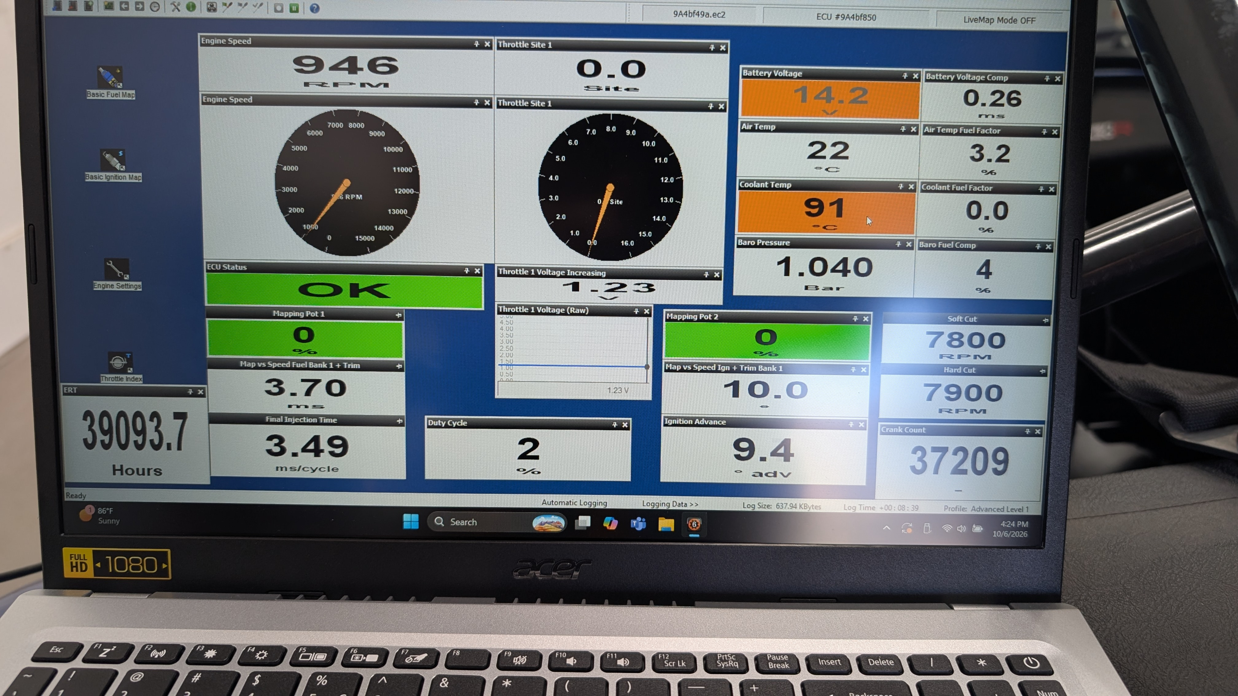

Oh shoot, no, I didn't try that, I will see what Easimap says tonight, thanks for the tip!
In the mean time I have a loom on order as well.
@jeffs I just checked and the temp seems good. Ecu matches the gauge. Thanks for the idea though!

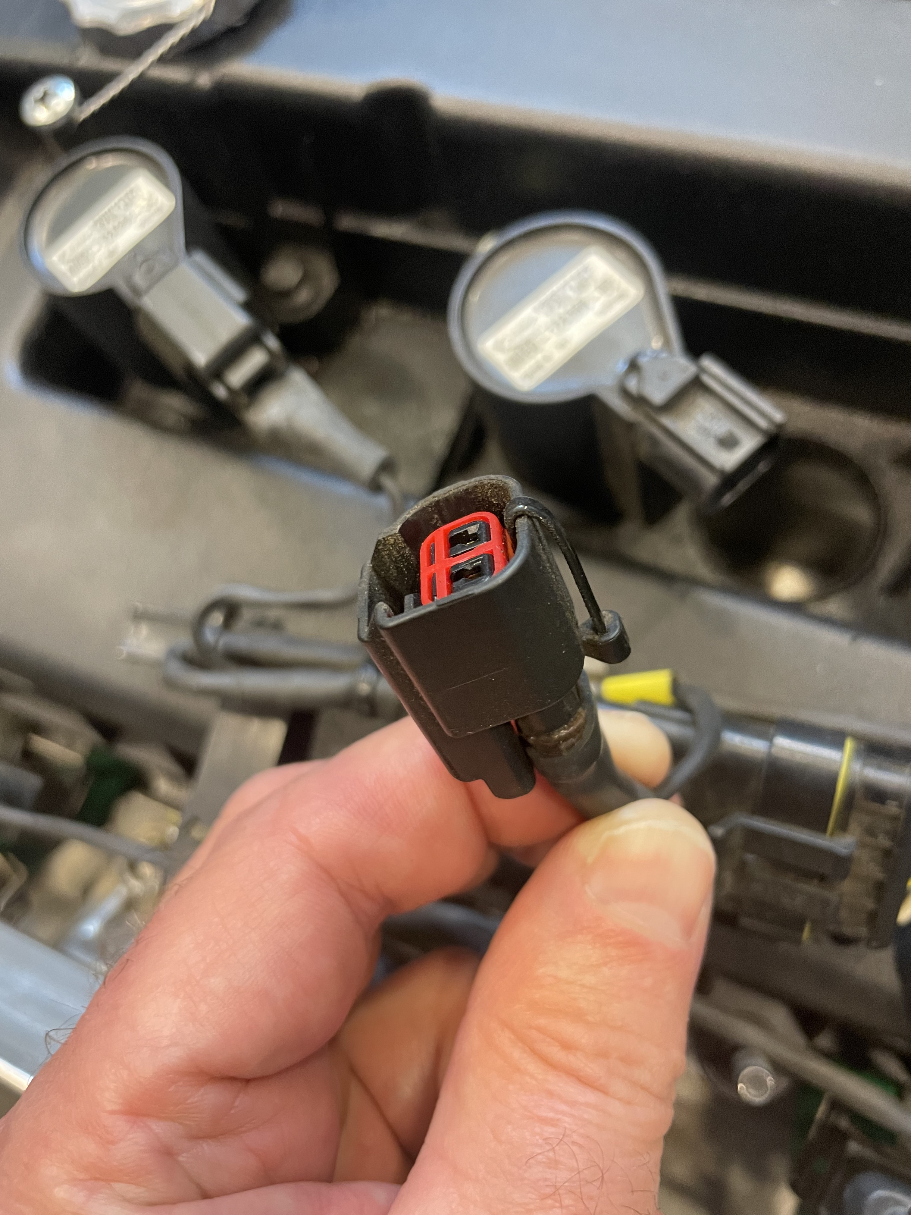

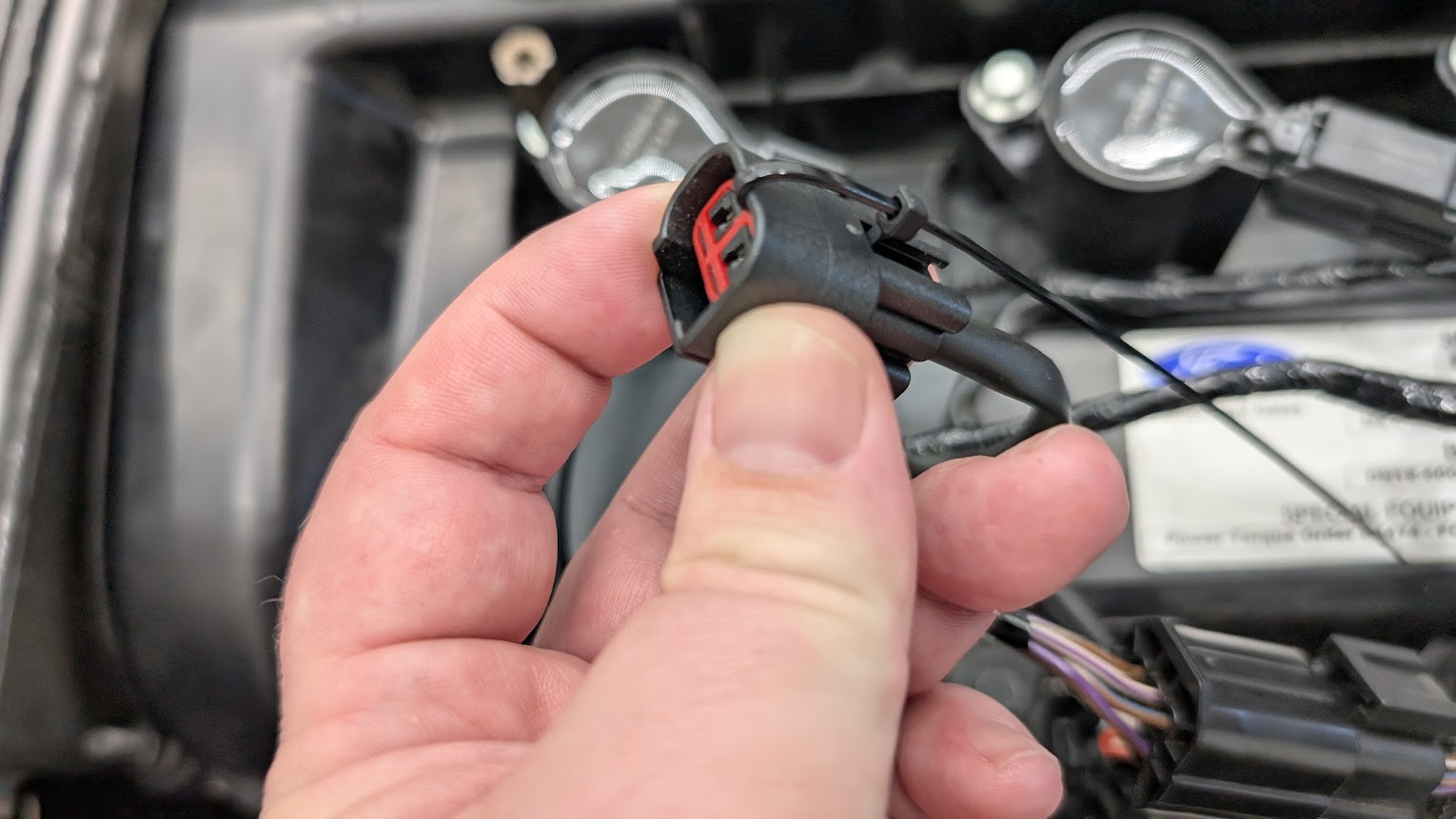

The connector standard at the coil is problematic. With time/heat/vibration, even though the connector is "locked" on the coil, enough play can develop to cause an intermittent connection at times. For this reason, Cosworth calls for the insertion of a small zip-tie to be installed through the connector on the loom end of the coil interface.
Not saying this is the root cause, but this mod is on every CSR engine that came out of Cosworth, and we use the mod with any and all track-prepared Caterhams.
Cheers,
-Bruce
Cheers,
-Bruce
Huh that's interesting!  I'll give it a go this week and see if anything changes.  Thanks for the tip!
Welp, I tried the zip ties, thanks for the suggestion @BruceBe.  Unfortunately no joy, same issue. I'll have to wait for the loom to show up.
