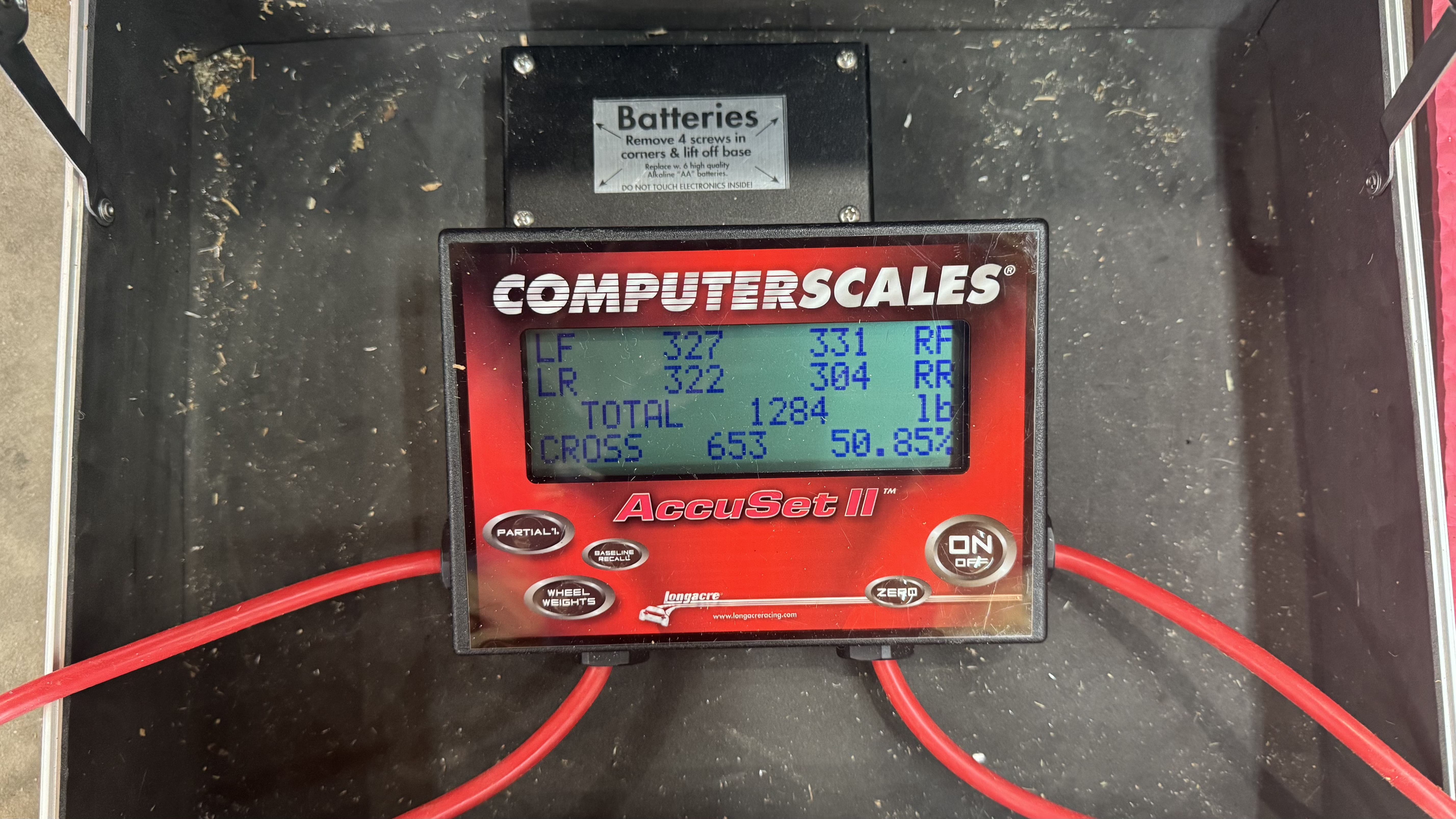

  2. If Road America’s carousel is the bar, then I’ll be fine. I don’t plan on taking the Cat to a big track like that. One of the local Caterham peers lent me his spare set of Apollos to test fit and measure clearances. It’s scary. 2.5” of ground clearance at the lowest point of the oil pan with Apollos and well worn Avon ZZRs. I may still get a set, but it may only be a track setup as it will certainly hit things around here. As far as fitment, the rear section of the exhaust is in the way. I’ve been wanting a side exit anyways, so this is a good excuse: I also re-weighted the car on this setup since I had added the lights and passenger seat. This is with 1/4 tank of fuel and 13s. The front 185/55/13 Avon ZZRs on Apollos are 22.6lbs, and the rear 215/55/13 are 27.6lbs. The 15” Caterham wheels with Toyo R888R 195/50/15 weigh 31.2lbs each. Huge difference, but is it worth risking an oil pan for it…

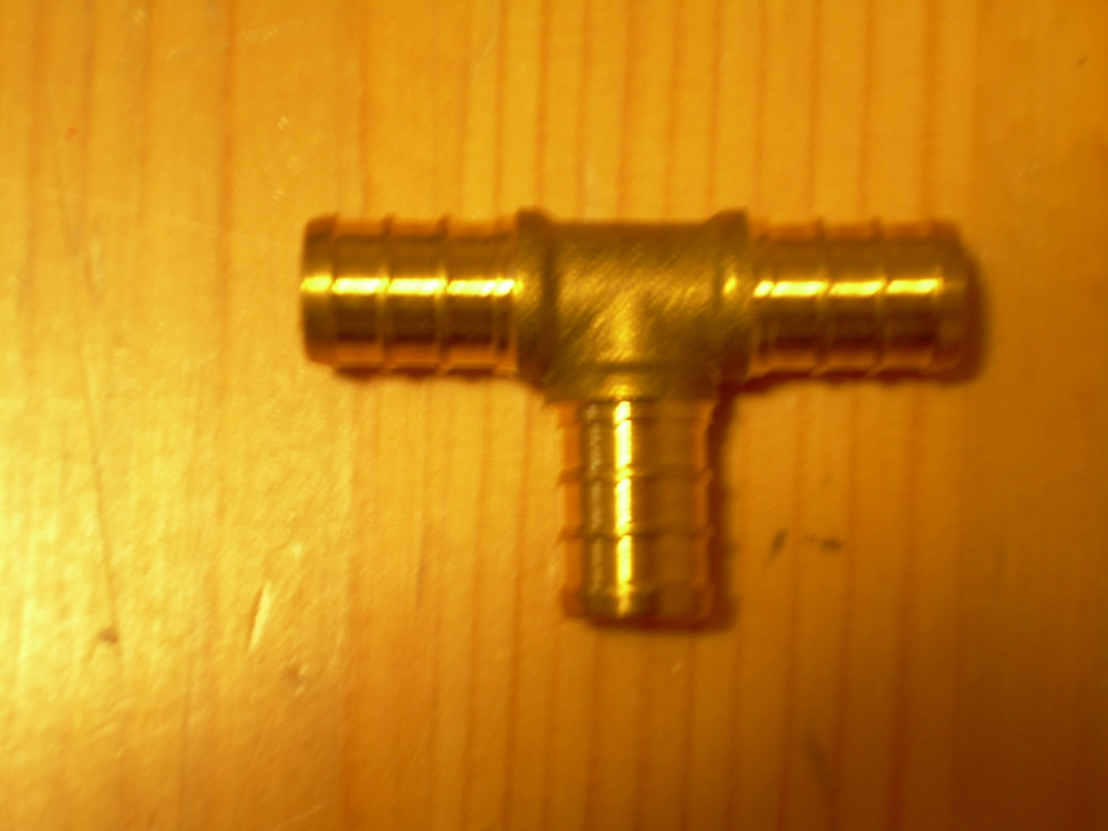

  3. Hi @jmaz. Glad you have found what you were looking for. Apologies for lousy photo, but if the Gates 'T' piece doesn't work, the photo showing the Pex 'T' may be better? I have shown 1/2", but 3/4" the same. I totally agree with Scott that brass would be a better choice, the barbs will probably hold better, and the brass looks nicer. Cheers W.

  11. Whoa! Ventilated diskies! I likey! Hey, wheres the pedal box and master cylinders? Cat has been up to something...what kind of pedal adjustment do we have?
  12. I would do brass barb fittings. The rule for 7s is everything shakes loose. Or something vibrates and cuts into something. The part may say " for Automotive use". This means it's resistance to heat, fluids and maybe oils, are within typical automotive variables. But 7s are outside of those parameters. I would avoid plastic if possible. Double clamp but don't double the clamping force. Ensure the hoses are tolerant of the coolant used. Test the pressure cap before relying on it. Assume nothing.

  18. Thanks for that kind offer and suggestion re. the pex version. I'd gotten another recommendation for the Gates 28635 T-piece (from Josh Robbins at Rocky Mountain Caterham), so I've ordered one for around $8.00 from Amazon. It seems like one of those strange ways in which Caterham does things, where they could easily and cheaply upgrade a part but choose not to.

  26. Took the r400 out for a drive as I've been playing with reducing cockpit turbulence...this is for the road but I'm often at the 60/75 mph level due to location. I hate losing ball caps :). I have the larger wind wings but have cut them down topside to properly clear the half hood...the half hood is on all summer due to our heat. the ambient temp when I went out was 100 F. The hood makes a great dif without direct sun. I put a Lexan piece..9"x36" (shaped) across the rear bar.... I find this works well with the hood... not so effective without but no worse either. It needs to be 1/4 in so as not to 'flap' when the hood is off. The other is how well the cooling system works....I was goosing it and running hard uphill at 60 to 80 mph and it barely got beyond 1 o'clock on the temp gauge and settled at the 180ish/12 if driving at a lesser rate. Strangely I found the footwell heat to be hardly noticeable...much less than the '98 HPC. Perhaps because the pipes are on the passenger side? No idea, but didn't notice that at all. I'll have to check with the doors on only and see if that rear window is an assist. Just an FYI. Love this thing.
