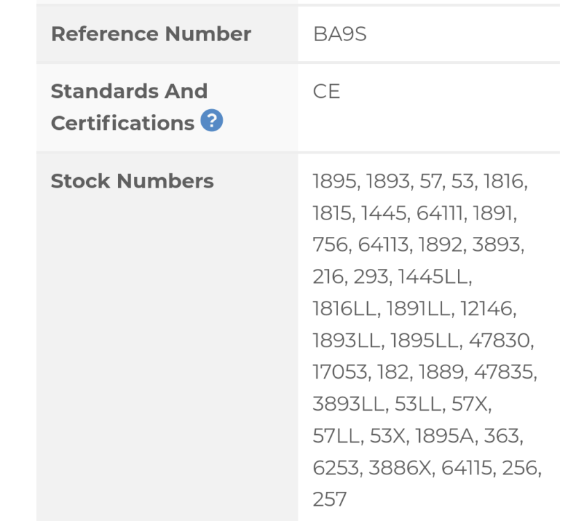

MV8 Posted May 21, 2023 Posted May 21, 2023 What was the issue with the gauge tubing? Can you post a pic of the bulb? That must not be a part number they use anymore. I would expect to see a ba9s base (9mm/0.355"od, 180 pins), 13-15v rating, short globe top, and around 3w for an incandescent replacement. Part number 57 is typical. Led replacements usually list a lot of bulb part numbers based on the bayonet base shape and bulb size. Different led placements are also available. It depends on where the light needs to shine. Incandescent s are not directional. 1
Vovchandr Posted May 21, 2023 Author Posted May 21, 2023 (edited) 7 minutes ago, MV8 said: What was the issue with the gauge tubing? Can you post a pic of the bulb? That must not be a part number they use anymore. I would expect to see a ba9s base (9mm/0.355"od, 180 pins), 13-15v rating, short globe top, and around 3w for an incandescent replacement. Part number 57 is typical. Led replacements usually list a lot of bulb part numbers based on the bayonet base shape and bulb size. Different led placements are also available. It depends on where the light needs to shine. Incandescent s are not directional. First gauge tubing kinked, when feeding. I realized I needed to straighten it before feeding next round so I used heatgun to get it a lot straighter. Regardless seems like a weak point to have oil running all the way into the cabin, but I need a means to an end to get a true reading so here I am. The light is k5632 but does cross to bulb you mention Edited May 21, 2023 by Vovchandr
MV8 Posted May 21, 2023 Posted May 21, 2023 I heat a large pot of water, then hold it above the bottom with a wire and watch it expand to the size of the pot, then hold it straight with clothes pins as it cools to room temp. As long as the tube is well protected, they last for decades. I've never had to replace one but I have replaced the tube because I nicked it. The tubes and hardware were about $10 last I checked. 1
MV8 Posted May 21, 2023 Posted May 21, 2023 All those part numbers don't actually interchange for brightness and glass size. You can compare on mcmaster.

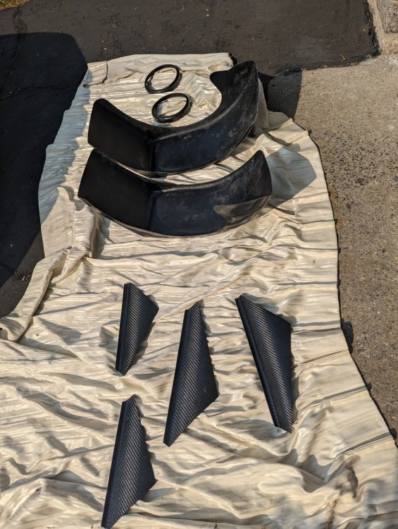

Vovchandr Posted May 23, 2023 Author Posted May 23, 2023 (edited) On 5/21/2023 at 2:59 PM, MV8 said: All those part numbers don't actually interchange for brightness and glass size. You can compare on mcmaster. Thanks. I'll look into that. Prepping all the carbon bits for Sika flex with Sika primer. CSR fenders, wishbones aero, CF headlight buckets rings. Couldn't figure out any good way to secure headlights in the CF bucket rings so just going to Sika them in there. Should work. Edited May 23, 2023 by Vovchandr

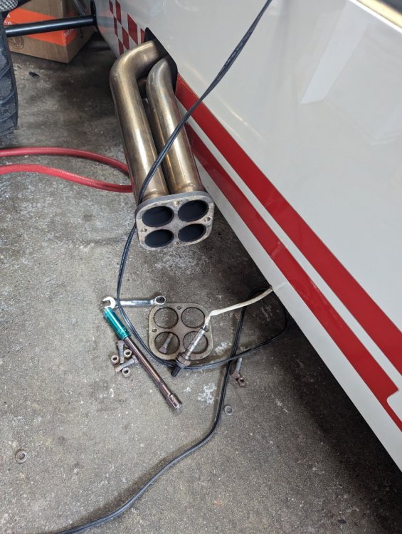

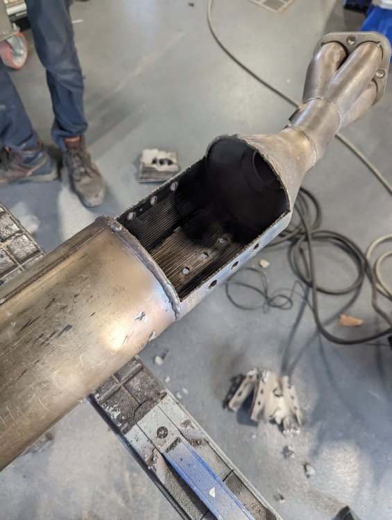

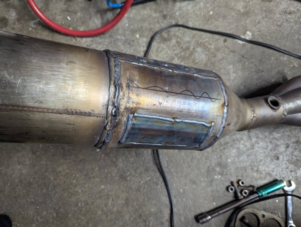

Vovchandr Posted May 23, 2023 Author Posted May 23, 2023 Cat 😺 is going bye bye this week. I think it's clogged worse than I even thought. The engine is struggling to crank over with the exhaust on while I'm trying to troubleshoot it and compression test it.
MV8 Posted May 24, 2023 Posted May 24, 2023 It looks like the defective catalyst is only accessible after cutting at the case weld. They are fragile; easily broken up to smaller pieces that can fall out. Dyno tuning can shorten the life and like 02 sensors, they don't last forever in a best case scenario.

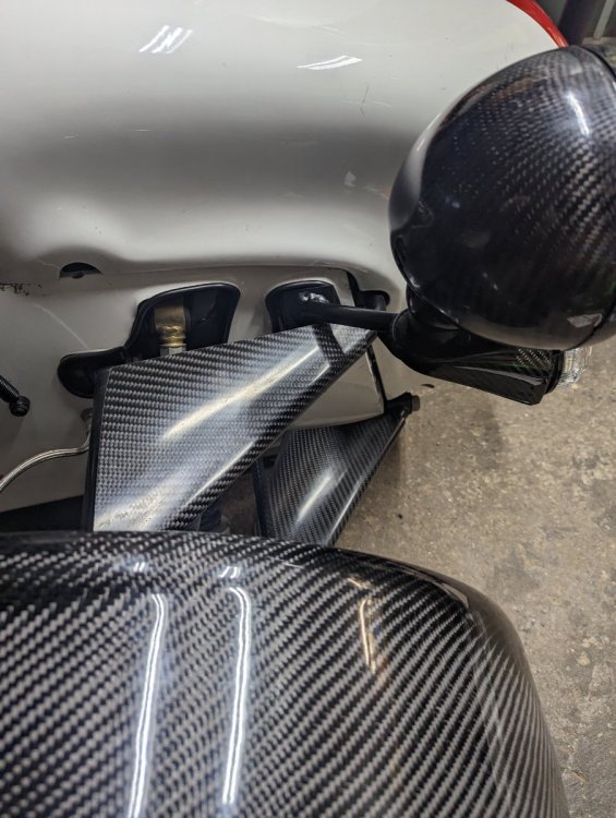

Vovchandr Posted June 3, 2023 Author Posted June 3, 2023 (edited) After years of accumulating parts, some of them are finally getting mounted Lower headlights (god what a horrible job. It would be easier to buy a newer 7 🙄) CF pods CF headlight buckets New Led blinkers CF Westermann Aero CF nosecone aero CF Westermann CSR fenders Still figuring out some mounting Also got to utilize econoseal plugs and tools and learn how to use them and used my aluminum (stupid expensive) anodized headlight through bolt hardware for the buckets. Reused the LED light but now it's semi permanently attached to the CF headlight ring with Sikaflex as I couldn't figure out an alternative good mounting method. The ring is attached to the bucket with double sided tape for now and the headlight cover.. Edited June 3, 2023 by Vovchandr 1

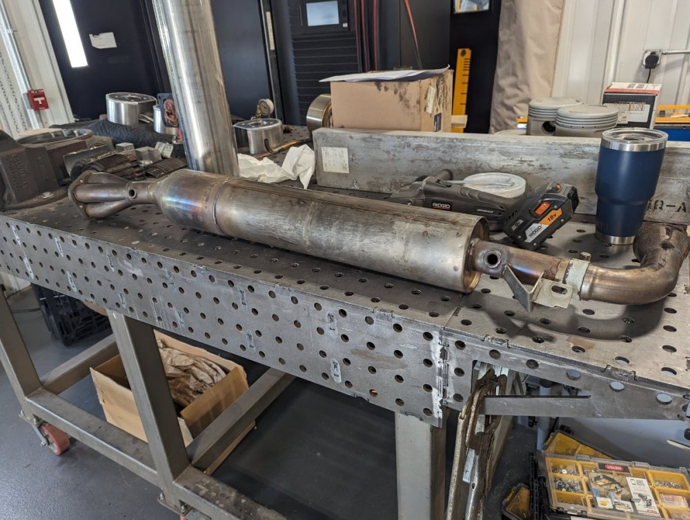

Vovchandr Posted June 4, 2023 Author Posted June 4, 2023 Started the car yesterday with all new ignition parts and now no catalytic converter. Still hard to start, still sounds like it fumbles around. Big backfire pop a few times upon startup now from intake ITB runners and or exhaust. Scared me a few times. Made progress on datalogging and got my first recorded dummy test log! @catsv7 Now have to figure out how to wire in the wideband to be added to logs and I might be in good shape soon for this. Since the battery for ancient laptop is NA, I got a small power inverter from Ridgid that works to power laptop on the move quite well! In meantime I'm leaking oil from both ends of the mechanical oil pressure gauge and will have to address that after cleaning up the spill on the driveway... I think the compression fittings have to go a lot tighter than I've tightened them to. On the pressure side of things, my pressure is about at 6 bars cold and about 3.5 warm which I'm happy with seeing as thats close to normal.
