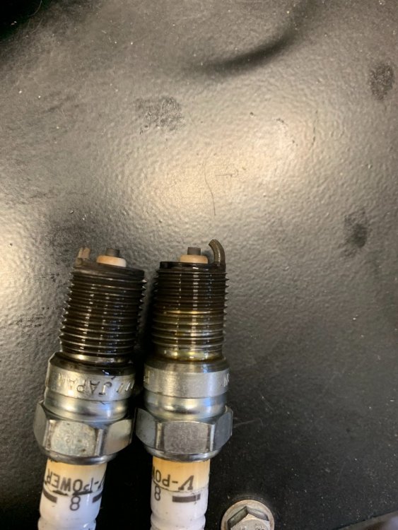

SK400 Posted November 22, 2021 Author Share Posted November 22, 2021 Thanks Tom. I think I ll give the Sunoco GT 100 a try. Here are some of the pictures. Grade 8 spark plug cathode melted after track day (Simon’s). I had the same happened to me with grade 7 and street driving. And grade 8 spark plug after 15 minutes of use. The ceramic is sparkling white. Link to comment Share on other sites More sharing options...

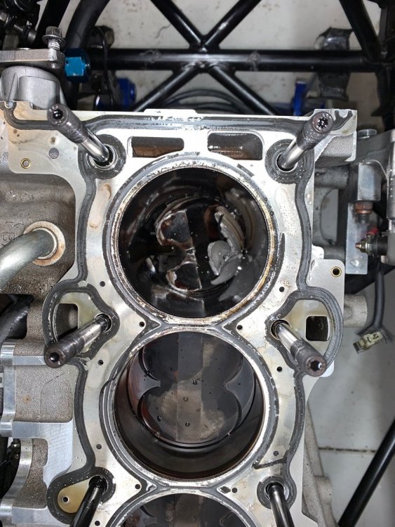

simon450 Posted November 22, 2021 Share Posted November 22, 2021 1 hour ago, Croc said: @simon450 Have you thought about pasting Seb's picture to your Tillet seat and sitting on it? Seb is not a religious icon you know. Well not in a good sense. Ive forgotten Seb’s exact thunderbolt lap time but I was at least -1sec so well worth sacrificing an engine. I think the piston will buff out and my son helpfully suggested I can seal the hole in the block with Flextape, the guy on the TV says it seals anything. Link to comment Share on other sites More sharing options...

speedwagon Posted November 22, 2021 Share Posted November 22, 2021 a word to the wise-- "wide-band" (air fuel meter) and if you wish to keep your engine, in the dash preferable. When leaned out at high power an engine will resort to burning aluminum. and quickly. At 14,000 feet, in the sprint to the finish, I lost 3 pistons in a Corvair engine with 30lbs on the manifold. It happened in less than a mile. Drove it down the hill, and when torn down the rings were still intact but you could see into the crankcase where half the pistons used to be. Besides a wide-band will make tuning easy even with a carburetor engine. john Link to comment Share on other sites More sharing options...

Dave W Posted November 23, 2021 Share Posted November 23, 2021 From the photos, you do not see any detonation on the two plugs. Which might mean the condition is for a very short period. Tip coloring indicates slightly less timing needed, back off 2 degrees. The single plug show very rich at idle and lean at WOT. The best indicator for WOT is at the base of the ceramic. You need a clean throttle chop, while de-clutching for a good plug read. Dave W Link to comment Share on other sites More sharing options...
