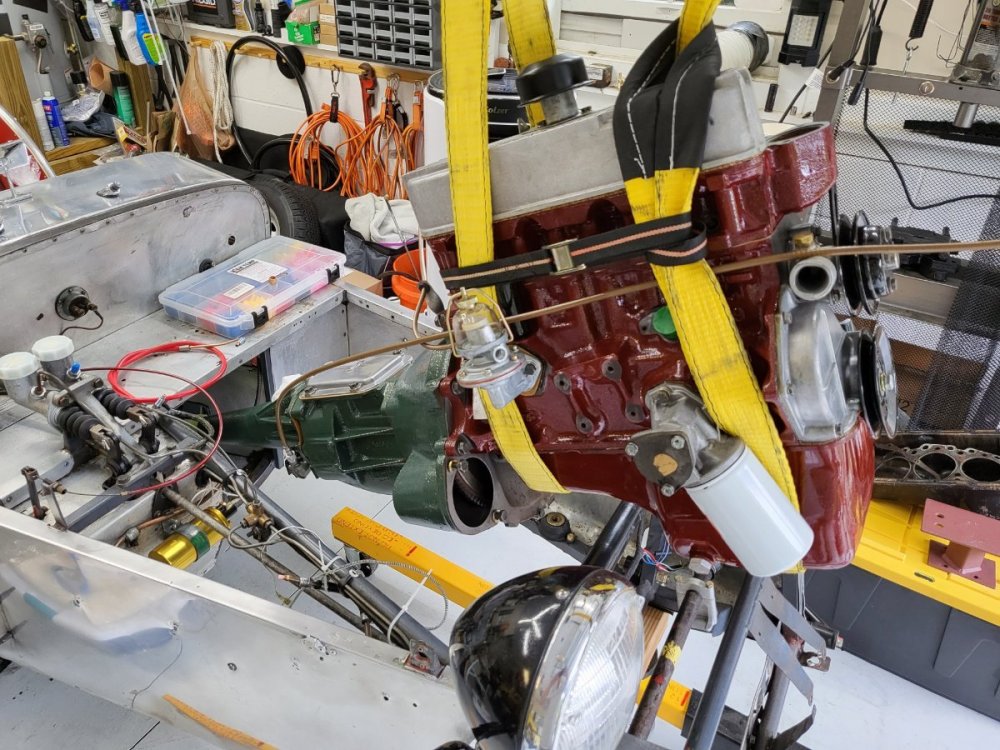

SENC Posted June 14, 2022 Posted June 14, 2022 This is the engine going back into my 65, I'd guess the necessary angle would be similar for yours. On thes older ones, the front brake lines run along the top chassis crossmember, and need protecting as the engine makes a close pass and can easily swing and damage. I use a piece of rubber hose spilt longways, or pipe insulation, to wrap around it.
