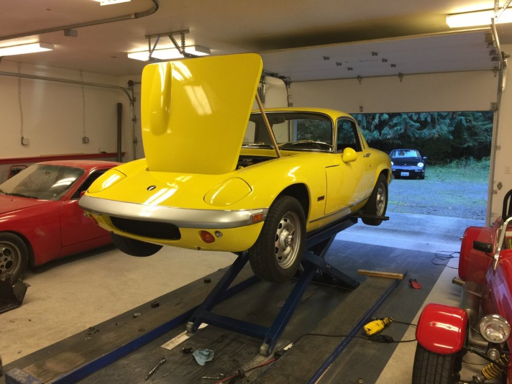

das76 Posted September 7, 2022 Posted September 7, 2022 I’ve been looking into lifts as well. Since a Cat isn’t big , or heavy, this looks like a good option for a small garage (no affiliation) https://www.advantagelifts.com/products/advantage-ml-2000-single-post

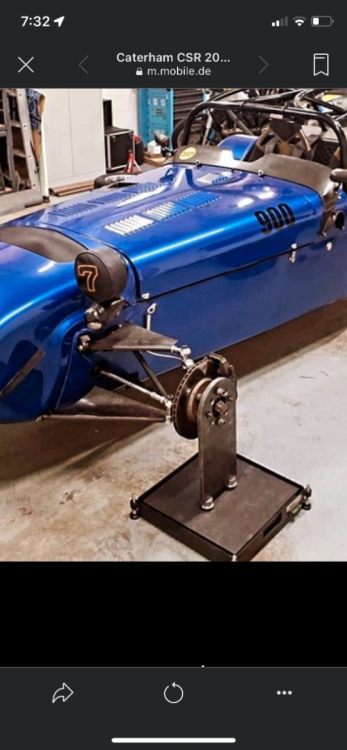

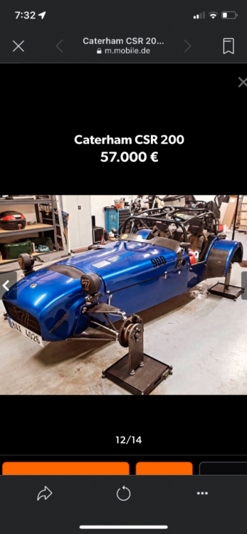

das76 Posted September 19, 2022 Posted September 19, 2022 So this isn’t technically a lift but this is looks like a pretty neat contraption. Has anyone seen these before or are they custom made ?
spitfun Posted September 19, 2022 Posted September 19, 2022 There are a few manufacturers of these in different forms.
IamScotticus Posted September 19, 2022 Posted September 19, 2022 (edited) I would use them for long term storage with wheels off. Or a long body project. But not for wrenching on. I would have all 4 stands connected. Edited September 19, 2022 by IamScotticus

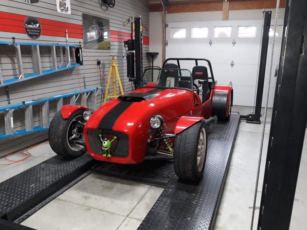

wdb Posted September 19, 2022 Posted September 19, 2022 I have a Challenger 9000 lb. 4-post lift. The Caterham looks dainty sitting on it. The rolling jacks won't clear the oil pan though so I need to be mindful. I wavered between 2-post and 4-post lifts when shopping for them but went with 4 posts because I would definitely be using it for storage and didn't like the idea of the car hanging there unsuspended for weeks/months at a time. There are some inconveniences when doing work on the cars but so far no show stoppers.

CarlB Posted September 21, 2022 Posted September 21, 2022 On 9/18/2022 at 10:35 PM, das76 said: So this isn’t technically a lift but this is looks like a pretty neat contraption. Has anyone seen these before or are they custom made ? These are for doing wheel alignments. The square part at the bottom is a scale (sold separately). The idea is you can eliminate any inaccuracy of the wheel, and access for making adjustments is easier. When you use string to set the toe you can use a bar that is longer than the diameter of the tire for a little more accuracy. To scale a car, you need to at least set the tire pressures. A better method is to measure and adjust the diameter of the tire. Wheel stands are already exactly the same height. Most pro racing teams use this method. The ones above called auto dollies are not the same thing. They are for moving the car around the shop.

wemtd Posted December 9, 2022 Author Posted December 9, 2022 Update… I ordered a 4post triumph lift: Sized for a se7en & most likely to fit my space. Then garage modifications ensued for vertical clearance. Naturally this became exponentially more complicated than anticipated. Now that that’s sorted I can’t even remember what repairs & adjustments the Se7en needed…
