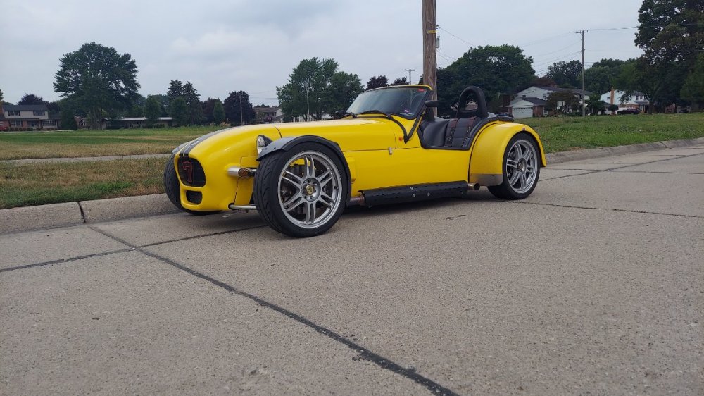

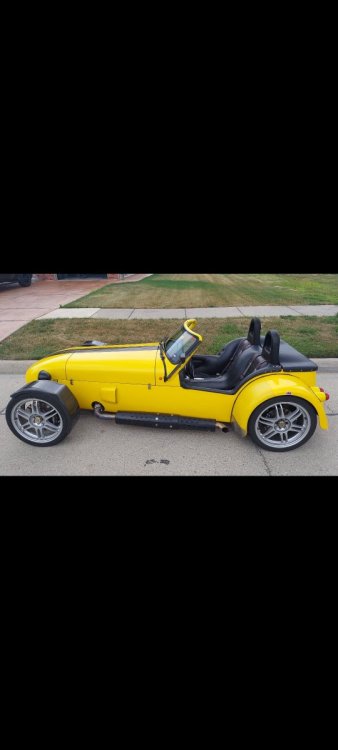

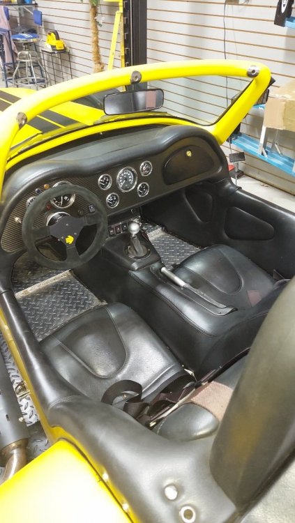

Alex-Ks1 Posted December 24, 2022 Share Posted December 24, 2022 Yes it's a tight squeeze getting in one , I have been giving this a lot of thought .I'm about to start another 7, this time with a 4L60 GM Automatic trans , this will make a lot of room in the toe box area , then widen the chassis by 4 inches , that's not even noticable when looking at it head on , then stretch it about 6 inches , from all sides with a cad program it still has all the looks and size as the original. Just a tad , more. . keeping the 4.3 V6 and the automatic trans will be enough power the new owner will ever need or want . I had to make my seats , did the frame in aluminum, and added slides on the driver side , covered in heavy padded vynol in black they ,, WORK . And feel good , right now my 7 is in a bag for the winter in my shop Link to comment Share on other sites More sharing options...
